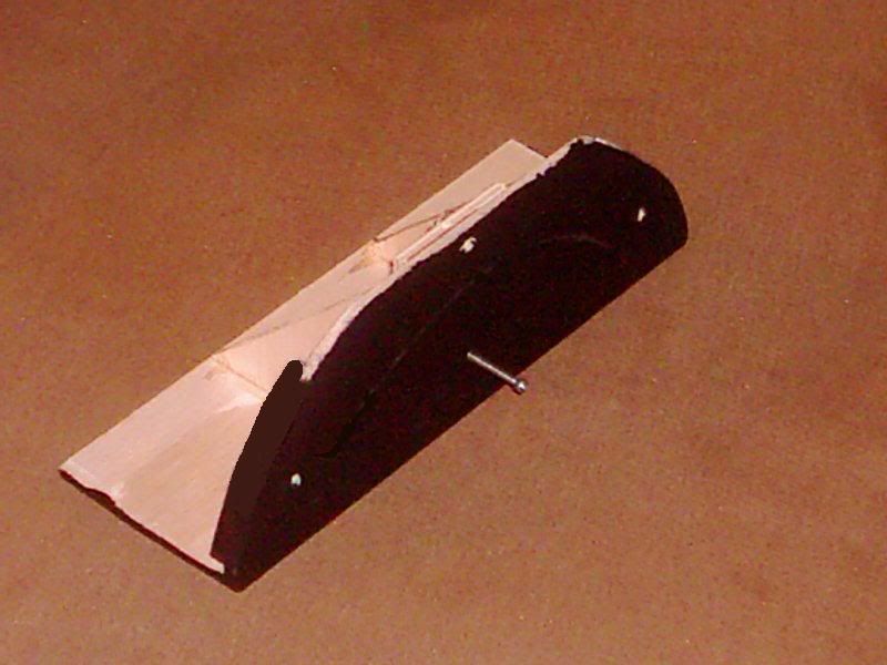

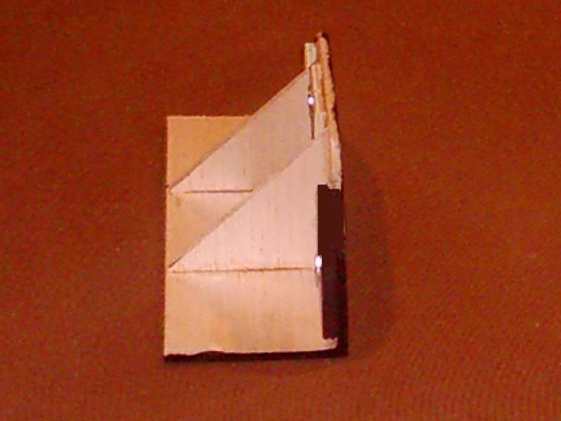

My top baffle:
Made it like the bottom baffle. ( balsa )
I installed three blind nuts in some ply on back side of baffle and one in the center ( tell you about the center one later ).
I lay the baffle on top of the engine till I get the cowl on and mounted.
I then screw a bolt in the center blind nut and use it as a handle to hold and pull the baffle in position.
I then put the three main holding bolts through the face of the cowl and into the blind nuts.
Unscrew the center bolt used as a handle , put it in you tool box.
Top baffle is held in place by three bolts through the face of the cowl.
Baffle fits as tight as bottom baffle and you never even see the little bolt hole of the center handle bolt.

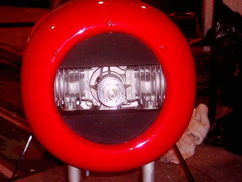

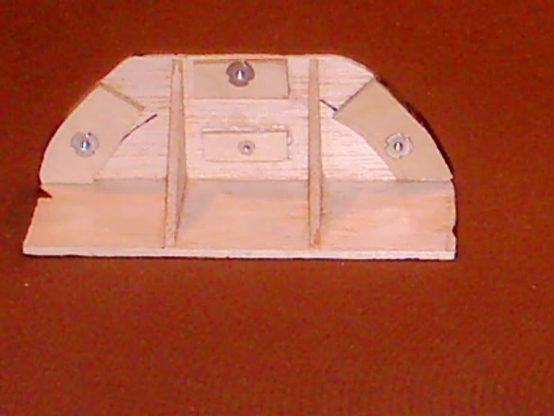

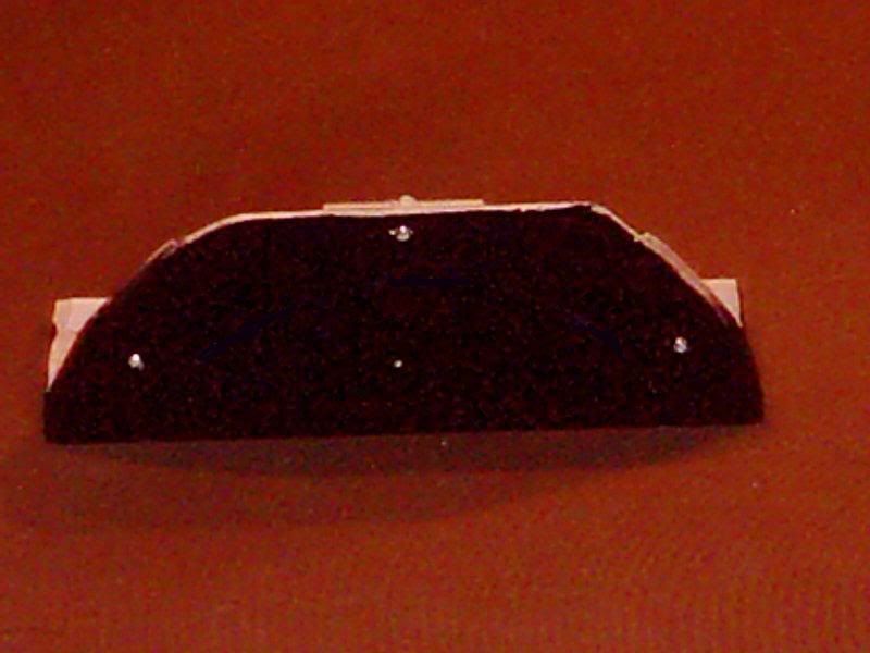

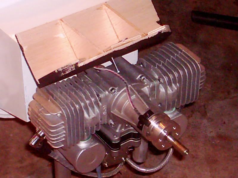

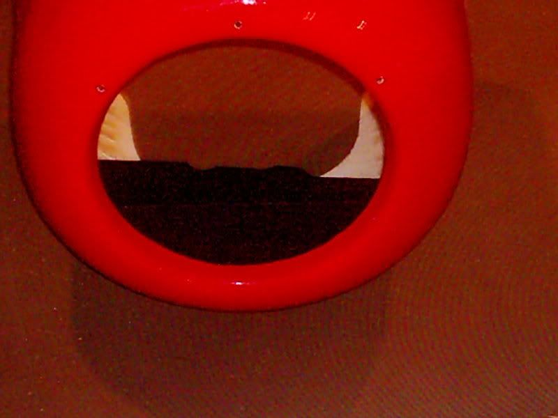

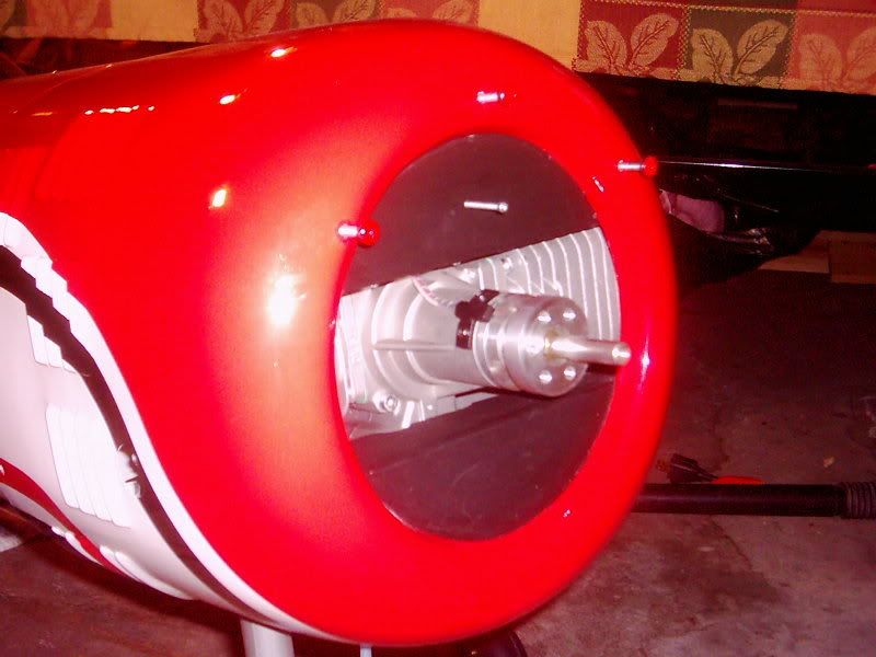

ORIGINAL: matfree
could you send some pics of your baffle??

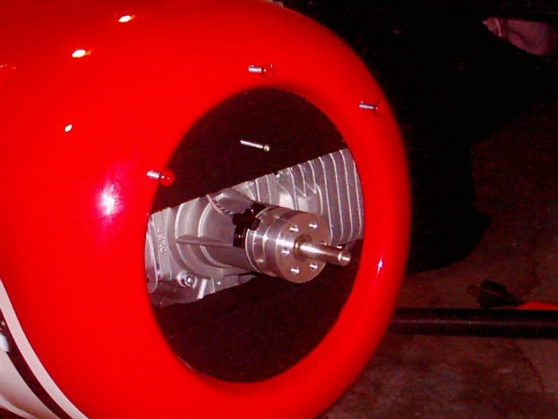

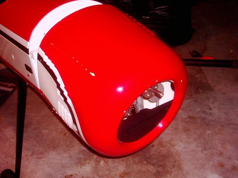

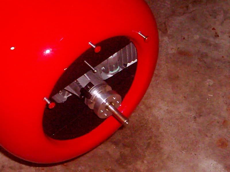

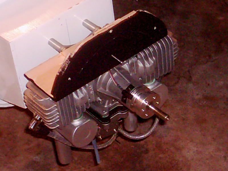

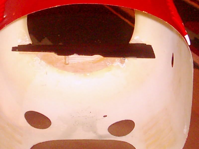

Here are some picture of the baffles.
Sorry for you guys that aren't interested, because there are some pictures.
But, hopefully this will help some others.
Also, I will take any suggestion of something different and different ideas.
This is my 1st time doing any baffles.
Bottom baffle is balsa and fiberglassed in place in the cowl.
This is construction of the top baffle.
Made of balsa with ply backers for blind nuts.
Three outer blind nuts are the mounting bolts, small blind nut in the center is just for handing/lining up the baffle for mounting.
This is the back side veiw.
Side veiw, top baffle.
Front veiw, top baffle.
Top baffle with handling screw in.
I lay the top baffle on top of the engine.
I then slip the cowl on and mount it.
Note the three holes drilled in the upper face of the cowl.
Use the center handle screw to move top baffle into position and use three mounting bolts to secure into postion.
I put o-rings behind the head of the mounting bolts and painted the head red to blend in with the cowl.
When installed the mounting bolts are hardly visable and then take out the small handing screw from the center.
