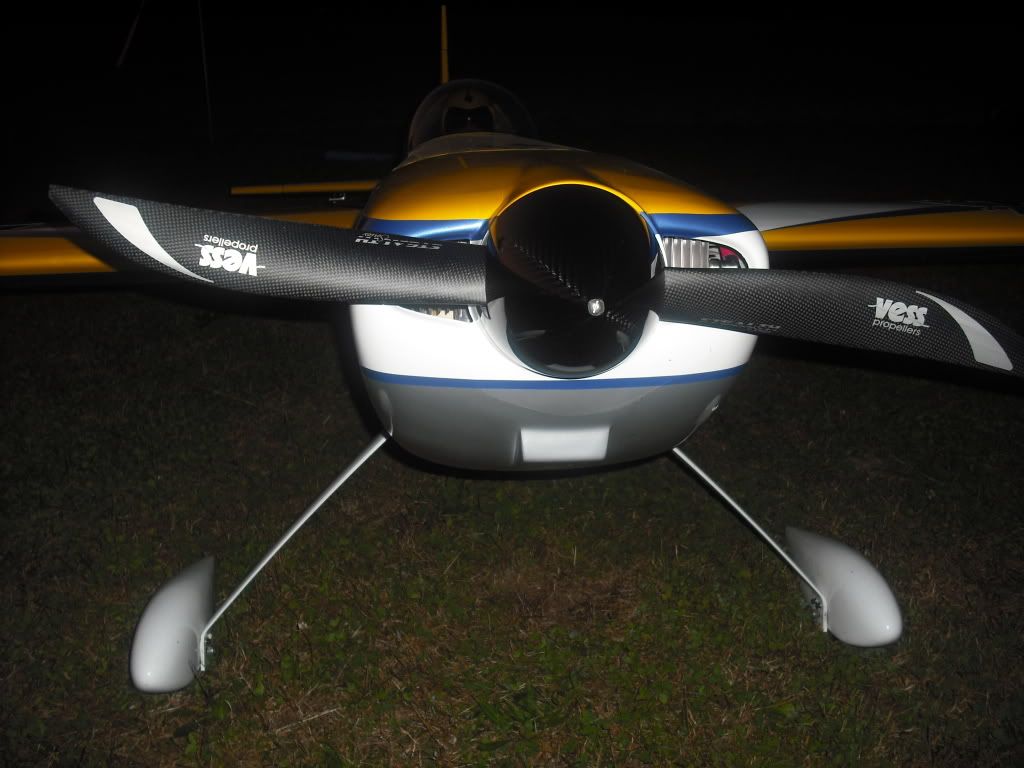

This is how I haul my 43% PAU Edge 540.

If this is the "Stealth" Vess prop, I´d rather not hear the "Regular" Vess...:-)

ORIGINAL: Pelle Gris
If this is the ''Stealth'' Vess prop, I´d rather not hear the ''Regular'' Vess...:-)
Yes it is.
The Vess Stealth carbon prop in a 32C on a DA-150 with RE3 pipes.
t is an awesome prop and it is a 100% keeper, you just really need throttle control.
When it rips, it rips loud.
