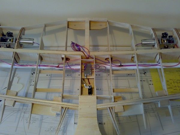

Hello gents...long story short:
we had a wing failure and lost one wing in flight on a new 5times flown
VOTEC 50CC from www.2krc.com and www.lindinger.at
too bad no one took any video ..funny to watch but not to the owner see his 3000$ going down on the deck big time surviving only 4 servos
the failure took place while a big loop when the wing broke away from the wing tube
so since thank God no one got hurt we checked the wings and here we go:
in photo 1: we see the balsa wood that connects the tube with the wing skin . wood grains are sideways
in photo 2 : we see the thickness of the balsa estimate 2mm
in photo 3: we opened up the wing that didnt fail and we see the connection webs between the ribs after the tube.
balsa 2mm again with grain sideways and all been broken in the spot on the photo (probably also from engines vibrations)
now the 3000$ question:
IS MANUFACTURES FAULT THE WING FAILURE BECAUSE OF THE WRONG GRAIN DIRECTION??
the manufacturer came back with an email saying there is nothing wrong with there design
my experience say: that web wood grains should be VERTICAL cause they provide way better structural strength
here is a kit manual...not even 50cc ! please notice photo DD19
http://manuals.hobbico.com/gpm/gpma0175-manual.pdf
Thank you all for your time voting and for also leaving a comment in this threat
We work hard for our money and manufactures of giant planes should not do this mistakes risking our money
Best regards
George

Vertical is really the wrong term, the grain of the shear webing should run "Perpendicular" to the spar or wing tube
Old 06-23-2010, 12:56 PM

Agree with you. Webbing must be perpendicular with main spar to make a solid I-beam type structure. Some ARF's make use of CNC laser cutters to cut ply main spars. Obviously the grain would be horisontal due to the lenght. But these spars should be capped with grain running perpendicular as well...

Yep perpendicular to the spars is a must. That structure needs shear webs. Normally if I scratch build I would have 2 1/4 (or larger depending on scale) inch spruce spars running the length of the wing with two large 1/4 inch ply braces at the heart of the structure. Something like this is what is needed IMO.

I can see why they did it the way they did. That looks like a sheet of balsa laser cut to make that support, but it is the wrong direction. To do it right, the manufacture would have to make much smaller parts and they cost time and money for them. I don't think webbing is the place to try and save weight by cutting them out like that either. Each section should have it's own piece of balsa and only run vertical, not span ways. The best way is to put it between the spars making an I beam out of it. At least put webs between the ribs with no holes in them and with the grain running vertical. I would have changed that in the build. I know it hurts, but the builder is partly at fault for building it that way. Unless he is new, he should have known better. If he wasn't sure, he could have ask here and found out that it is a bad design. Who ever designed that wing either didn't know or didn't care. Looks to me like they were just trying to save money. In the long run, they could have put a sheet of balsa in the kit and let you cut them out yourself. That would save money too and wouldn't come back to bit them.That is a BIG no no to build them like that. Cutting holes in them takes most of the strength out of them just doing that, but running the grain length ways is way wrong and the manufacture should know better.

In full scale wooden construction it is common practice to use plywood for shear webs. It has been shown by experiments that diagonal plywood [face grain at 45° angle to the edge of the panel] is approximately five times stiffer in shear than square laid plywood and somewhat stronger.
If "single grain orientation" wood such as sheet balsa is used, the grain should be running perpendicular to the beam direction.

The grain must b vertical or perpendicular to the spar !! It also must be a tight fit between the ribs !! Most homebuilts use an I beam type instead of a full box to save weight. The sheer web is only their to stop the bending moments of the spar. The bottom spar is in tention and the top spar is in compression, while positive G loads are in effect. just the oppisite in negative gs
the tip only transfers the loads from the top spar to the bottom spar, and vise versa !!

Skip, 45 degrees is ONLY to be used with ply/laminates.  Otherwise, it's PERPENDICULAR!!!!!!!!!!!!!!!!!!!!!!!!!!!!!!!!!!  Horizontal is the absolute weakest way for that thing to be placed.  In fact, it's MEANT to fail when placed parallel with the spar.
