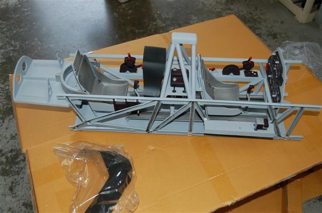

The CARF AT-6 shown at JN is in full production. In the UK we have a few being built, one locally to me. Here is CARF's scale cockpit ready to fit from the box.

Default did you find how to mount it? Thank you
[QUOTE=Dave Wilshere;12562959]The CARF AT-6 shown at JN is in full production. In the UK we have a few being built, one locally to me. Here is CARF's scale cockpit ready to fit from the box.

Sorry missed this. Not done that yet, but there are cross carbon rods.

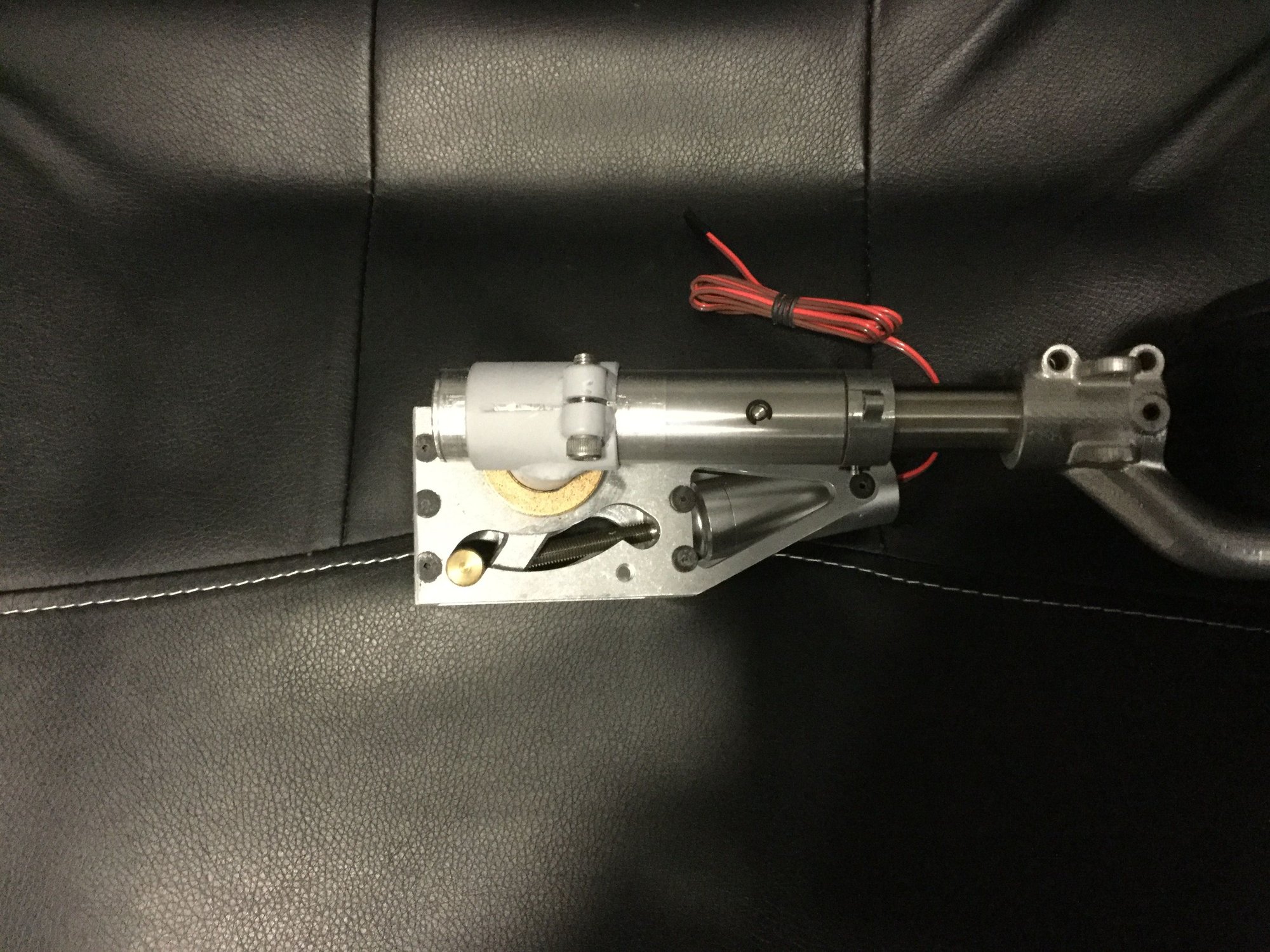

On another note if anyone got landing gear late last year, there were a few sets that went out with the leg drive/mount swapped, so the leg mounting tube is high off-set not low off-set. 10 sec job of swapping them over. The base of the leg catches the door hinge tube if they are reversed.
Dave
This is wrong, the leg centre should be below the pivot.

Gear completely finished.
