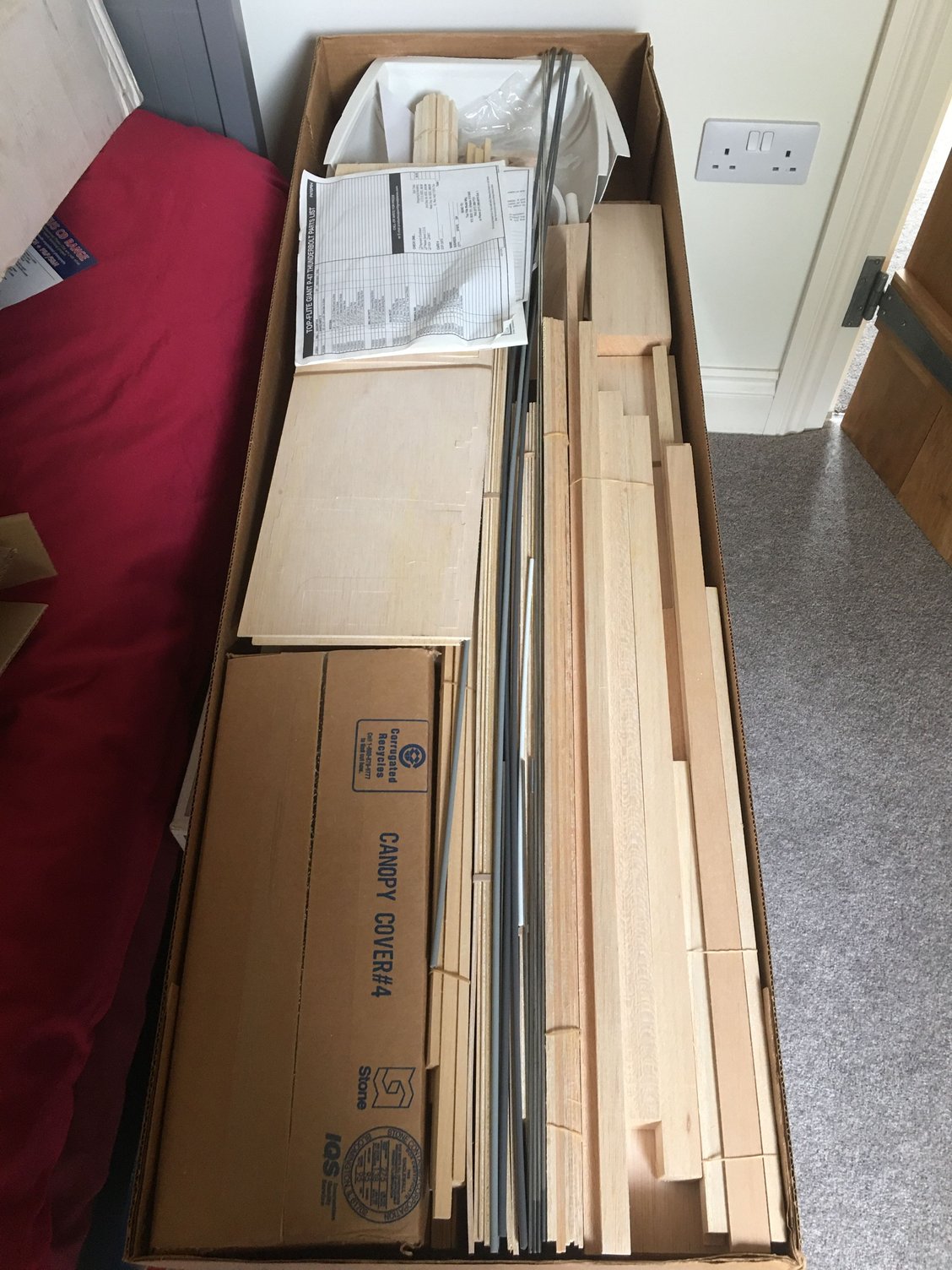

Ok. Ive finally taken the plunge and decided to open the box of my Giant Scale Topflite P47. Its been in the attic for a few years now. Either sell it or build it I thought! So im going to build it, following many of the great threads already available here and elsewhere.
Its going to be a slow build. Time is always at a premium and I know you're probably bored with the number of P47's. Then again, what's one more. Looking forward to comment and support as I go.
The 'Jug'
Hmmm! Thats a lot of wood!

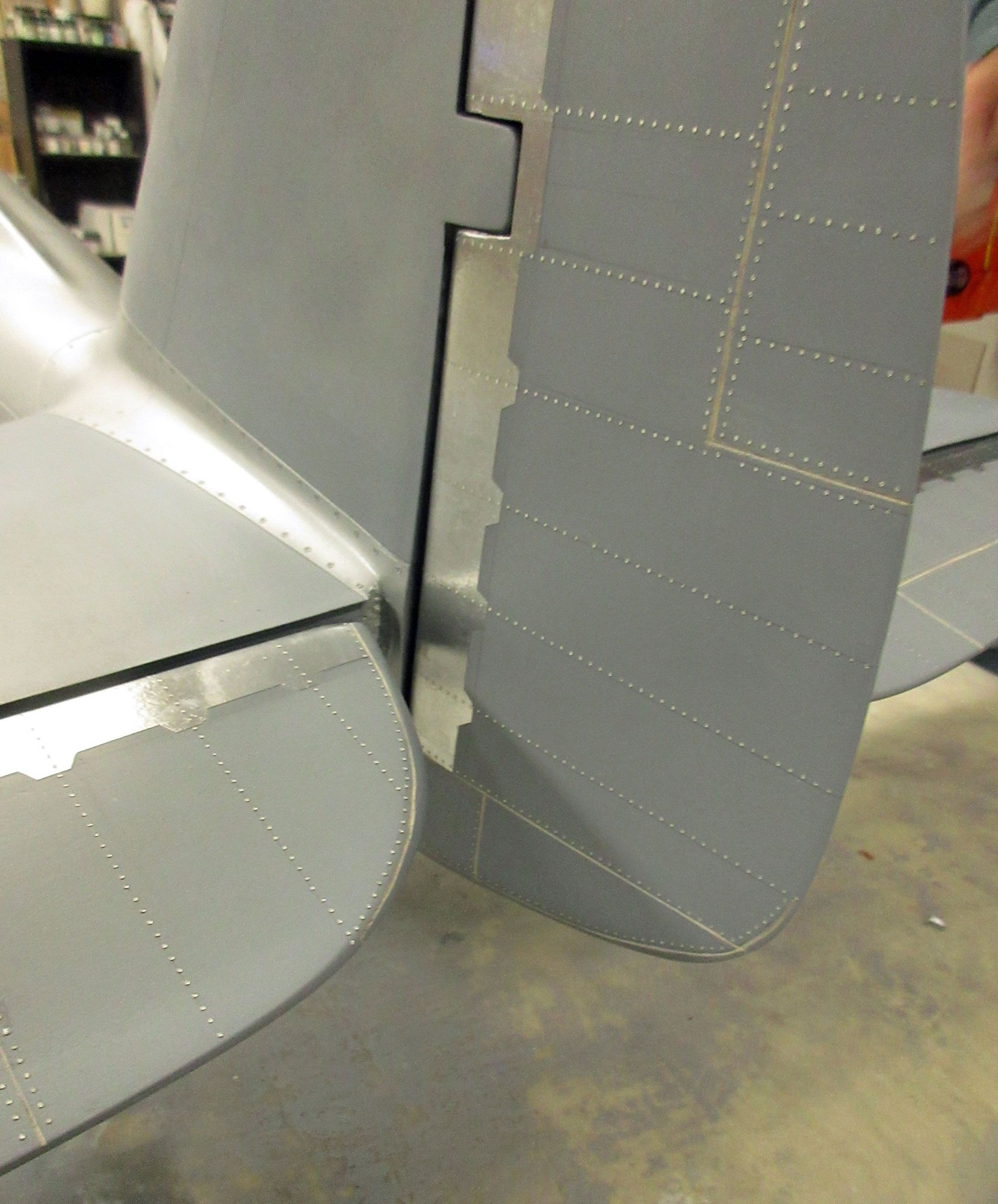

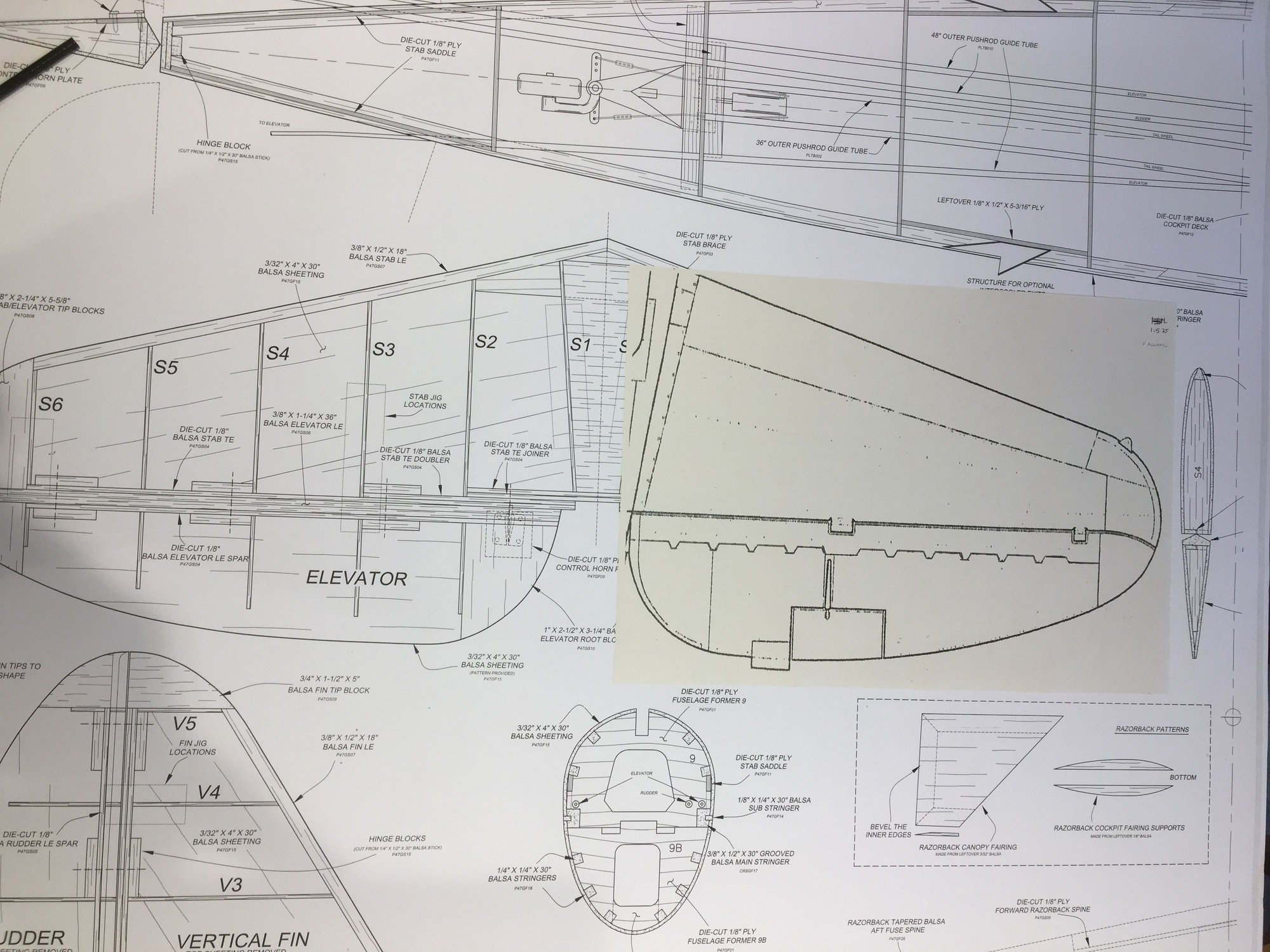

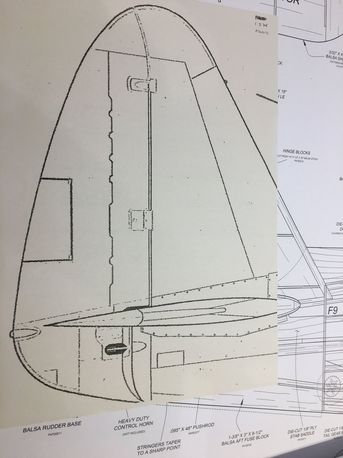

Scaled up the line drawings for the fin/rudder and tailplane/elevator to 1:5.75, the scale based on 85inch wingspan (40ft 9in for real). The topflite outline is incredibly accurate. Couple of photos to demonstrate.....

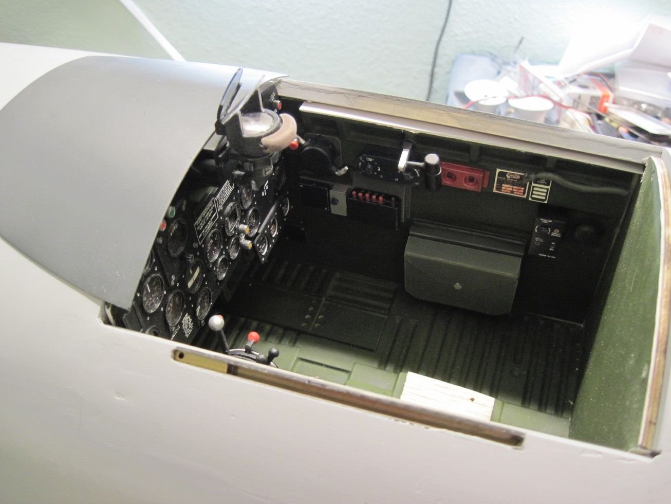

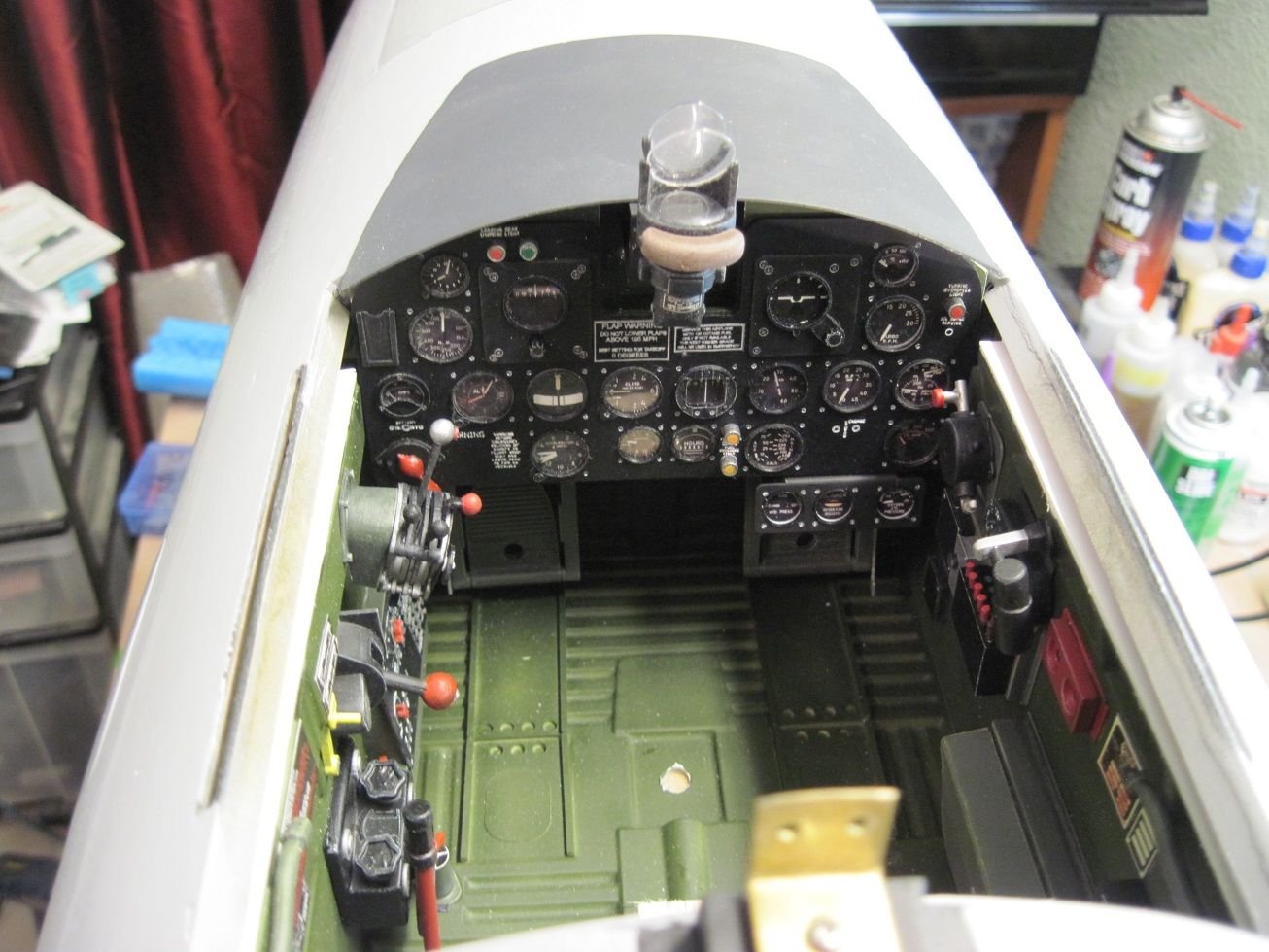

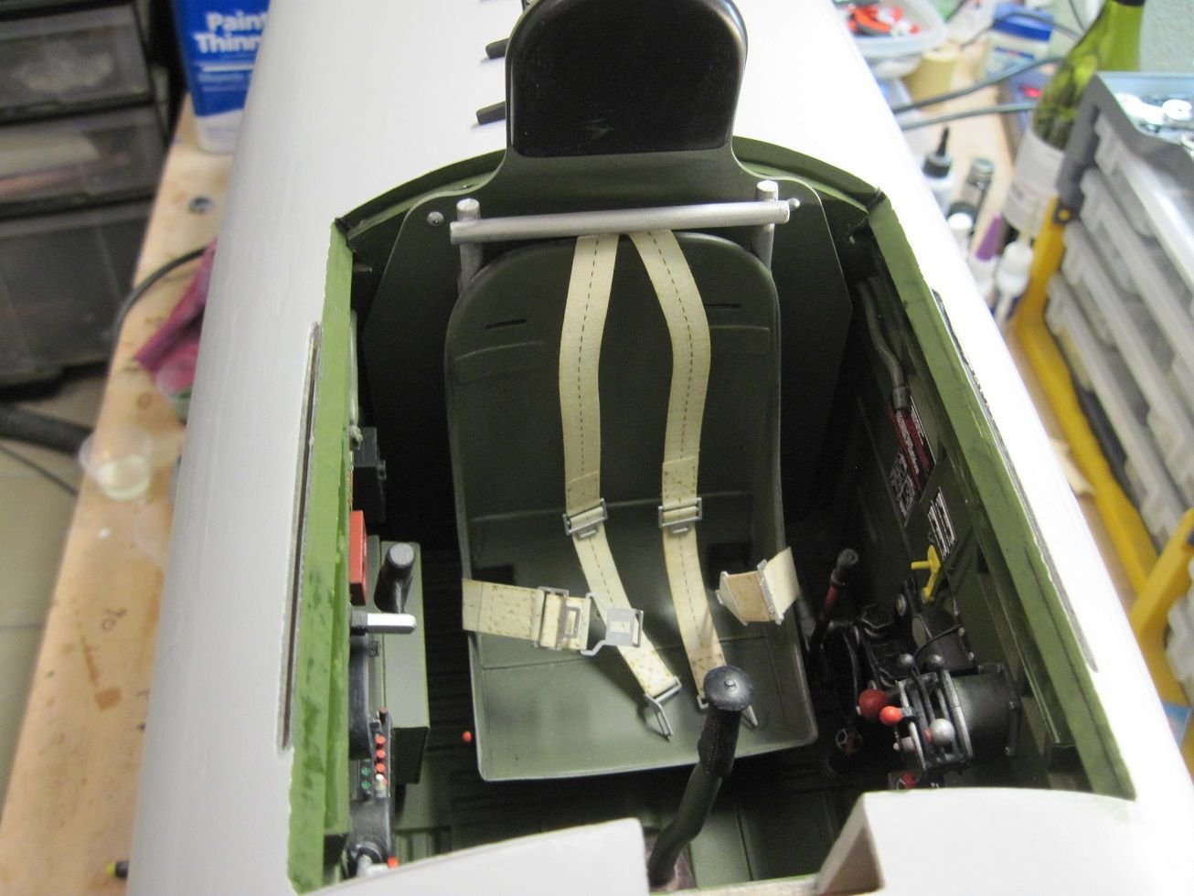

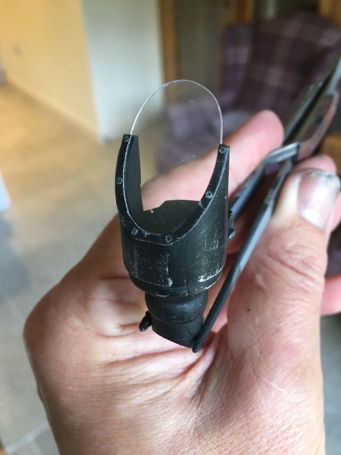

So I finally received the cockpit kit from JP Warbirds and have started the build. Seat will be scratch built as will the cockpit corrugated floor to save weight.
Old 03-19-2021, 01:07 PM
harriermate
harriermate's Avatar
Join Date: Jul 2020
Posts: 47

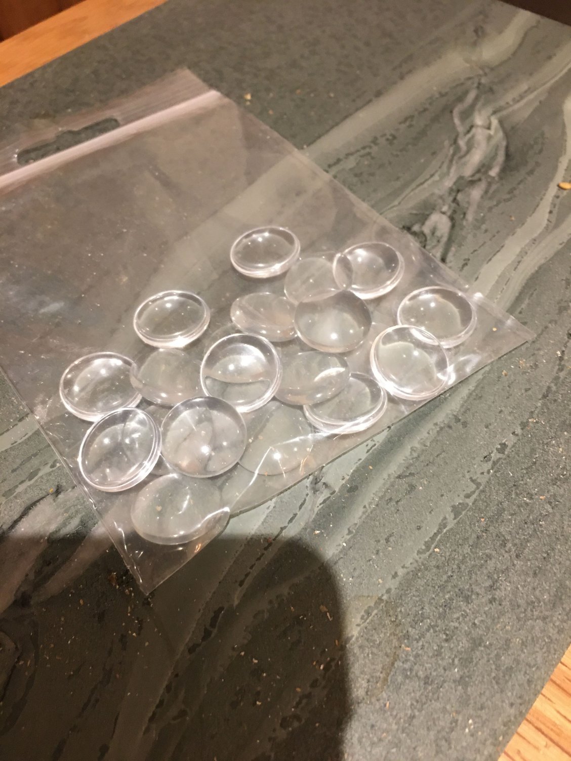

Highly recommend the JP Warbirds cockpit kit. And Ive just discovered 'cabochons'... Never heard of them before. They are basically flat based glass convex lenses that are absolutely perfect for the collimating lens in the Mk8 gunsight (16mm diameter). And at £2.95 ($4) for 20, I have 19 spares!

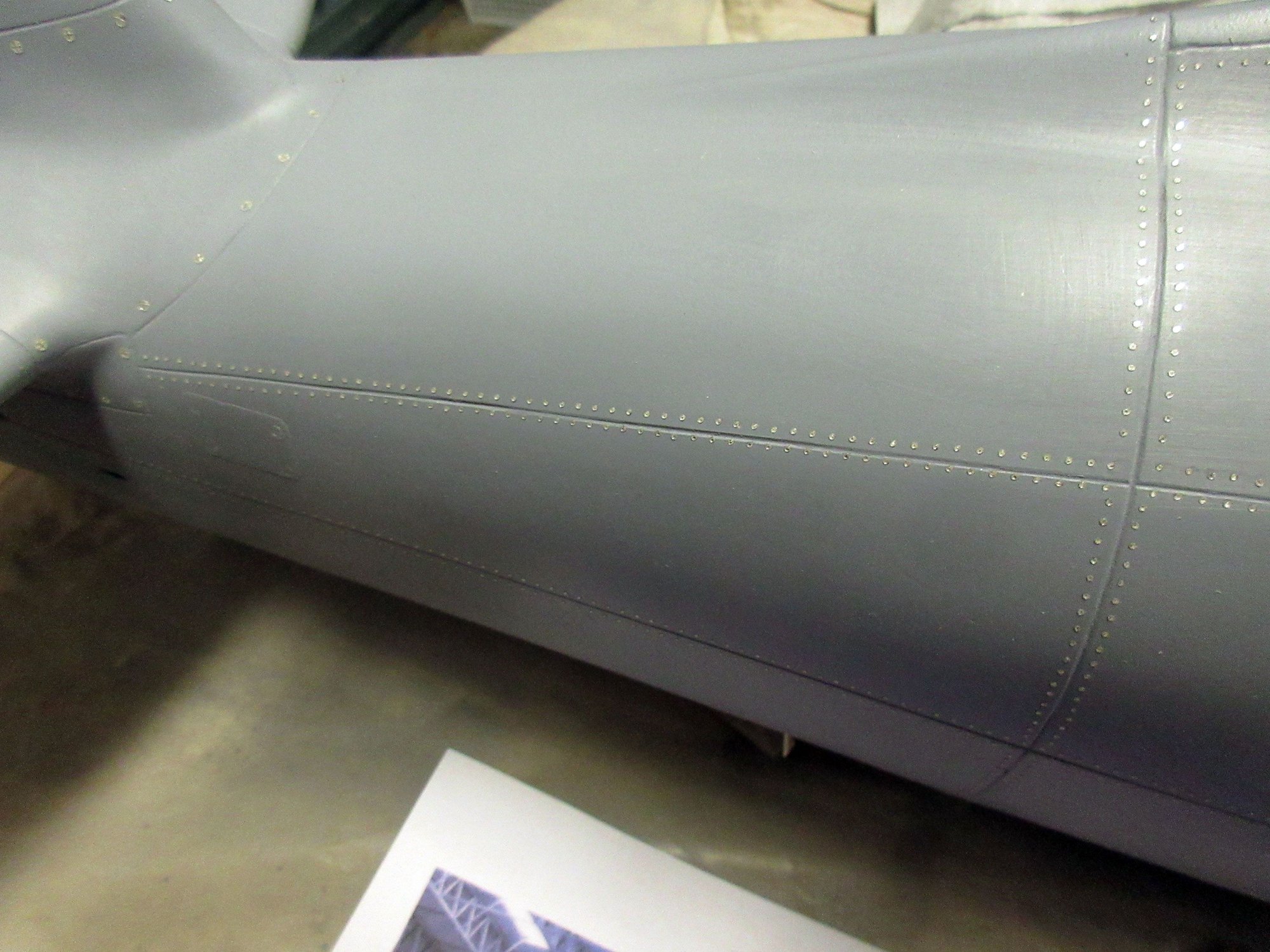

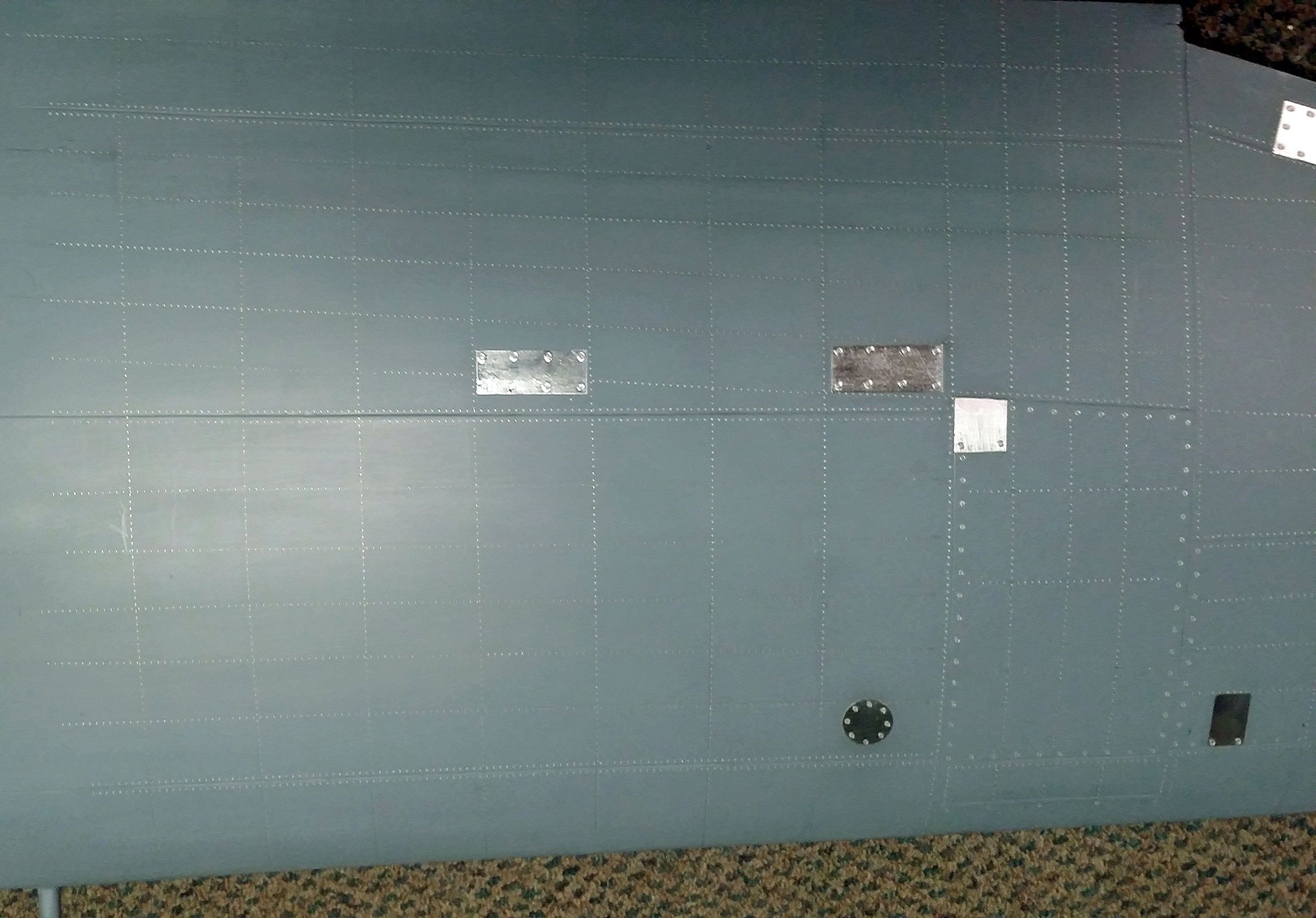

Nice work on the cockpit harriermate. I went through the same exercise a few years ago and developed a 1/6 scale P-47 cockpit. As I am sure you are aware, just the research alone is a huge project, much less the actual construction. When you get down to finish work on your Jug I can supply rub-on surface details including rivets, fasteners, hatches, panels, inspection covers, etc. if you are interested. Rub them on the primed surface of the model and then paint over them. Enjoying the build.
Chad Veich
[email protected]
Old 03-19-2021, 11:16 PM
harriermate
Join Date: Jul 2020
Posts: 47
Thanks Chad. The rivets look very realistic. Will definitely take you up on that!

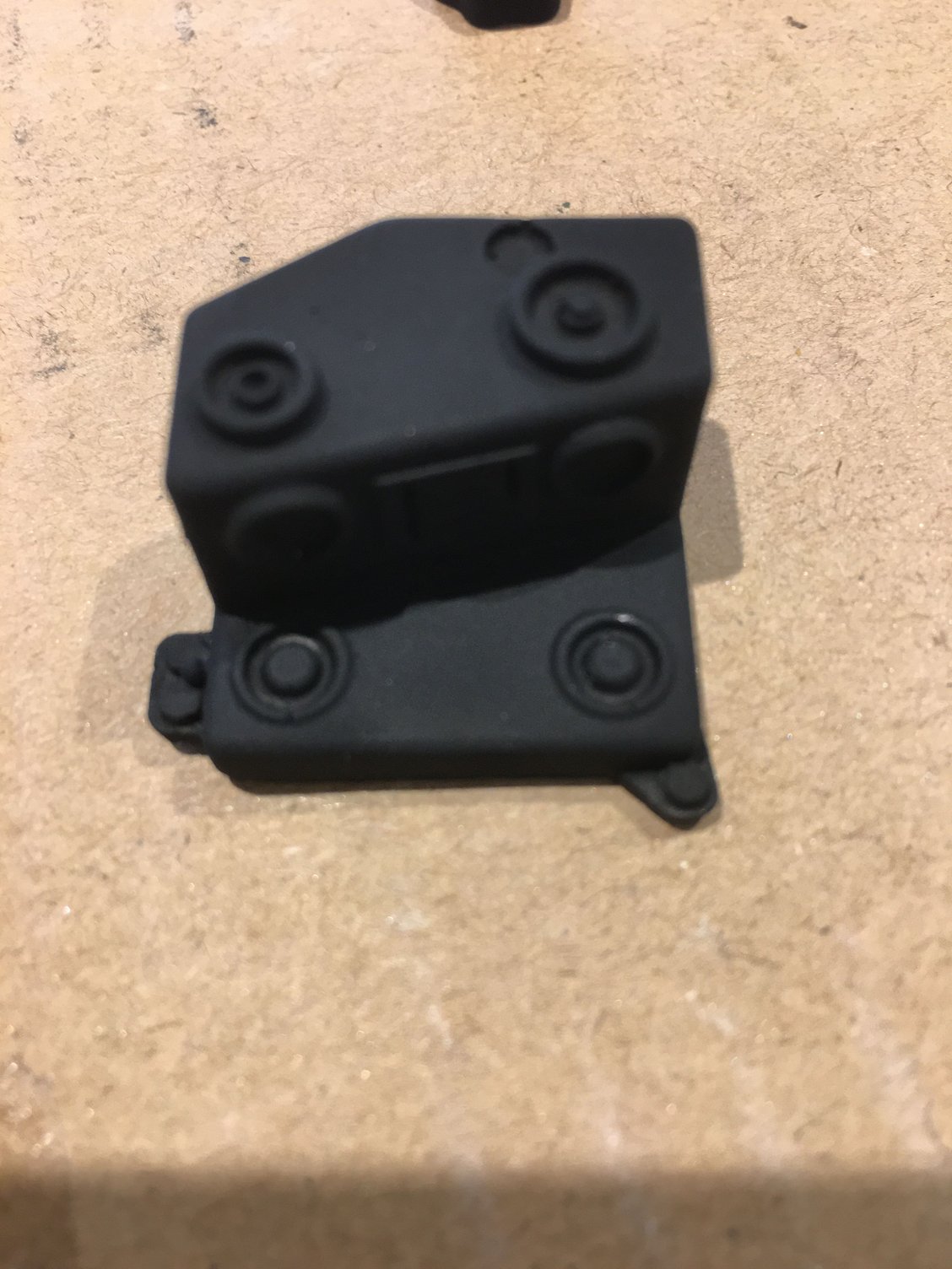

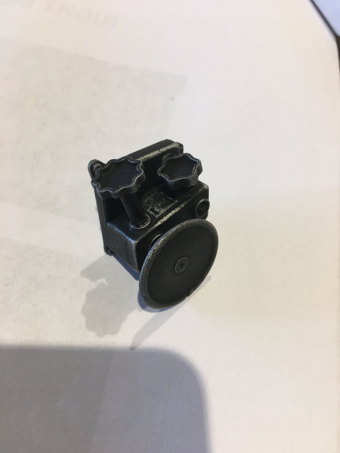

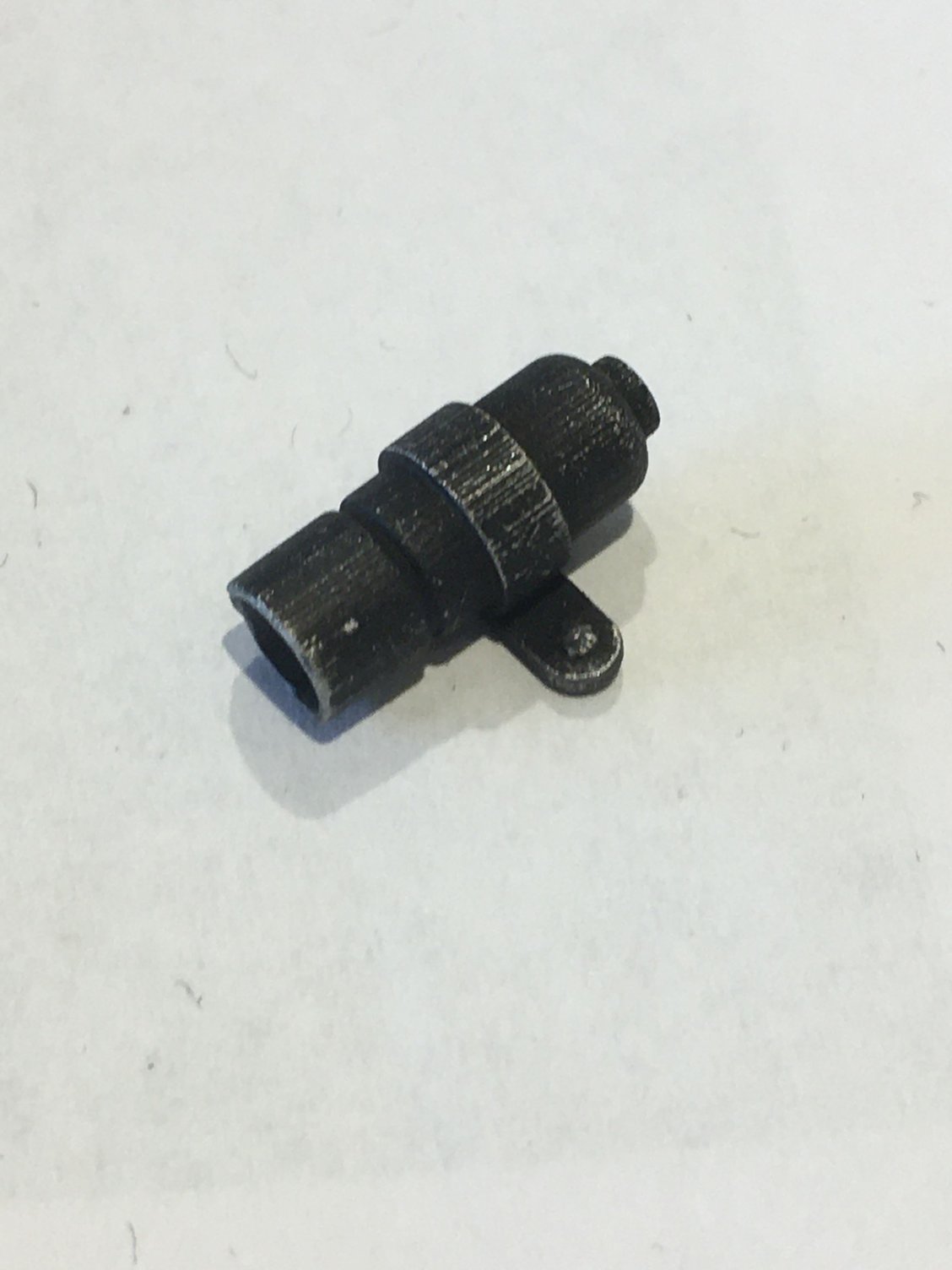

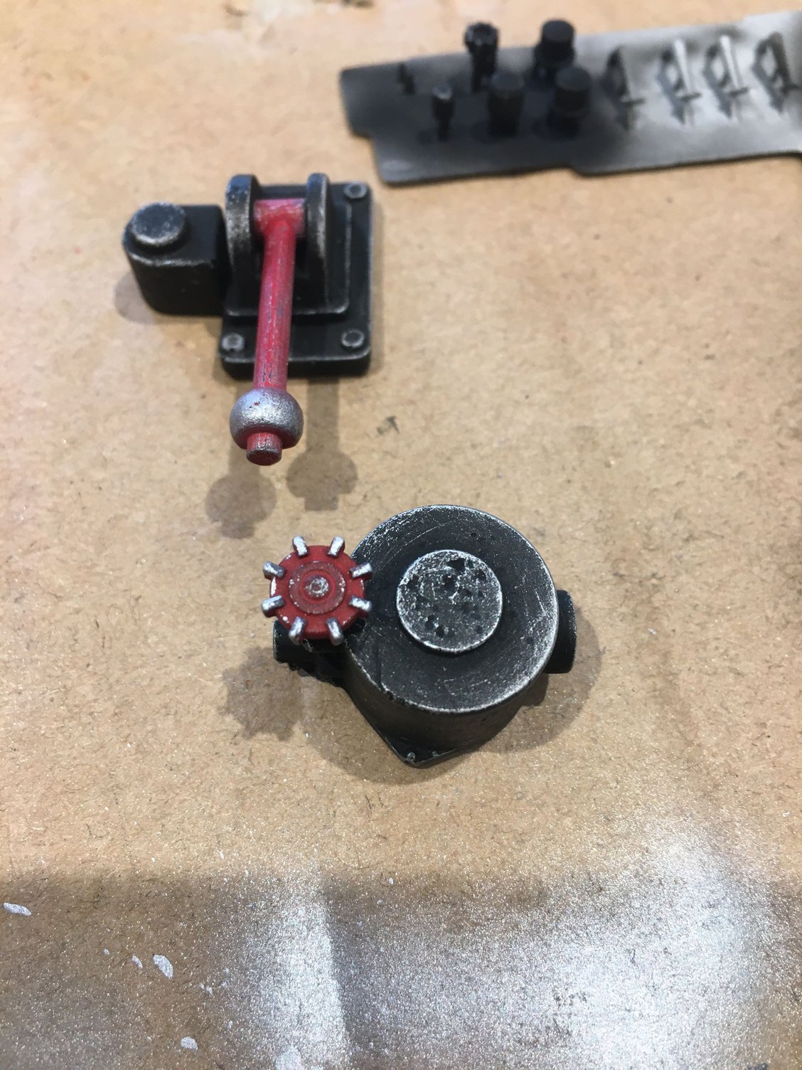

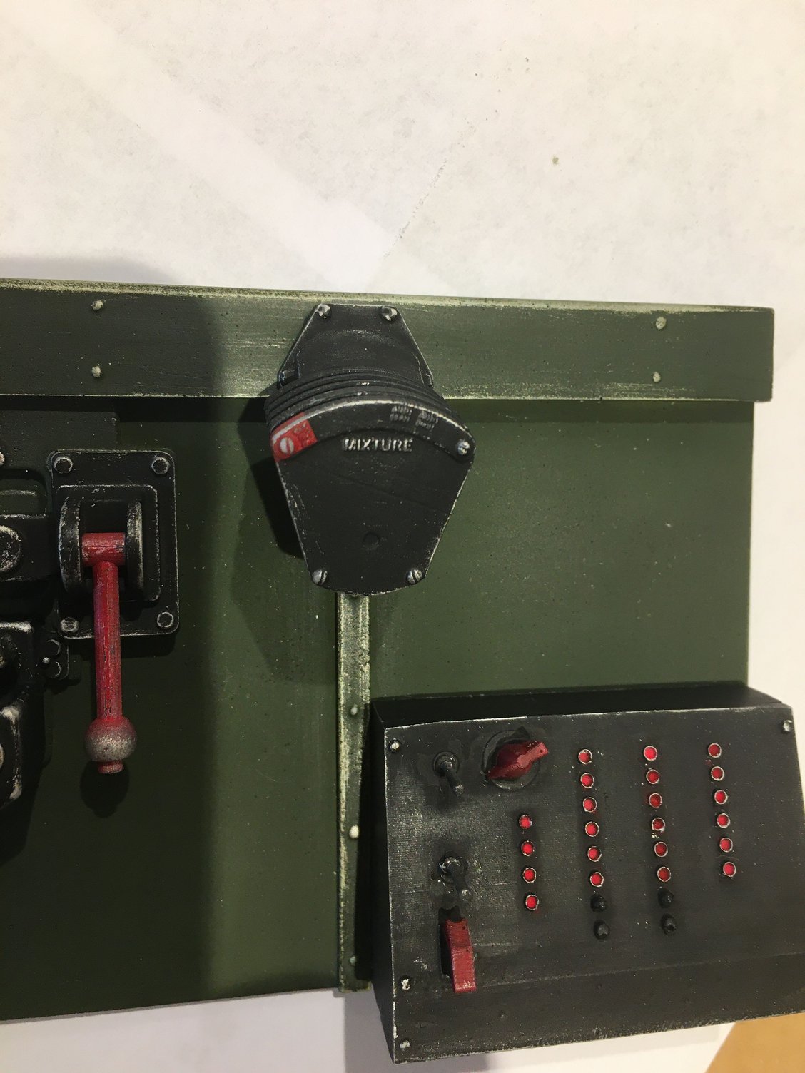

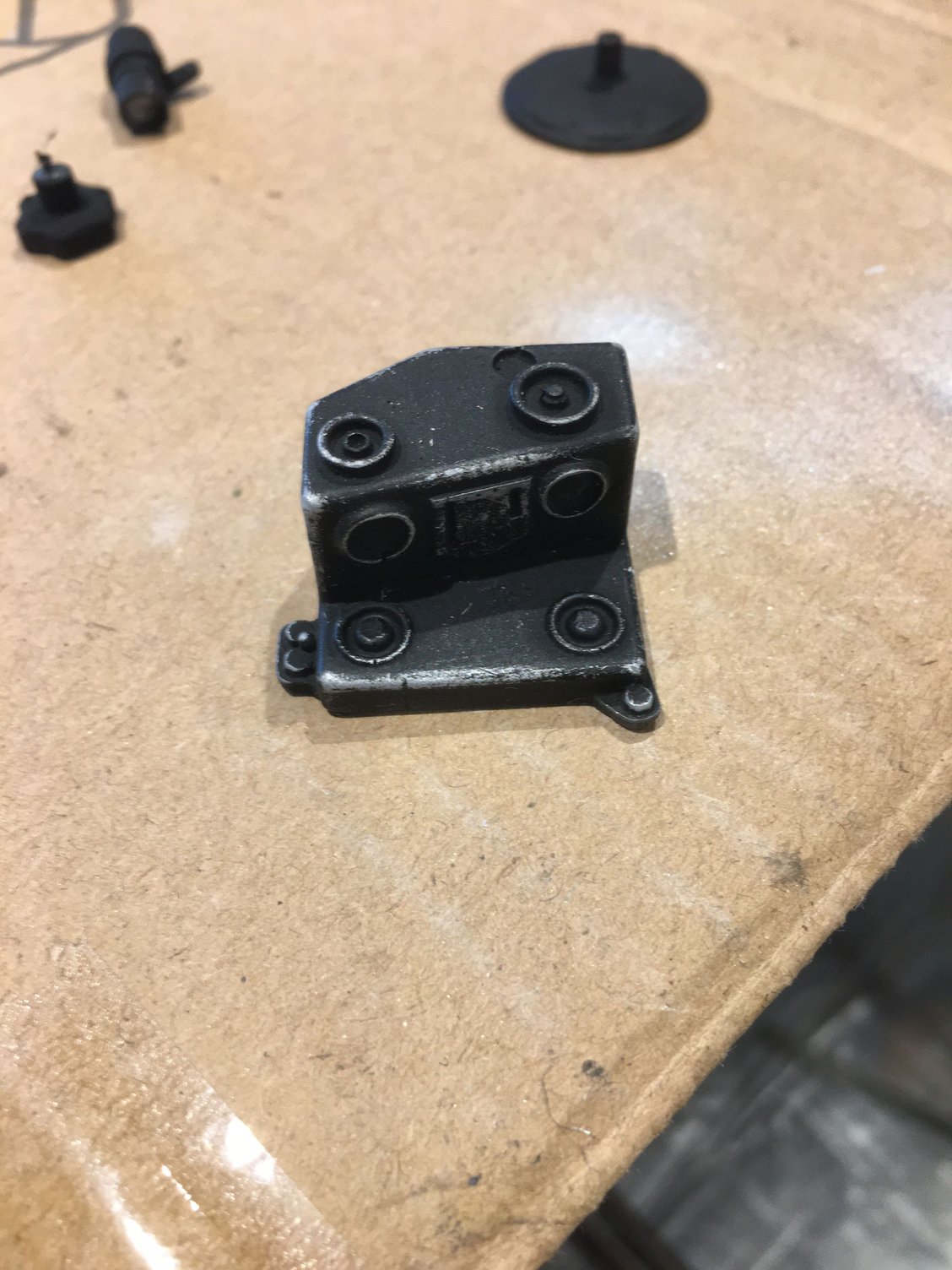

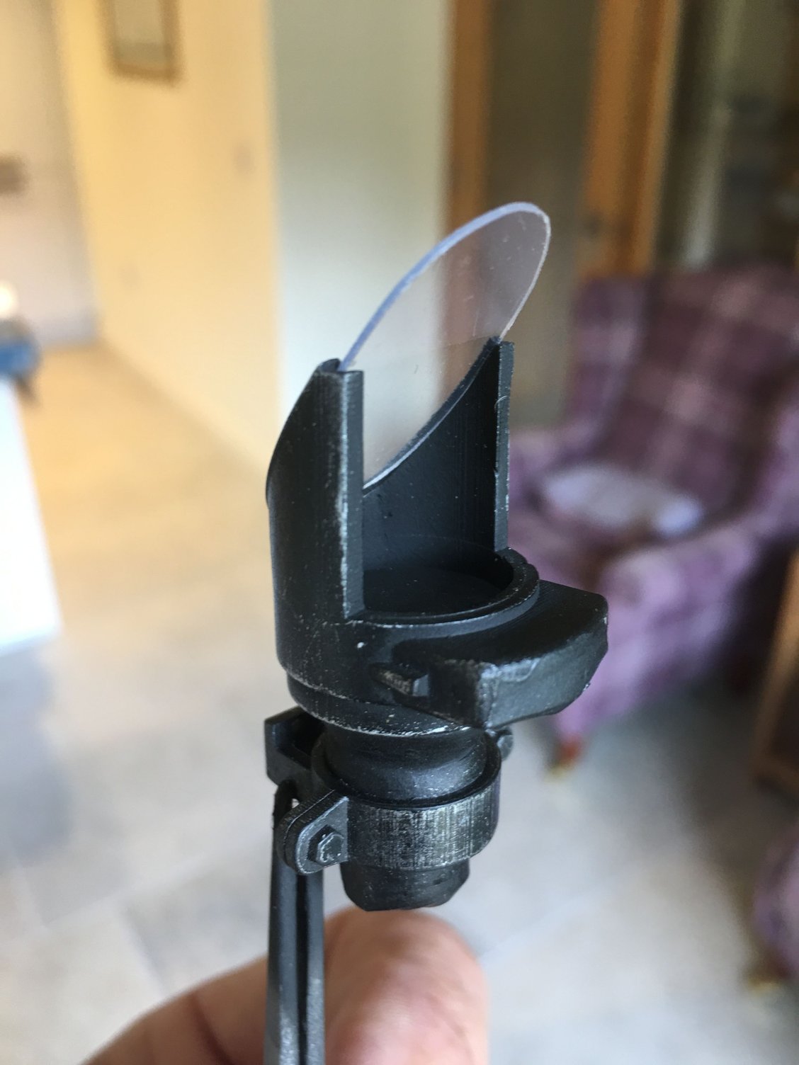

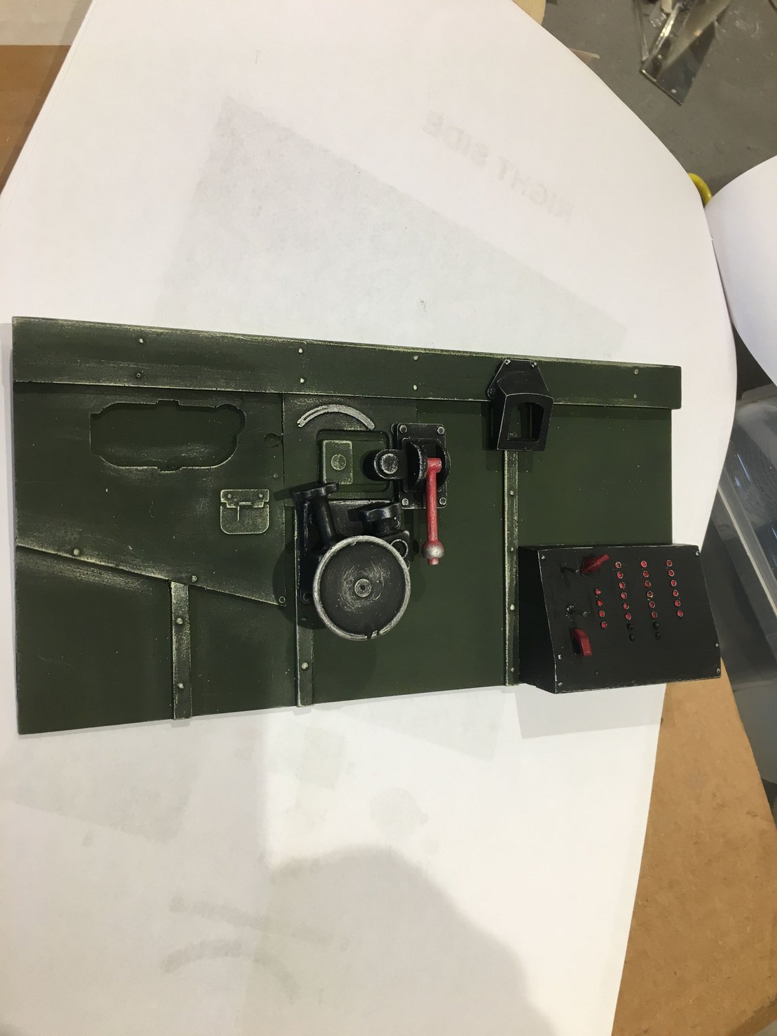

Cockpit kit slowly taking shape... looking at the photos, no one P47D seems to exactly match another! 🤪
Trim control unit before....
During...,
And after ageing
Oxygen controller
Wander lamp
Gunsight under construction
Mounting bracket attached
Oxygen controller and landing gear selector
Trial fit of circuit breakers and throttle quadrant

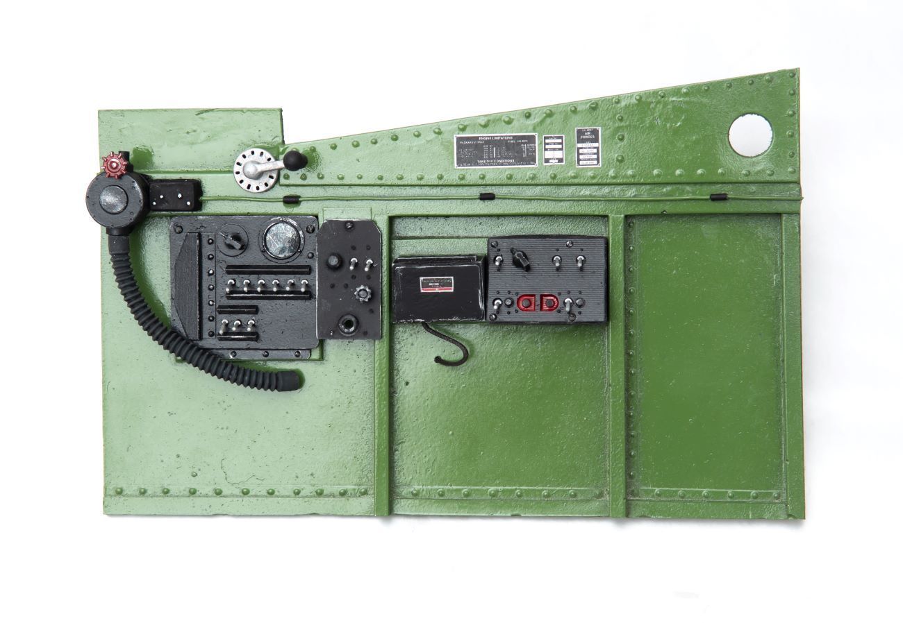

Left side wall under construction

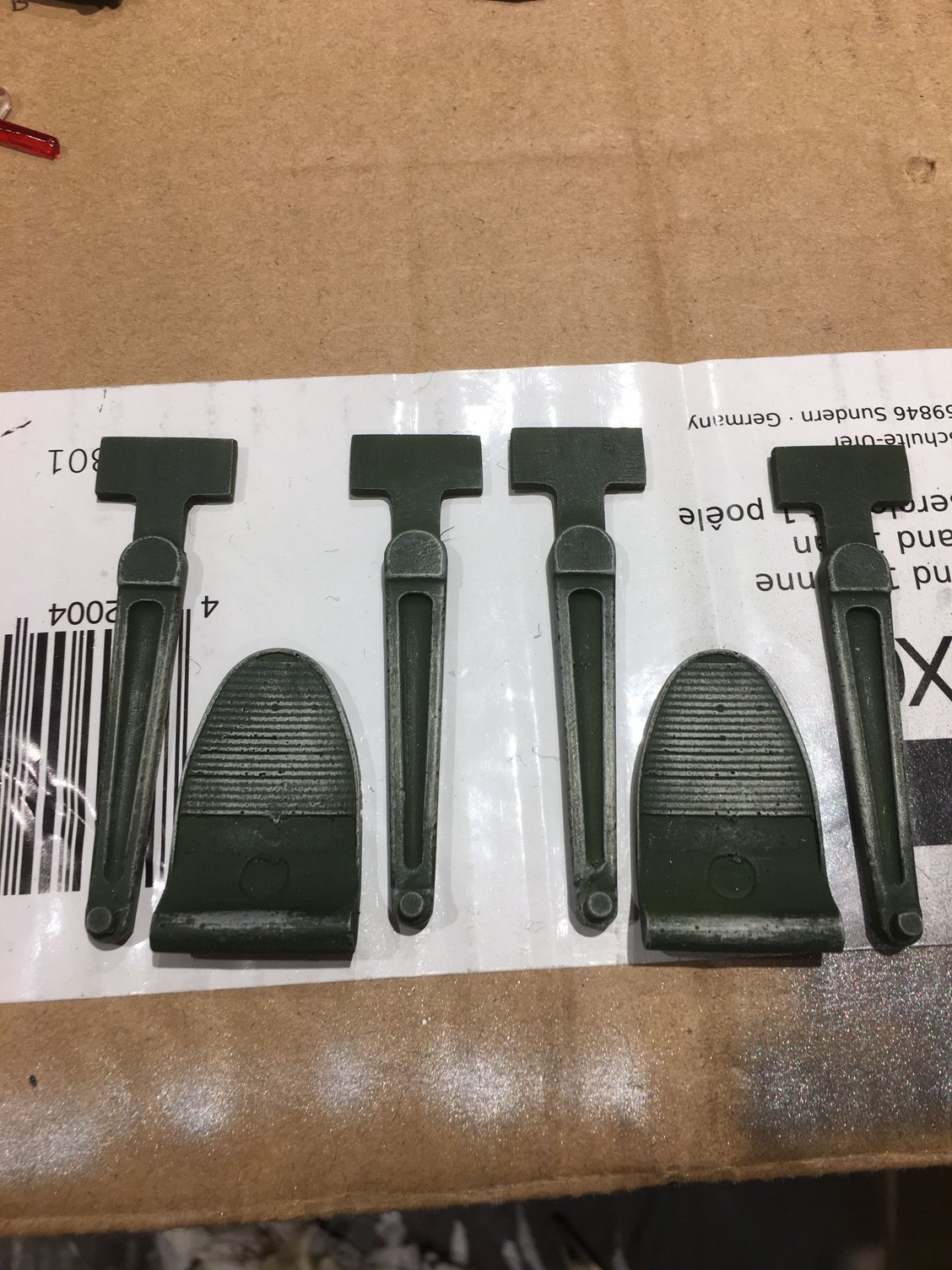

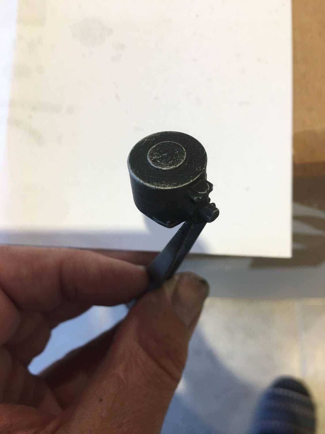

Rudder pedals ‘aged’ and ready for assembly
Old 03-24-2021, 11:22 PM
Prekin
My Feedback: (19)
Prekin's Avatar
Join Date: Jan 2008
Posts: 1,986
Received 51 Likes on 44 Posts

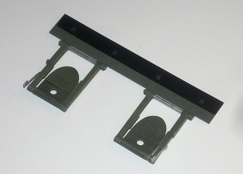

Great job on your cockpit Nigel!! Like weathering you did. Do not forget to drill the small hole in rudder pedals to keep them scale.

Thanks Jiri. I would almost certainly have missed that. Im currently experimenting with producing additional placards for the cockpit walls and components, using original photos as templates. Here's an example..

Oops! Typical. Cant even read it at the correct scale. Still.... I know what it says!

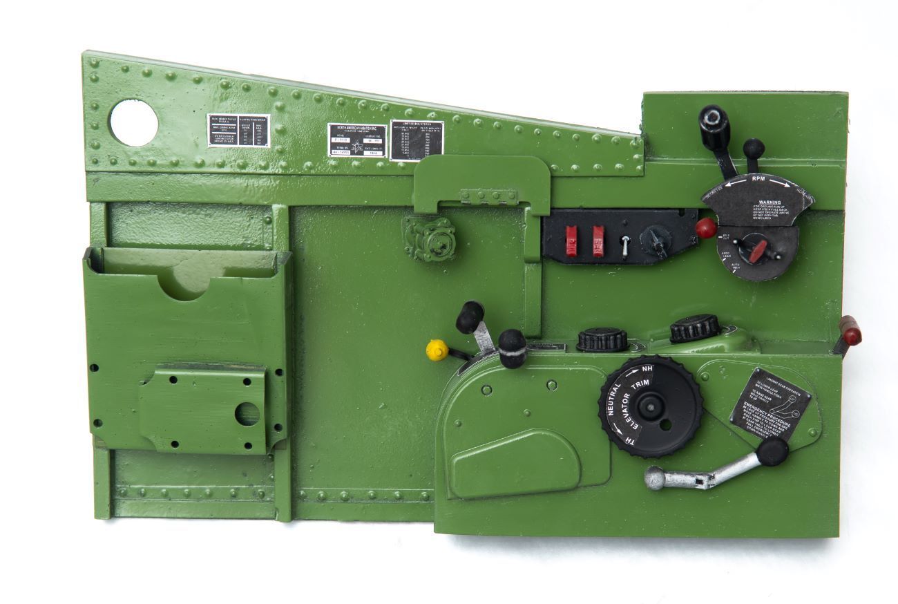

Originally Posted by harriermate View Post
...looking at the photos, no one P47D seems to exactly match another! 🤪
Thank you! It's good to know that I am not the only one who came to this conclusion. I ended up just picking and choosing those items that seemed to be the most common for my cockpit as well as those that I had the most information on. One or two may have been thrown in just because they added some color as well!
And since we are sharing rudder pedals, here is mine. Fun to see each person's interpretation of what they are looking at. Of course just about zero of this stuff can be seen in the finished cockpit but it's fun to know it is in there none the less.
Old 03-25-2021, 11:07 AM
harriermate
Join Date: Jul 2020
Posts: 47
Chad, I see you even added the rudder pedal reach adjusting levers.... now I’ll have to do that too! 🤪
