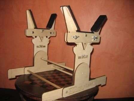

My large scale aircraft is nearly complete. I've never had problems balancing a model before, but this one presents a little challenge, its heavy. I'm estimating in the neighborhood of 30-35lbs flying weight. The balancing point on the wing does not have any support for say, attaching dowels for string to attach, and balsa sheeting isn't strong enough to support that much weight with out using a strong point. How do people generally balance a heavy model?

This is what I use for balancing heavy model aircraft, works like a charm. Sold by Legend Hobby https://www.legendhobby.com/product/vic-rc-cger-stand/

Or...you could buy this: https://www.chiefaircraft.com/xcy-cgcombo.html

Study up on the the "Vanessa rig"... Simple, cheap, and very effective..
Old 11-20-2020, 02:51 PM
Britflier
Join Date: Nov 2015
Location: Boynton Beach, FL
Posts: 26
Received 3 Likes on 2 Posts
+1 for DGrant. I have a Vanessa rig permanently set up in my garage.
