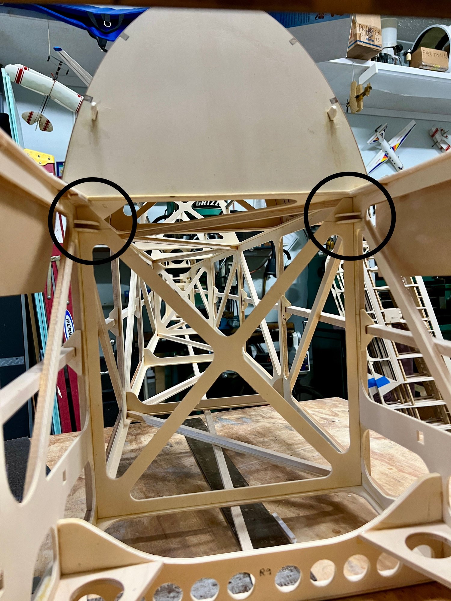

Here, I've pinned the cabanes. The plans show wood screws pinning the brackets in but I couldn't figure out how that could work: if you drilled the proper size hole for a wood screw through the cabane (and thus the aluminum fitting) then when you tried to screw the wood screw in, the fitting would stop the screw immediately. My solution was to drill and tap the holes then use 3mm button head bolts epoxied into place. I really like the way it worked.
On a related note, the wing struts don't get the fittings pinned because they are ALWAYS under compression. Well, using that rationale, the exact same thing applies to the fore and aft cabanes - but NOT the diagonals. So only the diagonals really need pinning. Food for thought.
All heads to the inside of course.

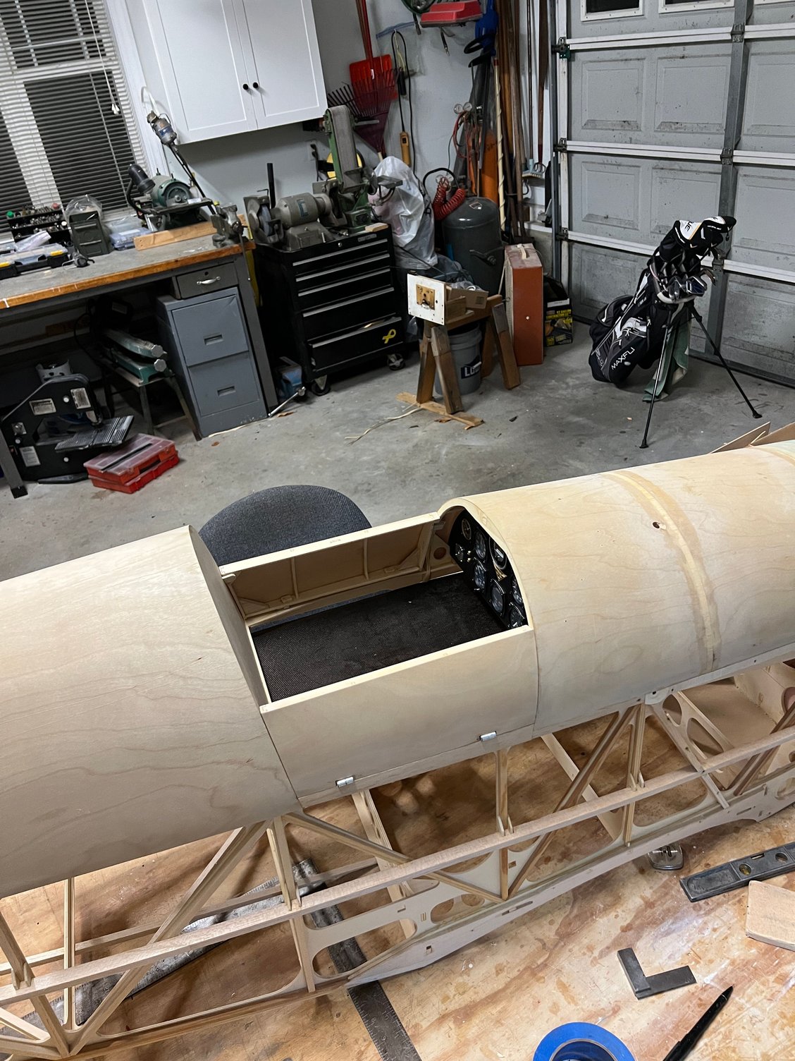

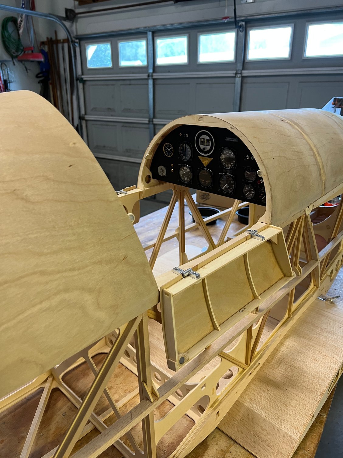

Details details details. Mounted the instrument panel today. I purchased this panel when I bought the plane from Voglesang Aeroscale. They claim "museum quality." I'm not sure about that, but it IS gorgeous. It was surprisingly pesky to install but in the end I am very happy with it.

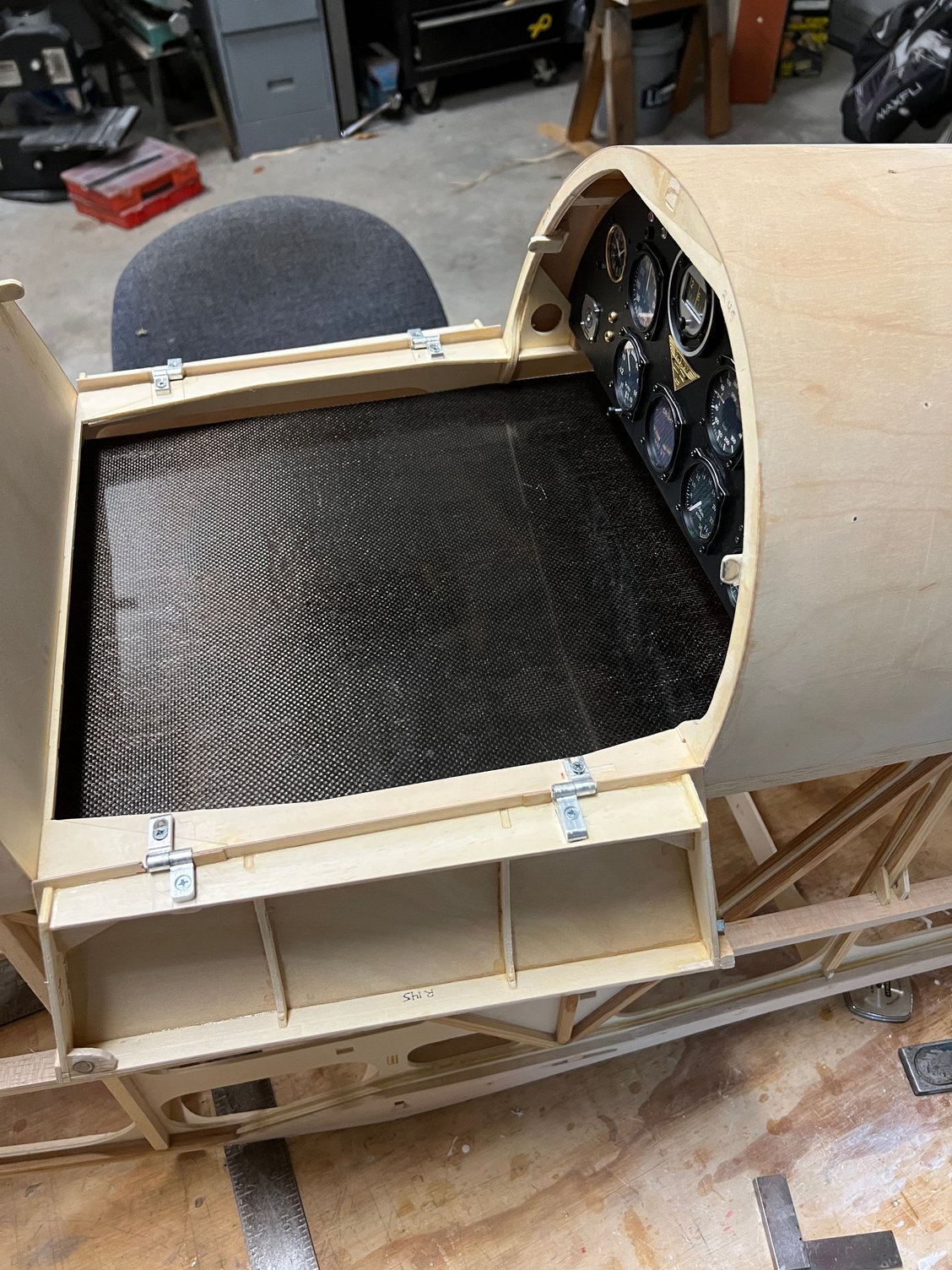

Now the pilot installation. As I said many times, I'm not a real scale buff HOWEVER I can't stand to see a beautiful airplane fly buy with nobody in the cockpit!! Just looks wrong to me. However, I don't really need a fully scaled cockpit to make me happy. I'm "stand-off scale" all the way.

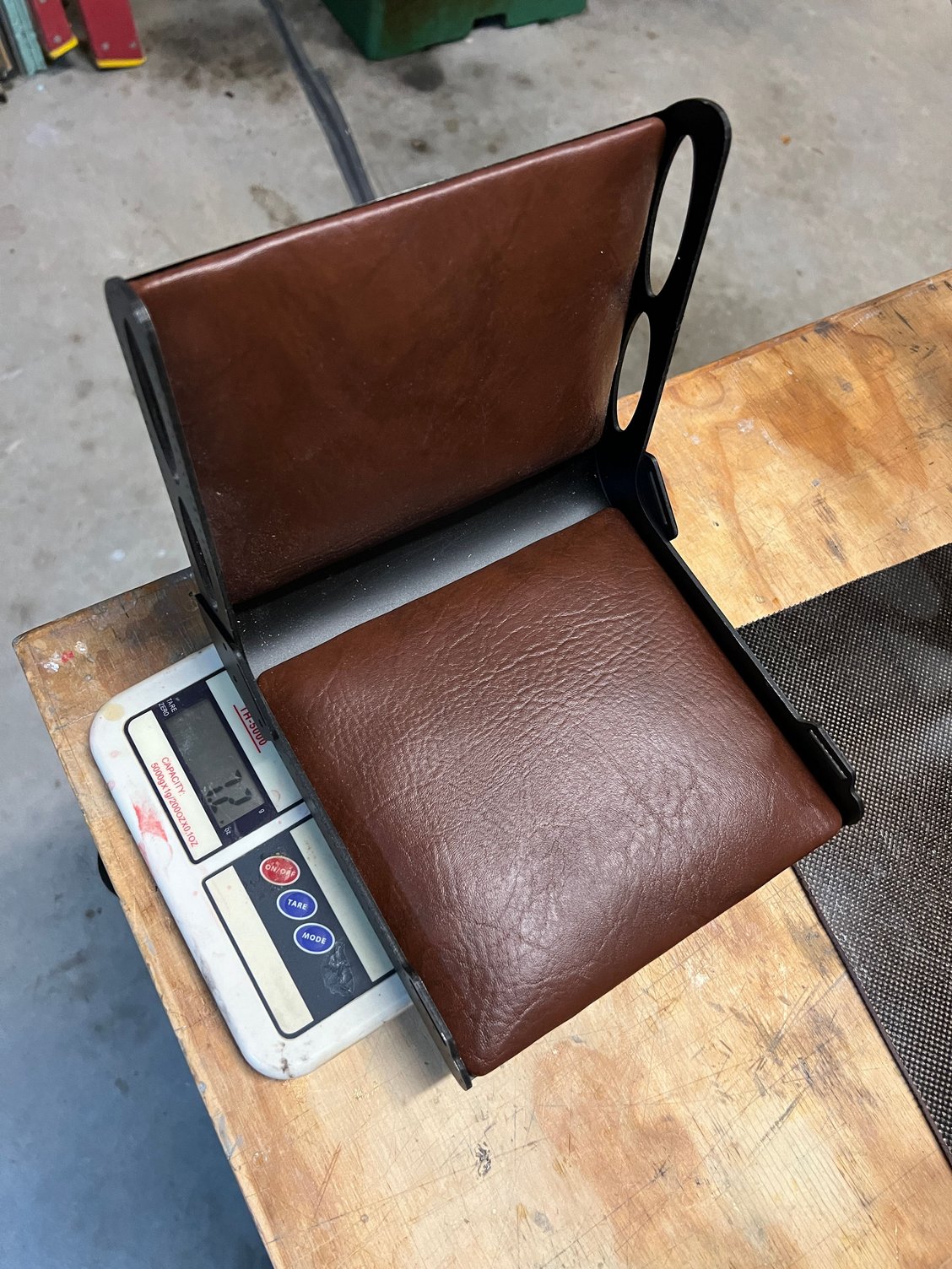

However, I did begin the process of installing a seat I bought from Voglesang Aeroscale. After setting that and the 3' tall pilot in place, along with all the needed structure, I just couldn't bring myself to do it! I know many small buffs will hate my idea I decided to install a cockpit floor and a pilot bust instead. Some day, I suppose, if the next owner of this plane wants a scale cockpit the floor is easily removable.

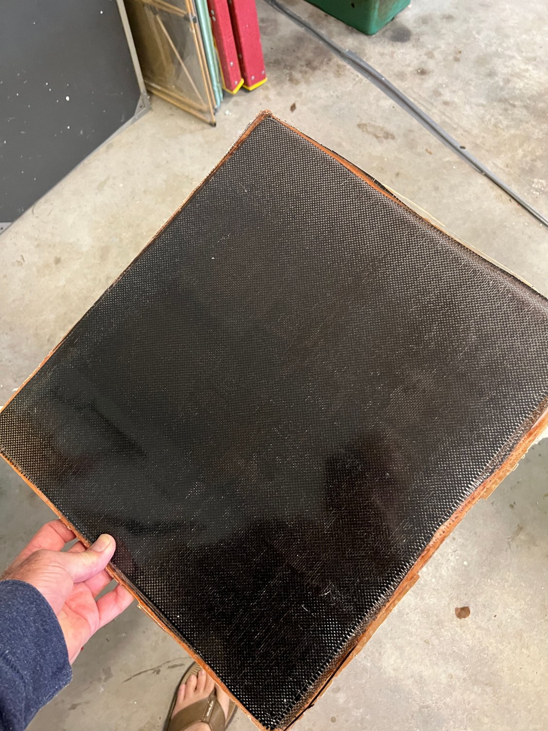

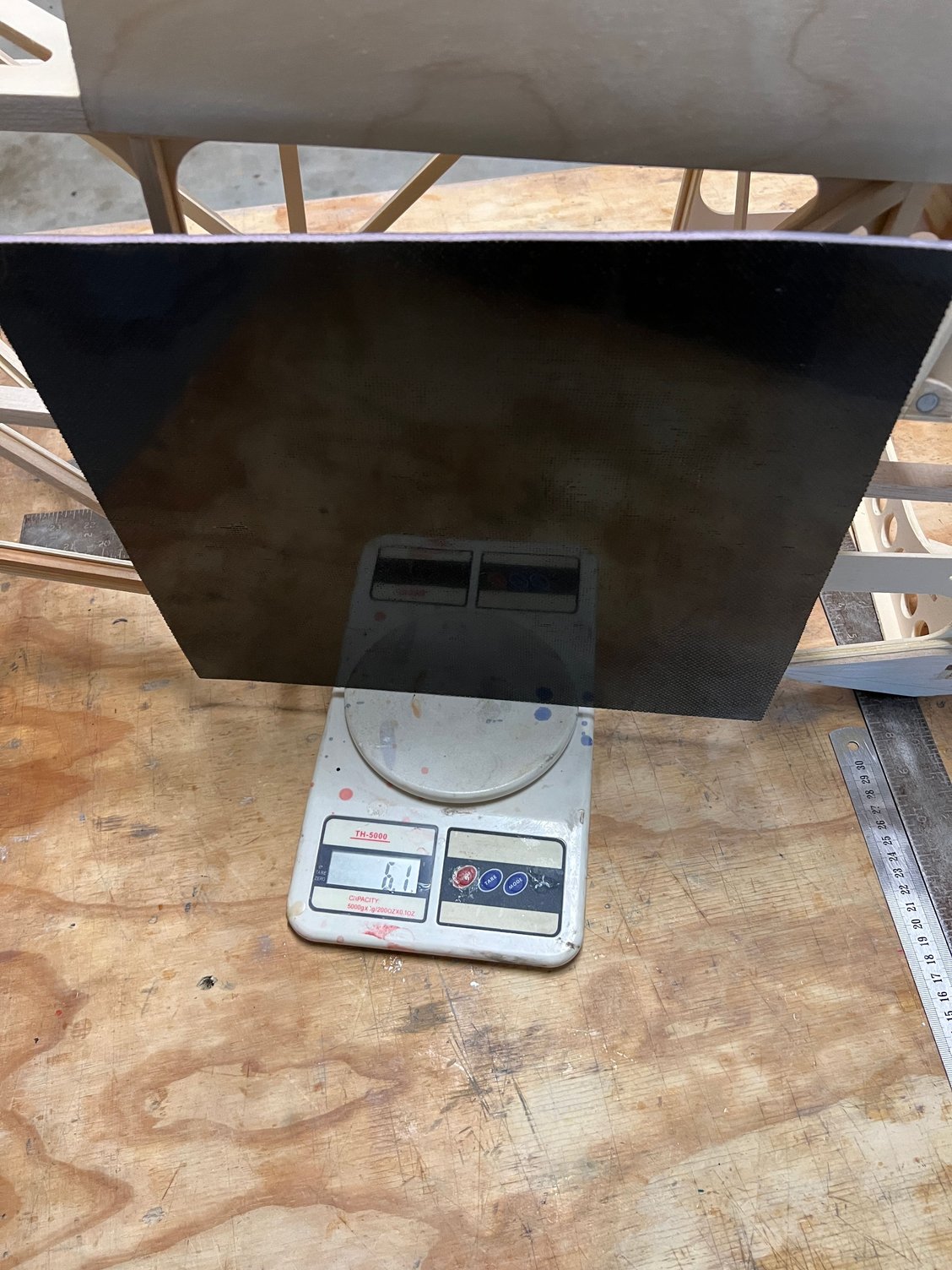

I had the PERFECT piece of floor material kicking around. I made several of these composite plates of carbon sandwiched foam a while back for another project. Strong but super light. Read the captions for further explanation. I will say this right now: this process saved me at least a half pound, maybe more. And that's weight behind the CG which I do not want.
Plate before trimming
Weight of plate after trimming
Weight of seat. This does not include substantial installation structure
Plate slides back into recepticals in back. Plate is easy to remove/install
I will cut a hole for the pilot to pass through of course.

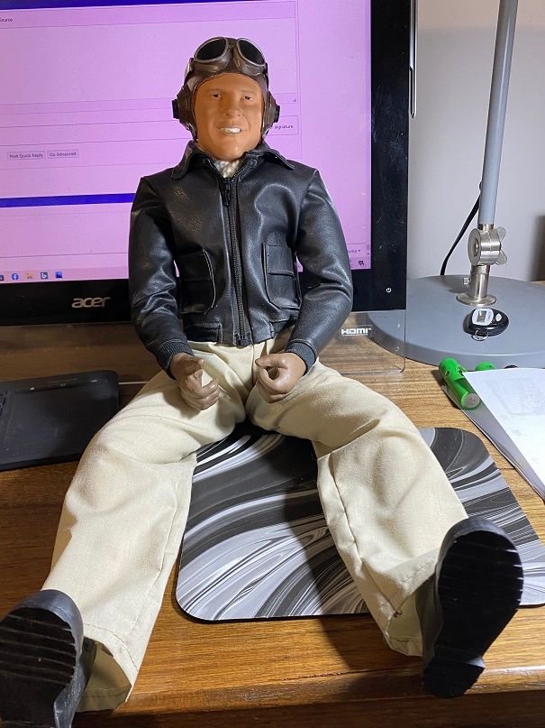

Mitch this is a pic of the pilot my wife made for the 1/3 Waco, she will be making me a 1/2 scale one for the BUCKER. If you are not going to use the seat is it the 1/2 scale one and would you be interested in selling it? if so would gladly take it off your hands.

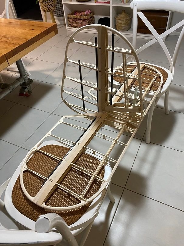

Mitch, how did you handle the cap strips? It looks like I need to sand a bevel on all of them to get them to lie on the rib without a bend at the ends..

Yep, you are doing it mostly like I did. This is a interesting part of this kit design. Not my favorite.

Yes very tedious, firstly you need to sand the bevel and when you are happy with that you then cut the strip to length, doable but a lot of them, need to listen to some music, have a coffee and try and enjoy the ride!!
Getting a bit done.

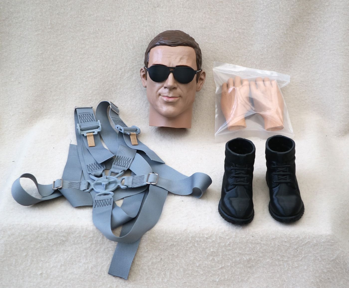

Mitch, thought you may be interested in these items in 1/2 scale that I'm getting from UK ( Tailored pilots ) My wife will do the rest. You can order one fully clothed and painted if you wish.
