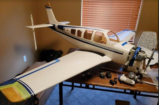

Hello, I'm getting this beautiful bird ready to maiden and wanted to know if anyone has ideas about replacing the pre-installed push rods that came with it.
Here's a look inside the fuselage I'm working with:
I've seen some M3 connectors on Amazon I'm thinking about installing with a carbon fiber rod or something:
Any ideas would be great. Thanks in advance.

For the elevator, a carbon fiber pushrod is probably a good choice. I'd recommend Central Hobbies pushrods and titanium rod ends. You could do the same for the rudder or look at a pull-pull cable set up unless your rudder only has a horn on one side. I don't think those M3 connectors are what you need. Try rod adjusters from Central Hobbies or Dubro Swivel Ball Links for the ends of rods (also available at Central Hobbies).

I managed to find an old Sullivan push rod and fabricated it to work:
Here's the trial / adjustment fit in my A36
