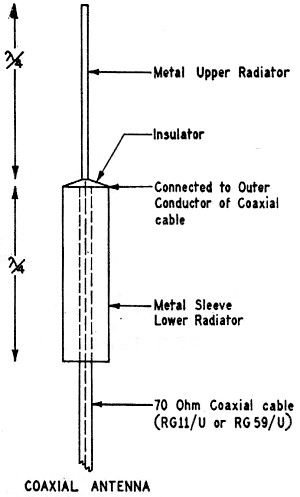

Couple of questions.
main Rx antenna wires are not at 90 degrees to each other and appears one is horizontal but curled instead of straight, the other appears to be going down, can't see if it is straight or not.
How may sats and how are the antennas orientated? Horizontal or vertical? Each sat opposing the other by 90 degrees?
What distance from the model were you when it went in? Were you pointing the Tx directly at the model?
From what I can tell with spektrum Tx they are vertically polarised.
If you were pointing the tip of the Tx antenna directly at the model that represents a null point in the radiation pattern, i.e the weakest signal being sent towards the model.
If the model setup is predominantly horizontal with antenna placement then it only receives a fraction of the signal due to polarization not being correct. Think of it like 2 pieces of 4x4 timber laid side by side, they have the maximum surface area in contact, if you rotated one 90 degrees so it was now perpendicular then it has a only a fraction of the previous surface area in contact.
See where I am going with this ?
Now if you introduce further weakening of received signal strength by introducing the null point what happens is the Rx threshold of what it can receive is reached and it goes off air and re-boots.
Of course when you check it afterwards it all works fine.
Now the spektrum Tx antenna system may have a second antenna that is in the horizontal plane, without seeing the service books I can't really tell.
It looks to be to be a 1/4 wave dipole, most like with a sleeve to improve radiation pattern.
Anyway its all speculation.
Simple 1/4 wave dipole below illustrating the radiation pattern and the null point (axis of antenna is the null).
As we are trying the impendence match the antenna to the output stage of the transmitter the engineers designing it will often use a sleeve design that matches it as close as possible. Assuming the cable from the transmitter output to the antenna is 50 ohm cable then that is the impende to match to. Remember tuning the SWR on your old CB radio setup by cutting bits off the tip if the whip antenna while watching a SWR meter and aiming to hit "1"
anyway antenna placement in our models is critical. As I am still using a JR 12X it uses a folding antenna which I orientate horizontal to the ground. Mt main Rx is in the horizontal which the whiskers at 90 degrees to each other, I will have normally 3 sats, 2 of which will be horizontal but 90- degrees opposed, third will be vertical. If I have a 4th sat then it is at 45 degrees to the vertical one.
