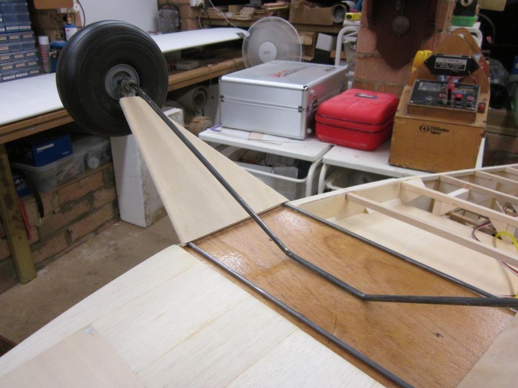

Hi Reuben,

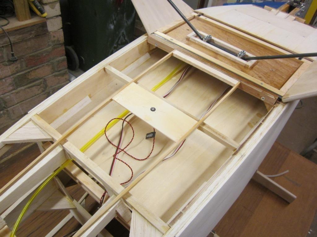

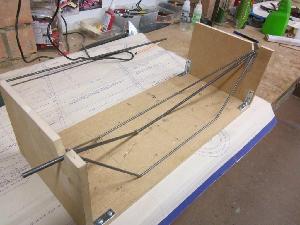

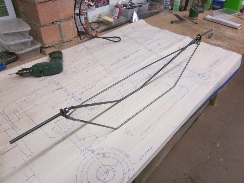

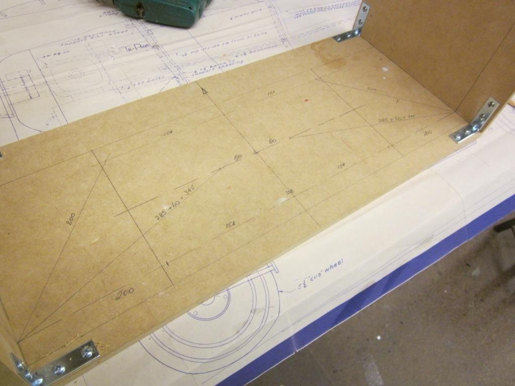

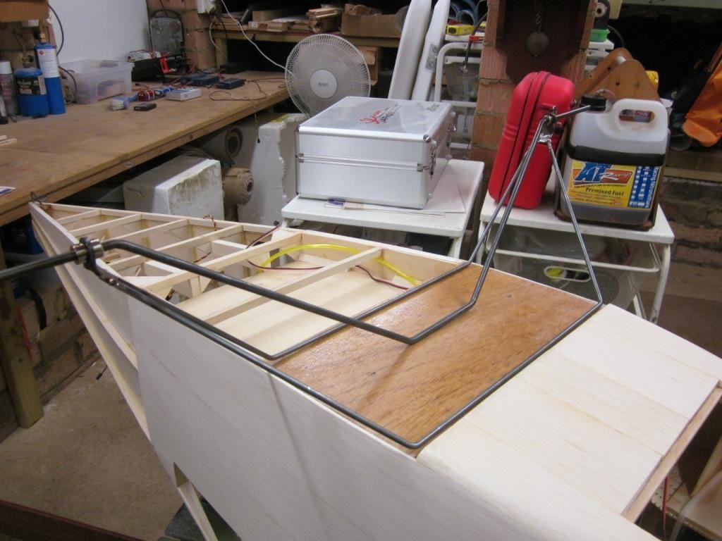

I have shared your wish that i could have bought the main undercarriage for the TriPacer but as far as I know nobody makes them so I had to make my own.
The key is to have access to a K&S heavy duty wire bender and to make up a jig so you can accurately measure the lengths between each bend and of course you will need to be able to silver solder.
It may sound intimidating but once you get into it it isnt that bad.
I made the front and rear wires that make up the legs out of 3/16" dia wire and silver soldered them to steel plates at the convergence through which I had the 1/4" dia axle wire. Either side of the steel plates I used 1/4" colletts to stop the U/C spreading on landing.
I made a frame around the U/C and epoxied it in place with a couple of wire clamps on the 1/4" axle wire. The frame also allowed me to cover with Solartex when the time came..
I didn't get the bending bit right first up but as I suspected it might be a bit trial and error I had bought plenty of piano wire..
It's a bit blacksmithy but I've had many landings now with no trouble at all.
Good luck
Stan

Hello Stan,

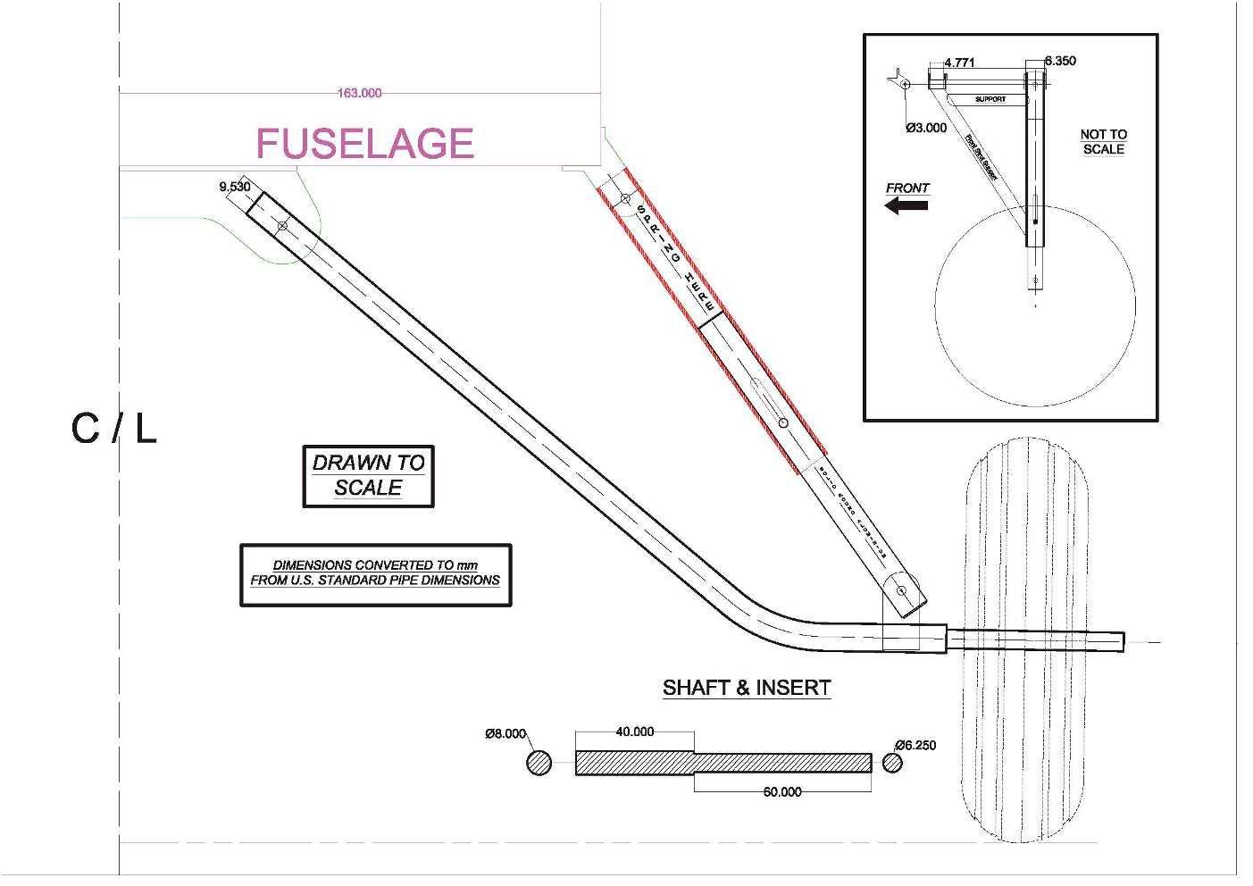

Thanks for your feedback. The landing gear is nicely made. What I had in mind is to make an oleo type. I am using stainless steel pipes (aircraft grade) but I need to TIG weld the parts but unfortunately a friend of mine who was supposed to be making the tig welding has been indisposed for quite a while. So I am looking at alternatives before I start the whole project. Anyway this is what I had in mind.
Again, Stan...thanks.
Reuben

Google "RCM 1/3 scale Champ", you will find landing gear made very similar to your drawing. I used silver braze and a propane torch for the joints.

Hi Tony, thanks for your feedback. Will silver brazing hold on if one is brazing stainless steel and mild steel (lugs)? Meanwhile I'll check the Champ. Thanks again.

yes it requires a different flux.
