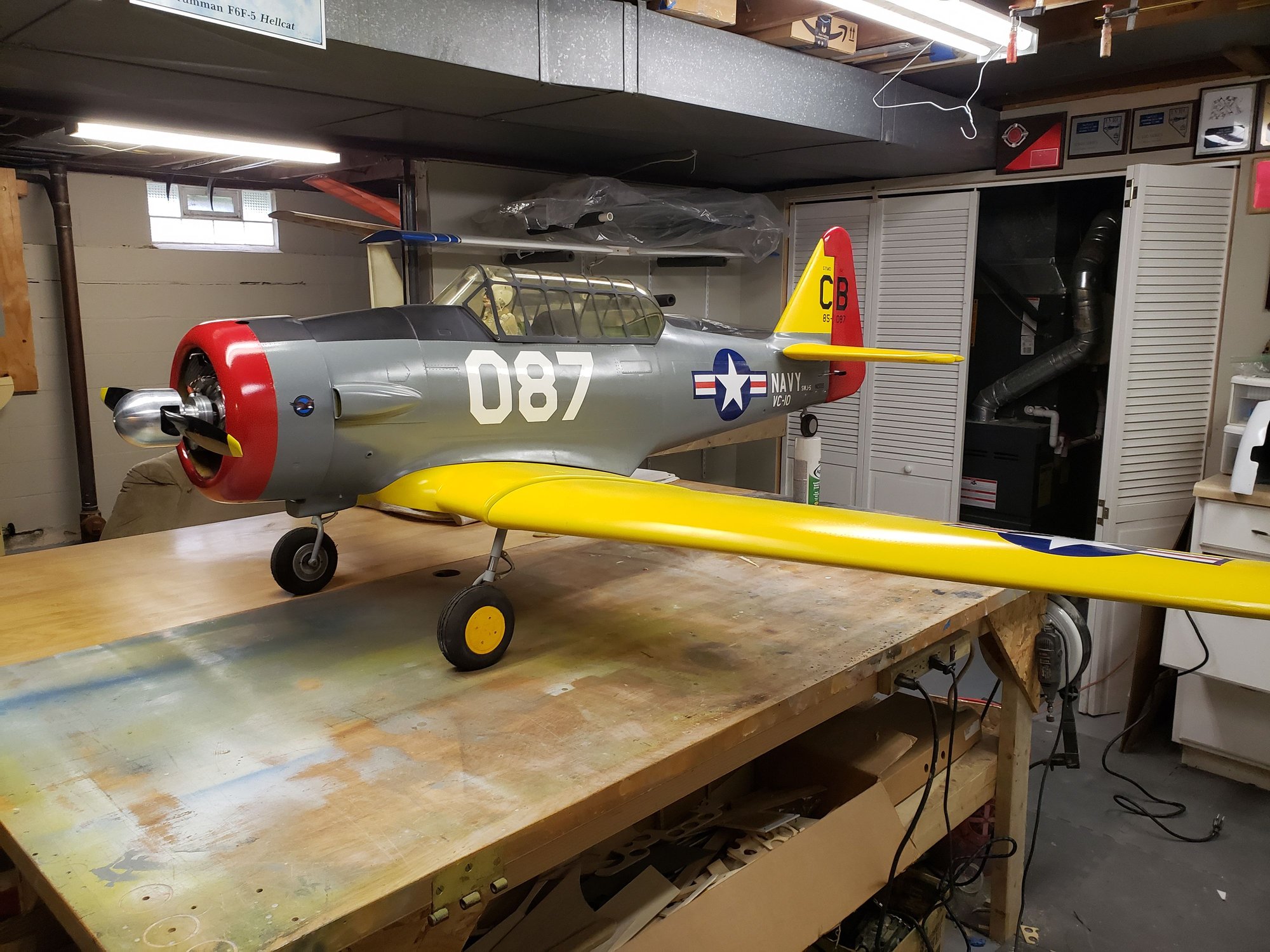

I'm curious,, how much time was on the g-62? Did you think it was pull as hard as it should?
I have a brand new one on my at-6 that still needs some breaking in,, it flew the 37lbs beast,, but not very fast,, hoping it's going to come alive and pull with more authority
I think re-schemeing my P-51 is next after I finish my Mig-3 project
