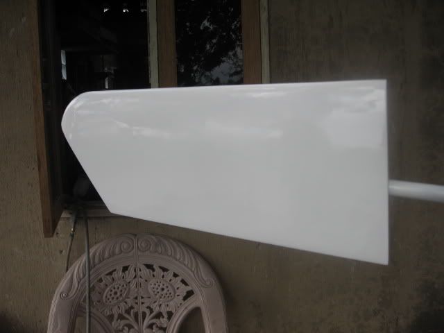

hi,
i'm one of the aeromodelling pilot who really fall in love with the cessna 185. i live in indonesia, and last year i found out a friend who can built me a cessna 185. the project was started at August 2008 and still on progress.
here's some picture of our cessna 185.
pre mastering.
building up the detail.
finished the tail wing.
my Cessna 185 will be look just like the MAF (Mission Aviation Fellowship) registration number PK-MCB (this plane still in service until now since mid 60's)
i hope to hear from you soon about your new cessna.

Hi Fellows;
Welcome "flytosky" nice to see your model of the C-185. Looks great. Also looks like your friend has done a nice job with the molds on the fuselage and cowling. Certainly looks like a C-185. Nice detailing with the panel lines.
What size is the model and what is the wingspan.
What engine will you be using. Will it be flown on floats.
Keep us updated on your progress.

Hi again,
thank you steve and randy for the suggestion. my plane will be the first prototype. they never make one before. so everything is still based on calculation.
anyway, how much does the Tommy's cessna cost? mine is Rp. 5.000.000 or US$ 420 for kit only included the spinner and lights / strobe. i haven't purchase an engine yet. but i think i'll get DL 50cc gas engine. is it a standard one?
here's the updated pics.
