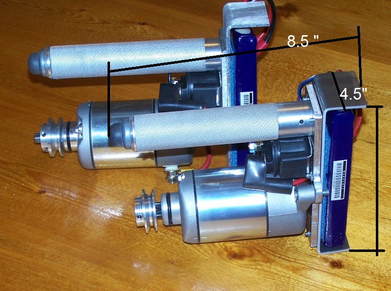

moparbarn 04-21-2015 04:38 PM
Another possibility to try
1 Attachment(s)
You might contact Boris Major at [email protected]. He makes a lipo powered starter for rc boats based on a Honda ATV starter. 3S @ 11.4 volts will start 52 cc gasoline inline twins. You can use 4S, if needed. The handle would need reconfigured to be both safe & practical for airplane use. He makes a piece to use either belt or cone start. He is a very interesting Russian man, & loves to invent useful tools for our hobbies. Worth a try, he would enjoy helping ya'll! I have one of the starters shown, awesome product, IMHO.http://www.rcuniverse.com/forum/atta...mentid=2090984

rtstestpilot 04-21-2015 07:04 PM
Hello moparbarn,
I just may contact Mr. Major for a chat. My driver drill easily starts my 62cc engines and I'm confident that it will start up to 100cc but I'm needing a much more powerful starter for the large engines. I'm thinking about using a gear reduced automotive starter and basically doing the same thing that Boris is doing.[
Todd
