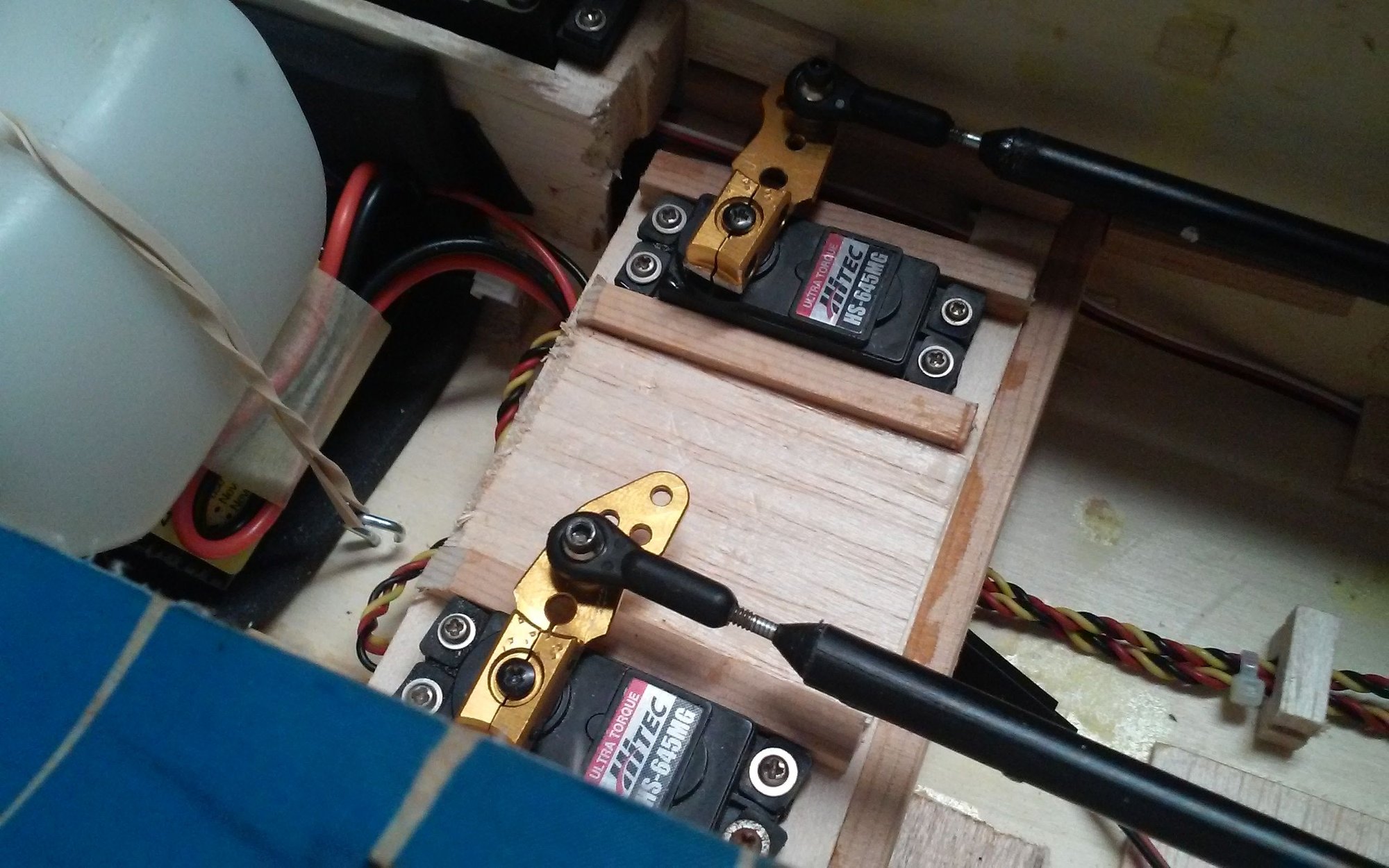

Hey guys and gals
wish me luck on my upcoming maiden flight...also, I'm not very up to speed on using this web site. I start in Forums and search down page to find Glow engines,then down to Evolution then go to page 99.
Is there a short cut ? And I would like to post some pictures of plane but don't know how .....can you help me out ?
Inside of my stearman....
