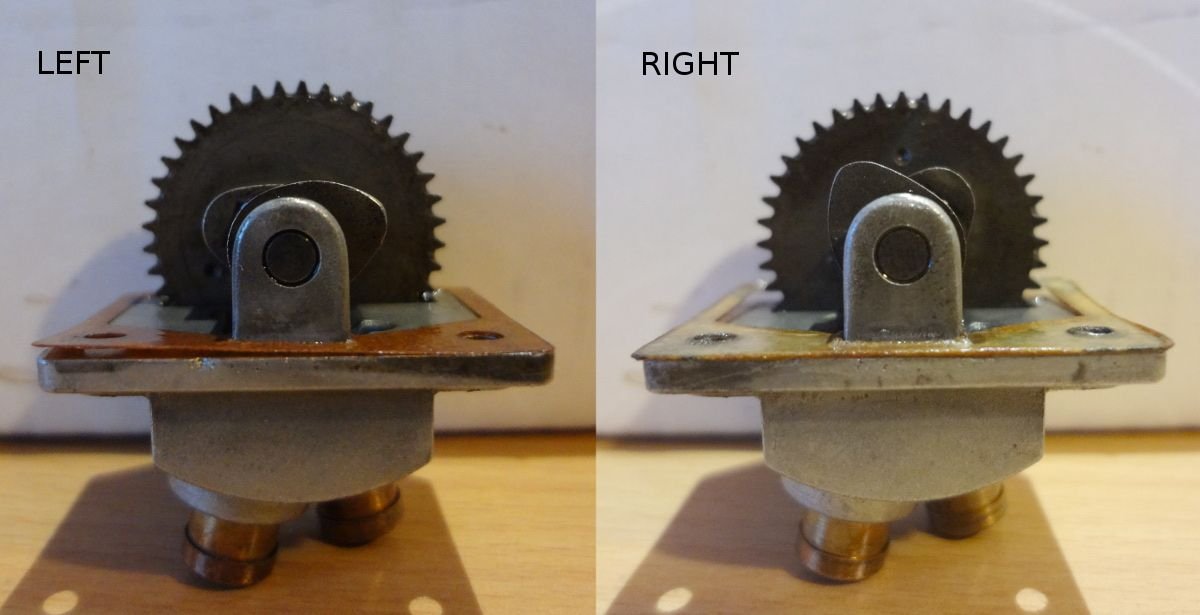

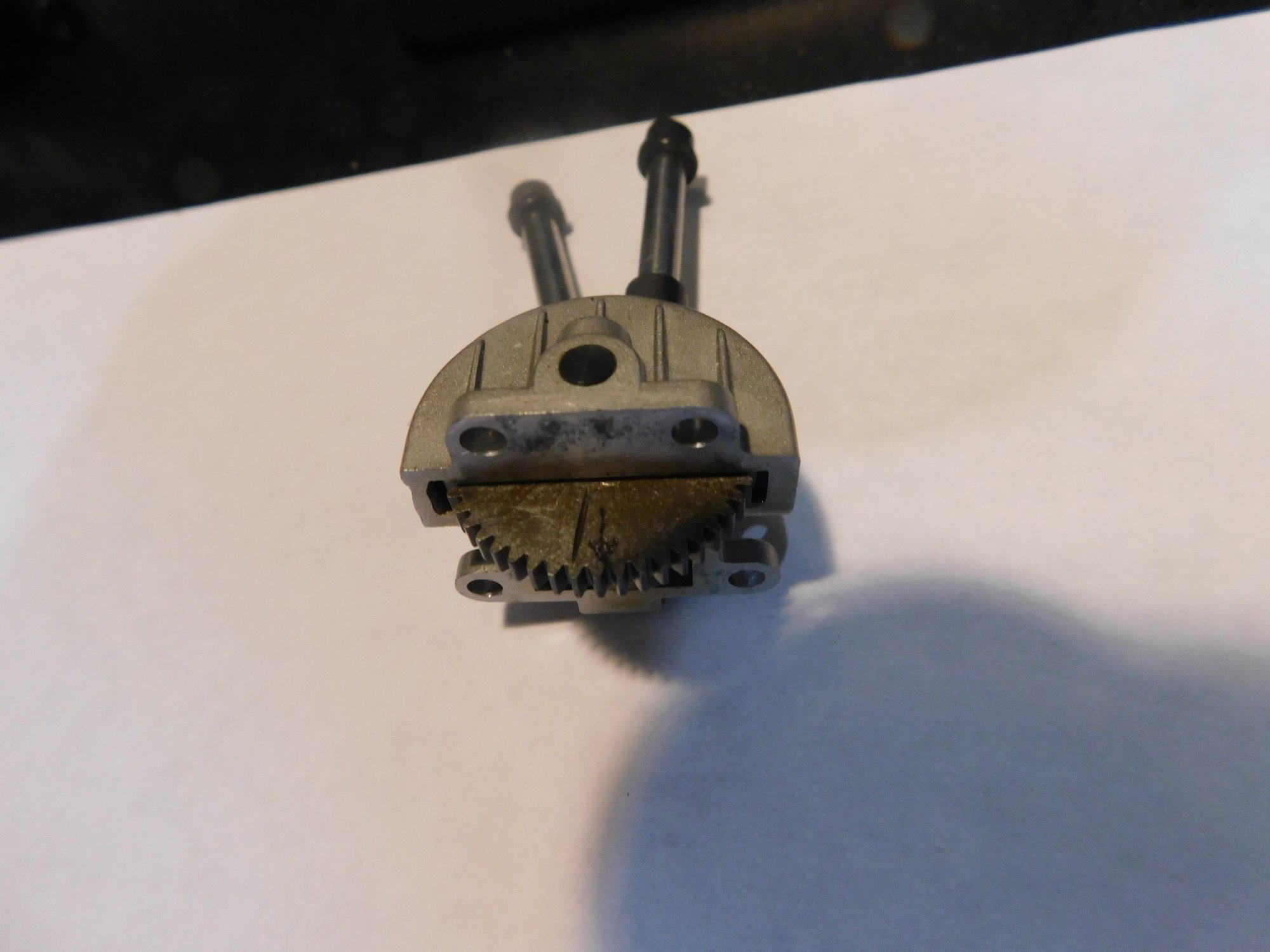

I was talking to a guy at the field that had a one tooth timing difference with a Saito twin that meant all the difference. I really hope to stay away from that kind of troubleshooting issue. I'll try everything else first.
Be careful when turning the engine over, the one I have on the bench (270 twin) for a friend had 2 broken rocker arm mounts due to valves being stuck. Someone turned the engine over and "SNAP" they went. Yes the cam timing is an issue IF the covers are removed. I had to remove them to clean the lifters and bores (gummed up bad). Horizon has a down loadable manual for the 300 (applies to the 270 as well).

There is quite a difference between the right and left cams. Here is a review by Clarence Lee: Saito FA-270T
The left cam has a hash mark for timing, I don't know why this one also has the arrow.

You don't want the left cam on the right hand cylinder. (For the reason you noted)
The problem is, most folks get a cam off by 180 degrees. I have personally corrected that error three times.
