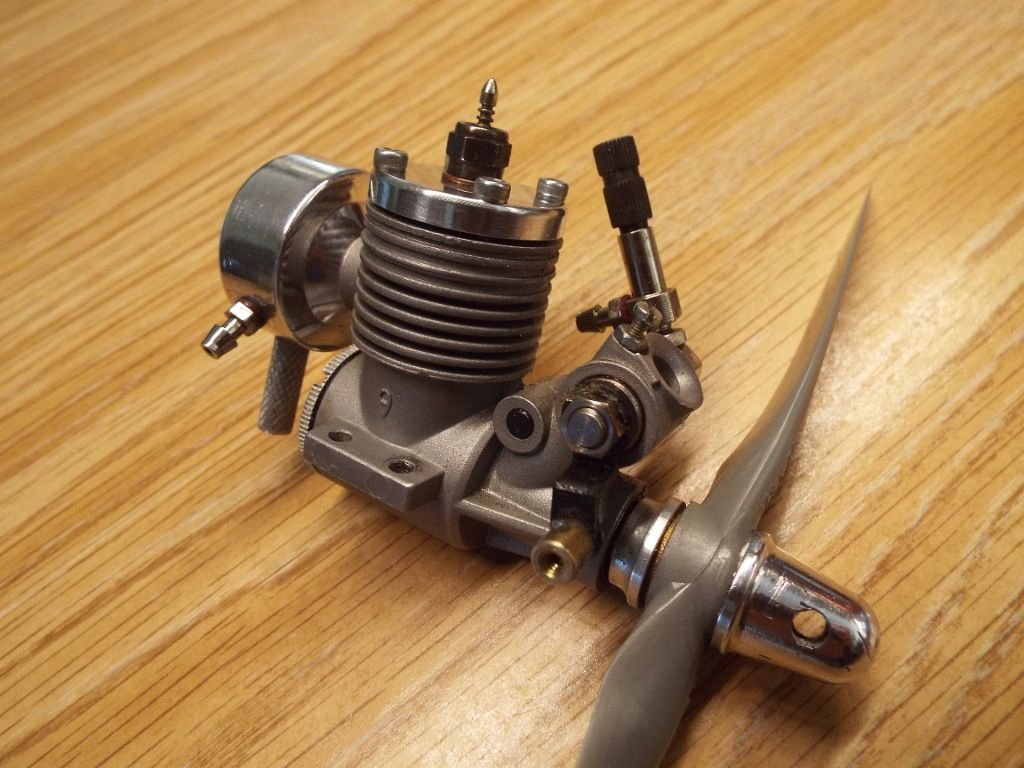

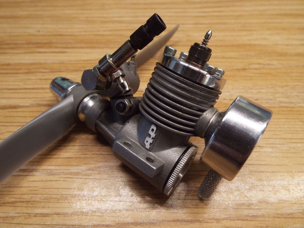

Got this one for a song, surprised that no one else bid with me on it. Was frozen by dried Castor, but a little gentle persuasion after oiling with 5-30W motor oil, got the crank and carb barrel freed, now turns freely. Missing the needle ratchet, but I plan to fix that with fuel line and wire tie to provide needle resistance. A little Mothers Mag & Aluminum Polish cleaned up the scratches on the bare machined aluminum surfaces. It is used but not abused.

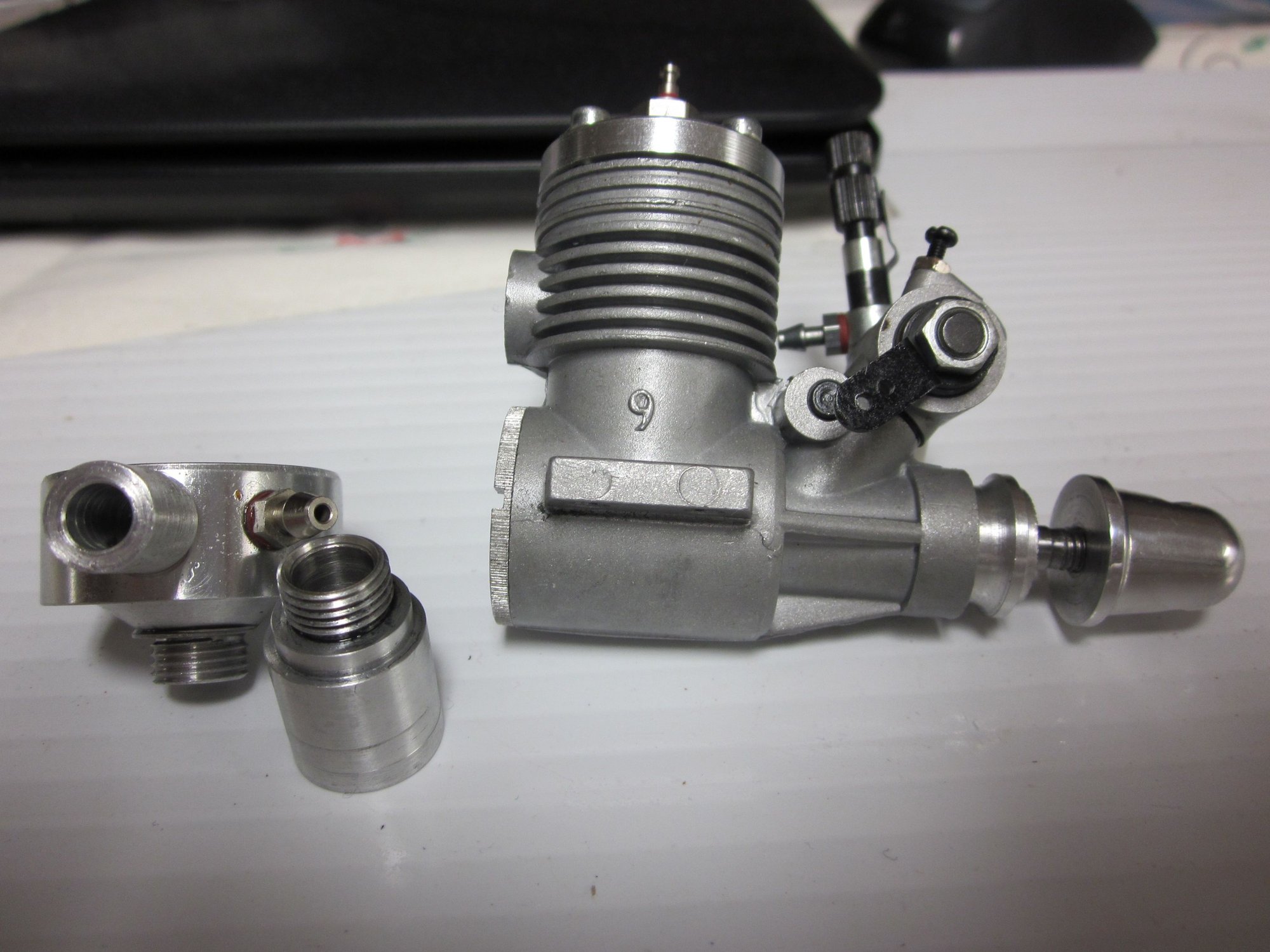

Some pics in case some have not seen them before. The one shows the bigger stinger and it also has the next bigger size drill right at the exhaust port. There is a 10mm x 1mm threaded outlet that I made to use a pipe, or mousse can. At some point I though of raising the exhaust port to 180 degrees to make a pipe work well, but really it seems like something for the future. My .15 AP rod did not seem to like the revs at 25,000 rpms which is where the pipes like to run. I would like to note that it was running at 24,500 on an F2D prop which is really "only" 5,000 rpm less than a $250 Fora.
The middle part is the header for a pipe. The left part is the stinger with the larger hole. It is easier to just remove the stinger and drill a 6mm hole. If your field allows it, no muffler is better yet.

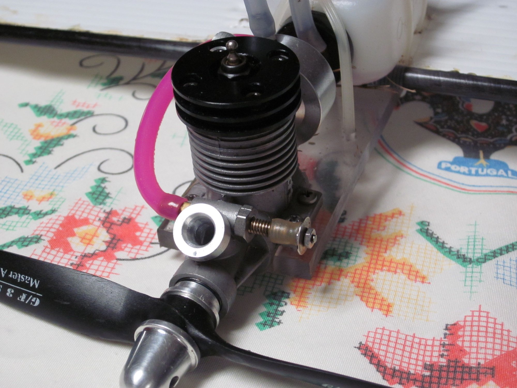

Control line venturi and needle valve on the .15. A bit over 5mm bore. It needs muffler pressure or bladder feed.

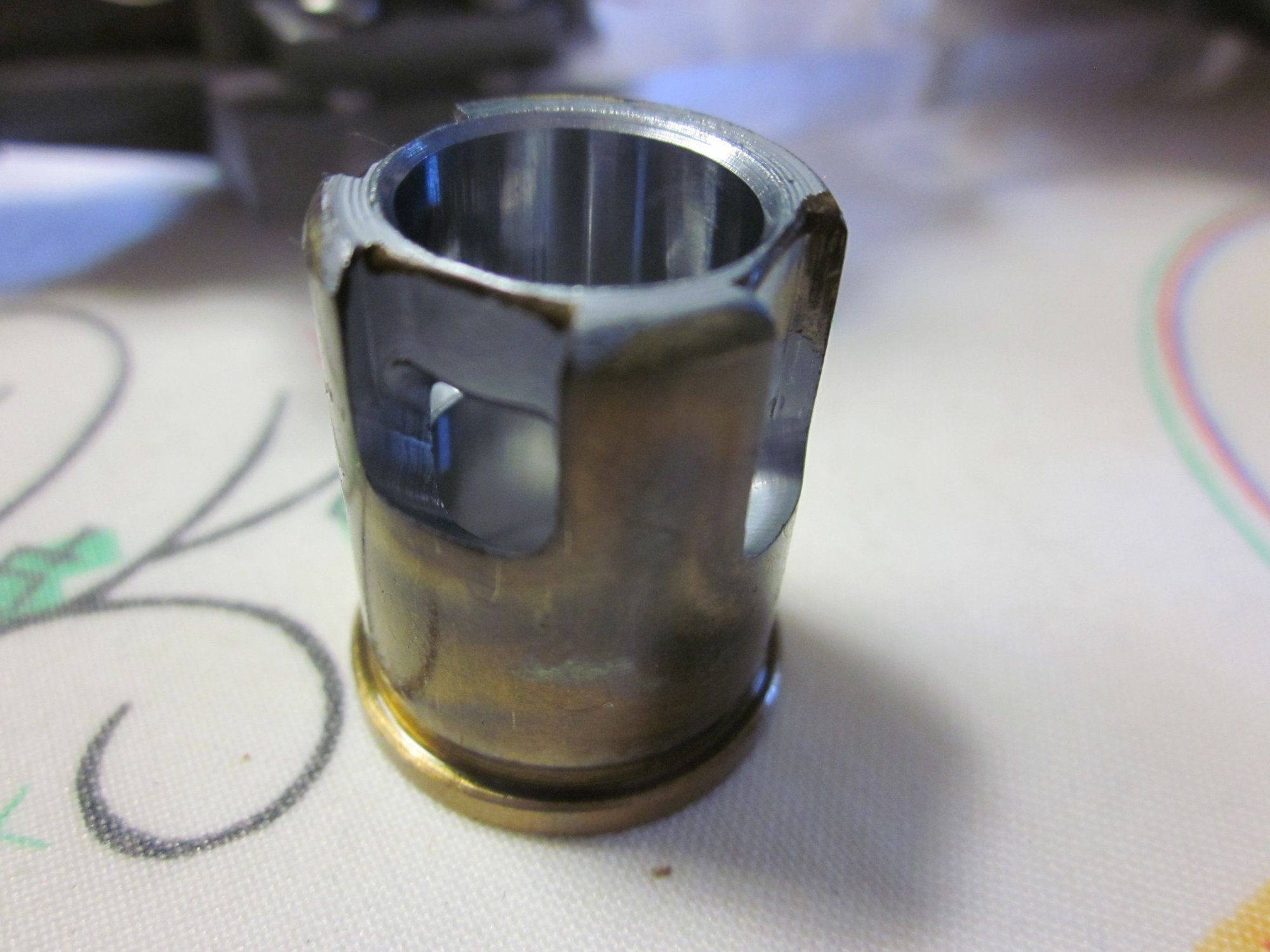

The .09 sleeve. The .15 sleeve has the the bypass slots cut all the way through to the piston, which is a much bigger diameter.

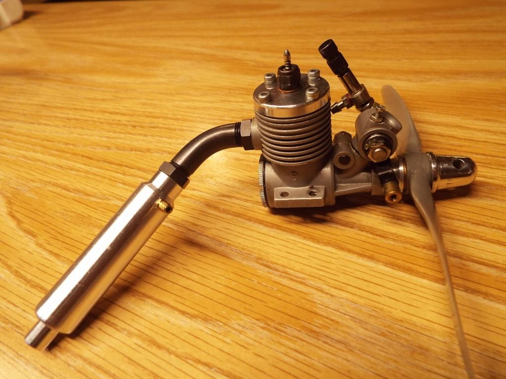

1QwkSport2.5r, did you modify your OS .10 FP with the Duratrax car engine P/L yet? Followed Brad from Texas suggestion, I bought a curved 10mm header and muffler for a Saito 4 cycle, Saito AP SAI7274CL.
AP SAI7274CL mounted to the Sanye AP .09 R/C
This should overcome problems with the more restrictive OEM muffler.

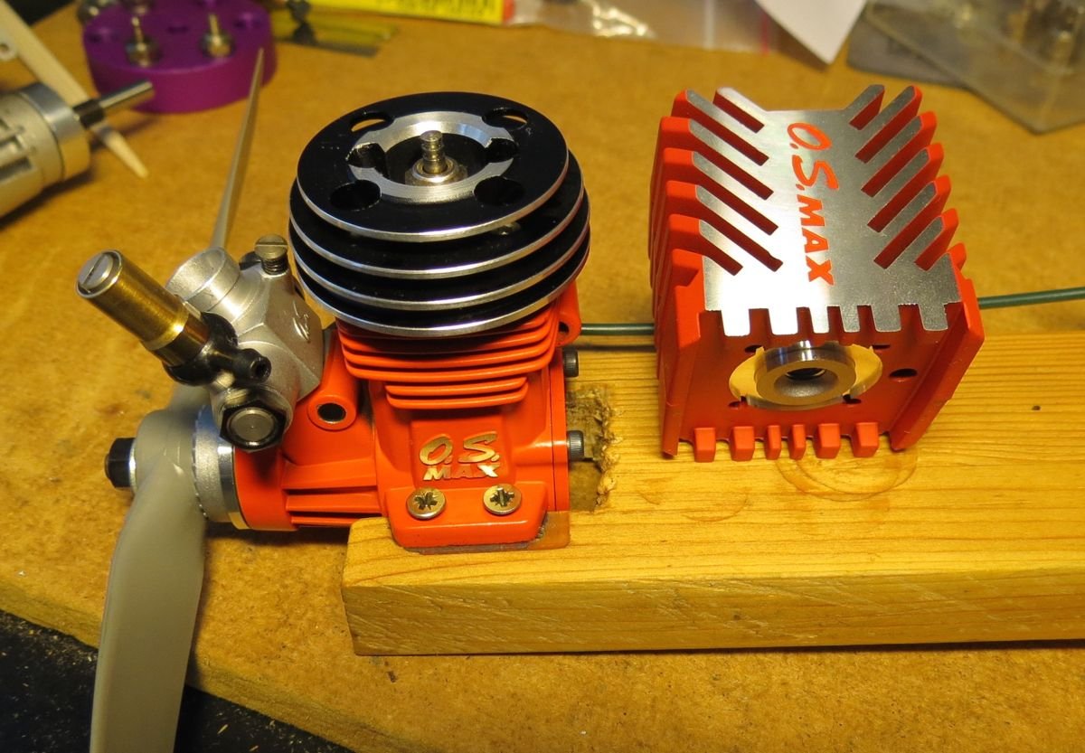

From OS there are better car engines to work with I think than the .10FP if one want to to push the limits. A true ABC liner would be great to have though.
When I have compared the liner outer diameter to other engines I did not find a match. The OS used fractional mm I think while most others are not (will have to check my notes on that though). One could then use a lathe to change the liner or a drill press to change the crankcase, but either operation is a little risky.
The OS .12CV for instance is promising and easy to convert (but still ABN). I guess the crank and crankcase are the same as they used on their .15CV but their are hard to find these days.
Here is a short bench run of a .12CV that I have "converted" by making a Turbo plug head, in a button and camp style. The carb is the stock one and the engine is on pair with the ASP .15XLS on an APC 7x4 prop. Unfortunately the total weights are rather similar too though...
http://www.youtube.com/watch?v=SqzVLakeXPs
