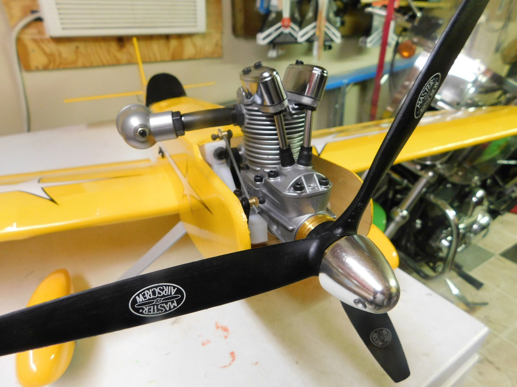

Saito 62 on a SIg Four Star.
Two Saito 62's would be perfect, the numbers are not as lop sided as that in this day and age, so even Saito 56's would do the job but hard to get. OS 56 Alpha's would cost way more.

Originally Posted by Hobbsy View Post
saito_62_on_sig_four_star
wow GREAT image
