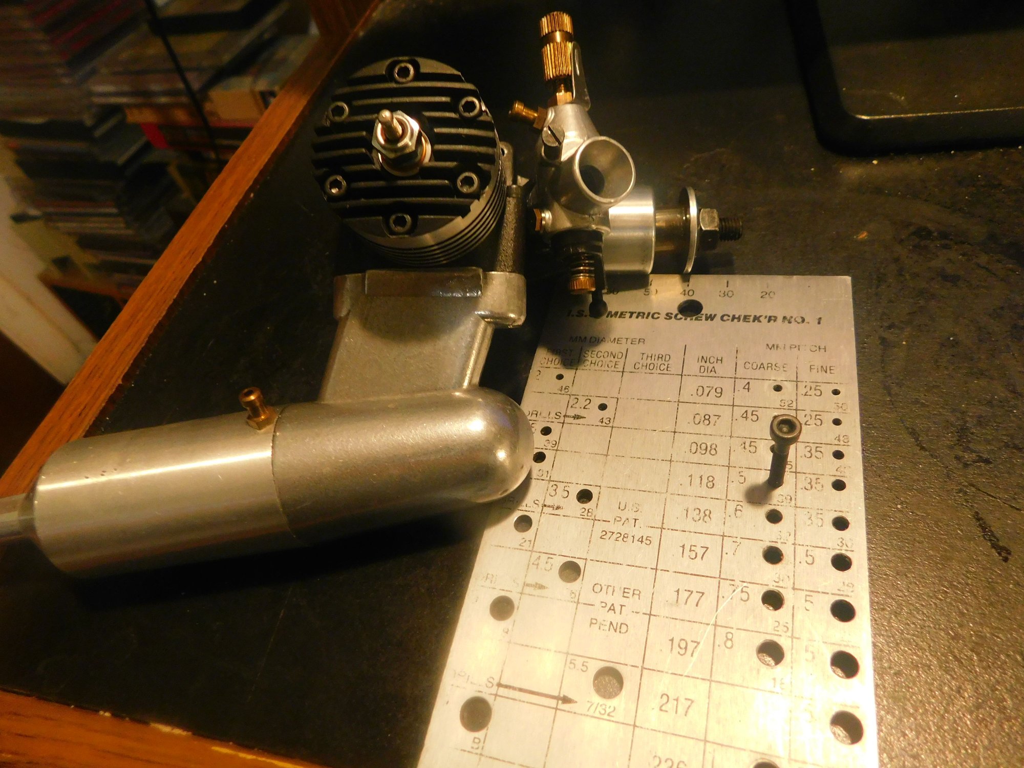

I have a Merco 61 Mk IV - can anyone tell me the thread size for the muffler bolts please?

I will check my Merco 61 after while, I think they are 2.5 mm.

Thank you, appreciated, I think it is more likely to be imperial as it is from before metrification was introduced in the UK

This is a brand new un-run MERCO 40, the muffler bolts are m-3 x .5 x 25 mm. According to the Micro Mark Screw Chek'r.
