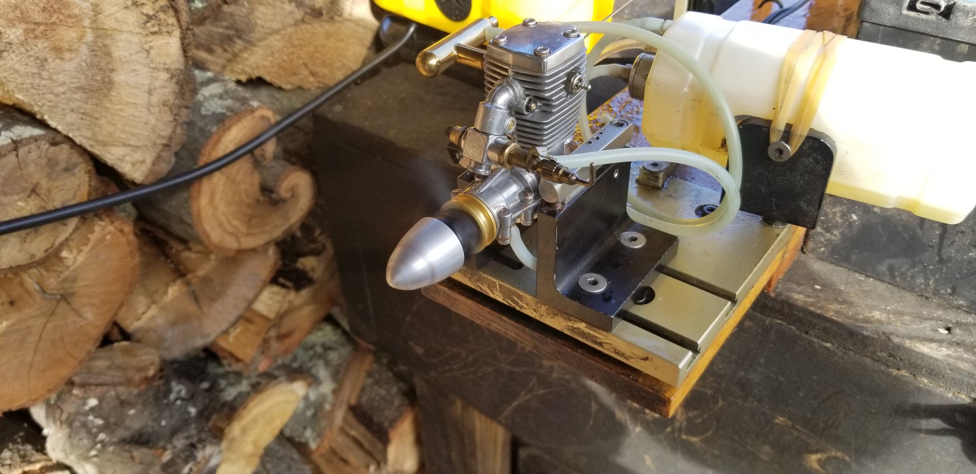

I received an HP 25 from MECOA today, it did not have an O-ring between the carb and the carb mount, it has one now. It came in a very nice box, well package for the trip. The muffler is plumbed exactly as the instructions show. The prop is a Xoar 9 x 6, it should be just about right. I'll experiment with a 10 x 5 also. The fuel will be Wildcat 2-4 10% with 18% full synthetic. The plug is a Glo-Devil 4c Special made for Saito and Enya.

HP 25 rotary valve four stroke
Fuel===Wildcat 10% with 18% full synthetic
Plug===Glo-Devil 4 c Special for Saito and Enya
Exhaust=Stock
Prop #1=HY 9 x 6 rpm===10,300 HY, took over Bolly props.
Prop #2=Xoar 9 x 6 rpm==10,470
Prop #3=Xoar 10 x 5 rpm==9,020
Idle, so far 2,800, very nice though.That is a 14 oz tank, it took an hour to take it down to the top of the tank bracket.
HP 25 wearing HY 9 x 6
HP 25 with HY 9 x 6 rpm
HP 25 with Xoar 9 x 6
