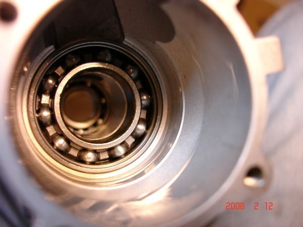

Hi all,

The rear, larger bearing bears the primary thrust load , it isthe tighter of the two on the outside race.
The front bearing outer moves more freely in the bore to allow for expansion.

Sorry Jaka but yes, the outer race may and does indeed float axially within it's bore by design.

A common misperception is that the front bearing floats to accommodate the thermal expansion differences between the aluminum case and steel crankshaft. This is totally untrue! The outer races of both front and rear bearings stay put in their bores as the engine heats and cools.
In a properly assembled engine there is a small clearance between the rear bearing and the crankshaft counterweight which accommodates thermal expansion. The case expands more than the crank and as it does the rear bearing moves rearward taking up some of that clearance. Remember, the front and rear bearings are a press fit into the case but are a slip fit on the crank at operating temp; in the case of the rear bearing this is why, to allow for movement rearward. I've measured several engines, cold and hot to verify the clearance exists, and narrows, as the engine temp increases so it is not theory, it's how it works.

By design and intent the outer race of the lightly loaded front bearing does indeed float.
That some folks get away with defeating that design element with epoxy or Loctite changes nothing. It is exactly what the bearing makers specify for the application.
In a "properly assembled" engine;
The rear bearing race should always bear on the bottom of the bore. The front face of the crank, directly against the bearing inner race. The primary thrust load is taken properly on the larger, rear bearing by design. The relationship of the crankpin, rod and piston more constant.
That is by design, as learned in "Anti friction bearings 101"
Any gap between the the front of crank shoulder and the larger rear bearing would improperly transfer thrust loads to the smaller, front bearing. Not a good condition.
No misconception here. The engine makers got it right by listening to the bearing makers.

Of course the bearings must be fully seating in their bores during assembly. No argument there.
The small .006-.009" clearance between the rear bearing and crank shoulder is minimal, not enough to cause any problems on cold start and The clearance closes down to less than ,004" on a heated engine. I've measured the clearances and done the math, as you know from a previous debate on the subject and the numbers don't lie. The front bearing does not move to accomodate thermal expansion, at least not measurably.

If the crankshaft/nose of the case is getting hotter than normal after disassembly/reassembly it's likely due to castor or corrosion buildup at the rear bearing area of the crank. That buildup can resist the needed movement of the crank through the rear bearing inner race as the engine heats up and can cause excessive rearward pulling pressures on the front bearing. When all cleaned up the rear bearing should slip fit onto the crank, a very light interference fit is ok too. Magically your hot front bearing problem will disappear.
In addition: Make sure both front and rear bearings are fully seated in clean bores.

Thanks for the feedback. Conflicting advice as always, but that might be good and create a good debate If I remembered correctly, I had to tap the crankshaft back in place. There was probably more than a light interference fit there.
I have recently done another OS FS70 (engine #2) , exact same engine I had laying around. This engine had a tighter fit on the front bearing towards the casing, and the crank slipped right in. I think everything is as it should on this one.
So, next reasonable step would be to pull the crankshaft out of engine #1 and to a cleanup. and inspection, then bench test it and observe for temperature build ups around the front bearing.

I have run into rear bearing/crankshaft fits that were too tight, namely on an OS fs70, an OS fs91 and on a YS91AC/FZ. In those cases the front bearing got hot. In the case of the YS the front bearing got so hot that it spun the front bearing in the housing. Lessons learned on how important the rear bearing/crankshaft fit is. The rear bearing must be able to slide on the crank when at operating temp.
How much interference fit between the rear bearing and crank is acceptable at room temp is not something I can answer by theory. All I know is that generally, under load, the inner ring of a bearing heats to a higher temp than its accompanying shaft and therefore the interference fit between the two will decrease; making it easier for the bearing to slide on the shaft.
With clean parts test fit the rear bearing on the crank at room temp to make sure the bearing will either slip fit or lightly interference fit the crank before assembly. The bearing should slide on to within an 1/8" or so of the crank counter weight (shoulder) without much pressure. Fully seat the front and rear bearings in a hot crankcase, allow to cool to room temp and then slide the crank in as far as possible using your thumbs. Mount the prop hub, prop, washer, nut and tighten the prop. The prop should turn freely without resistance. If it feels stiff or notchy there's too much interference between the inner race of the rear bearing and crankshaft or your bearings are not fully seated in clean bores.
FYI, in the engine examples I noted I had to chuck up the crankshafts in a lathe and sand/polish them down for less interference fit.

I have now taken the #1 .70 surpass apart. I had to tap the Crankshaft out of the crankcase, so it had definitely a tight fit towards the rear bearing. I put the crankshaft in a drill and gently polished the rear bearing surface with some scotch brite. The crankshaft did now slip into the bearings with my thumb the same way as it did on the #2 .70 surpass and another OS 46FX I recently replaced bearings on. I am of the impression that the fit should be like this, regardless that it is not according to standard industrial practice mentioned above. After putting the propeller on, there is a nearly not noticeable axial play in the crankshaft, probably its the internal play in the front bearing I am feeling. Turns around smoothly and freely now. There was a very slight resistance after the first assembly, probably due to the axial load between the two bearings as the crankshaft sat in both bearing bores.
Next step is to remove the valves, clean them up and give them a gently lap with some metal polish before everything goes back together. Crossing fingers that all will be good now.
