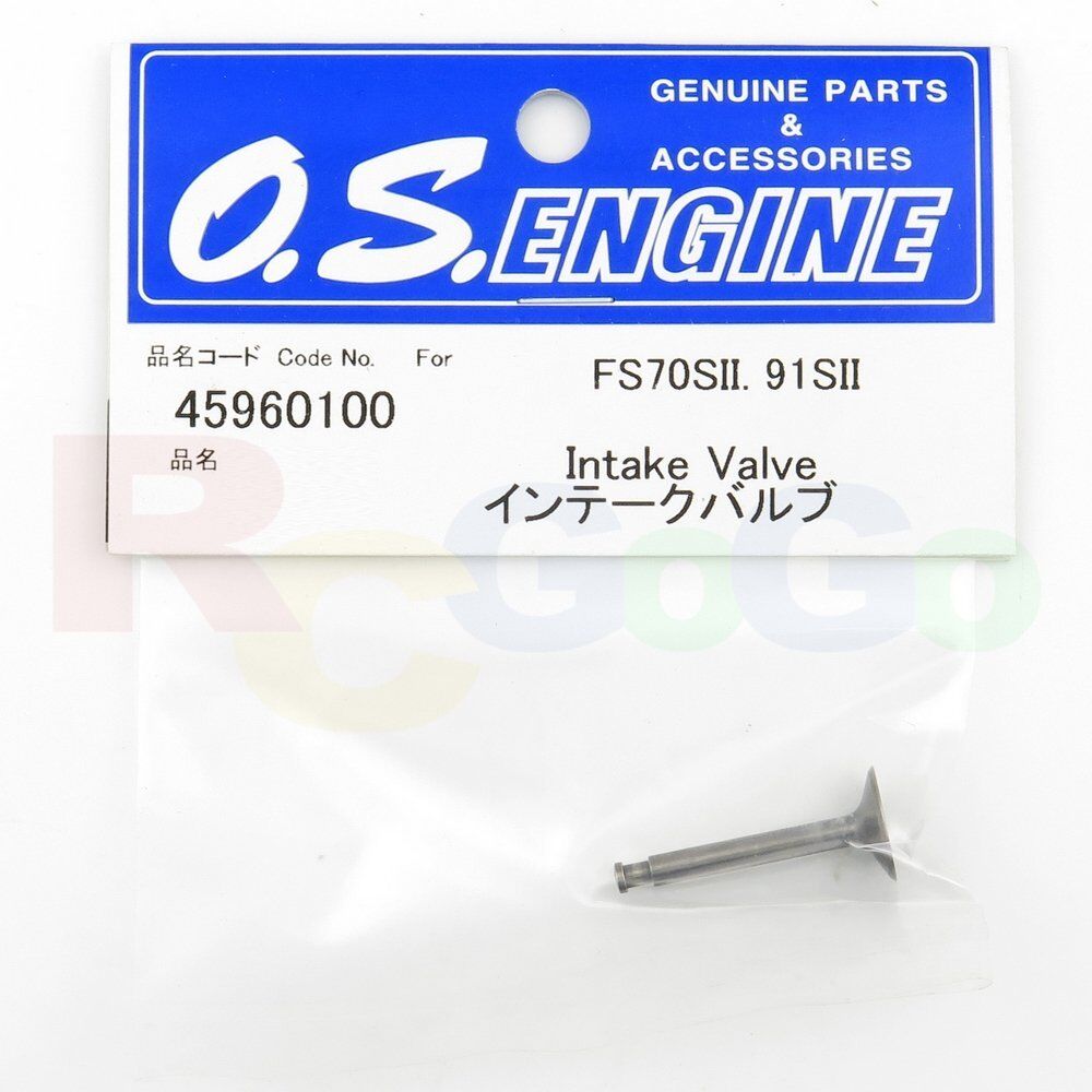

New valves might be an option. Trying to find replacements, but this is an old engine. I have found valves for the FS70SII, but not the first one. They might be the same but the part list in my manual only shows part no for the "valve assembly" which not match. Its the same valves for the FS70SI as for the FS91SI
Manual shows:
45960000 - Intake valve assembly
45960010 - Exhaust valve assembly
Can not find these available. on the other hand, I can find available:
45960100 - Intake valve for OS FS70/90SII
45960110 - Exhaust valve for OS FS70/90SII
It might be the same for the SI , but need to get this verified. Anyone knows?
Manual shows:
Seems like the SI and SII shares the exhaust valve:
Not sure about the intake...
