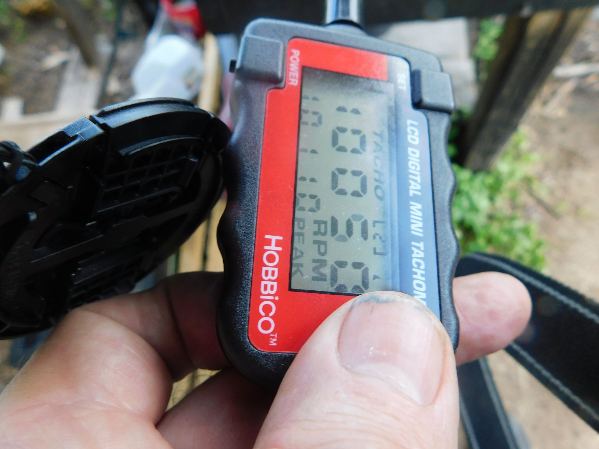

Well Dave, those 12x7 numbers on the FG11 piqued my curiosity and benchmarked at 8800 with a 13x7? Here I thought the FG11 was just a gasser 62b, not so. A little research showed it's actually a .67 cubic inch engine; a 45s/50/56/62 19mm stroke and a 72/80 27mm bore. Apparently that's just enough increase in displacement, along with cdi, to offset the weaker energy density of gasoline vs. methanol.
Are there any concerns with valve seats burning using gas in an engine head originally designed for alcohol ie fa200r3? Gas combustion does produce quite a bit higher exhaust gas temps than alcohol based fuels. Saito claims the FG21 has newly designed valve seats, no mention of that with the smaller gassers. Anyone ever have a look inside a saito gasser?
Saito knows what they're doing, no doubt, I'm just curious what the newly designed valve seats are all about and why they redesigned.
