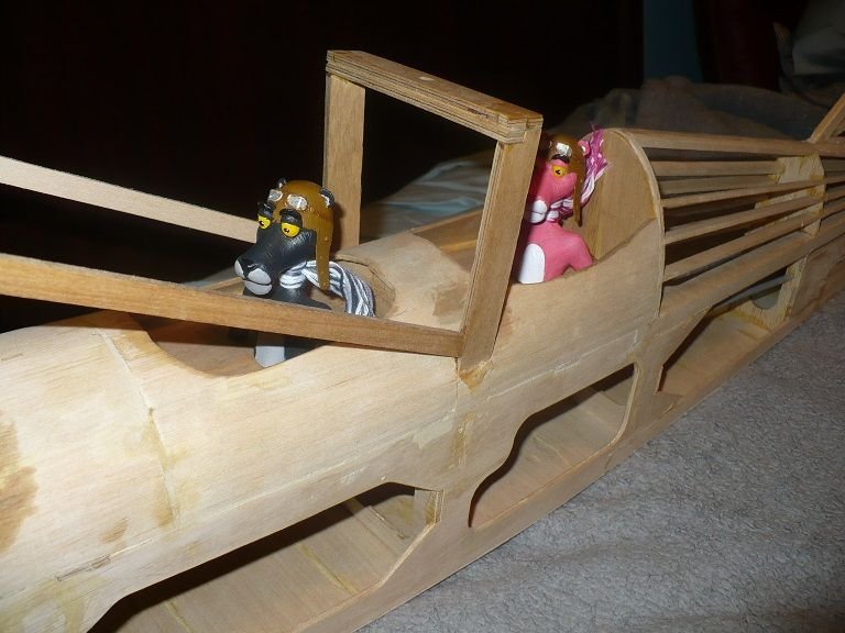

I am pleased to announce my flight crew has arrived! A couple of photos for your viewing pleasure. Its weird though every time I turned my back I swore I heard someone making airplane noises.

the viewing pleasure
them there are some super nice flyers there, just don't stick your finger in the cockpit, it may get bit
