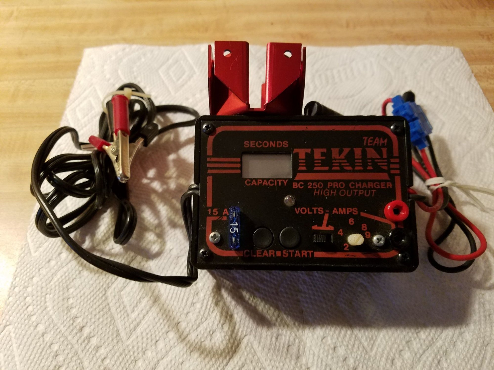

hey, I have an old Tekin BC250 SCR 9 Amp Charger, bought in 1988 for buggy racing. it will put out 10 Amps if the Chevy's engine is running. that would charge a 1200 SCR in about 10 minutes if the Chevy engine is running LOL
it's a beauty,

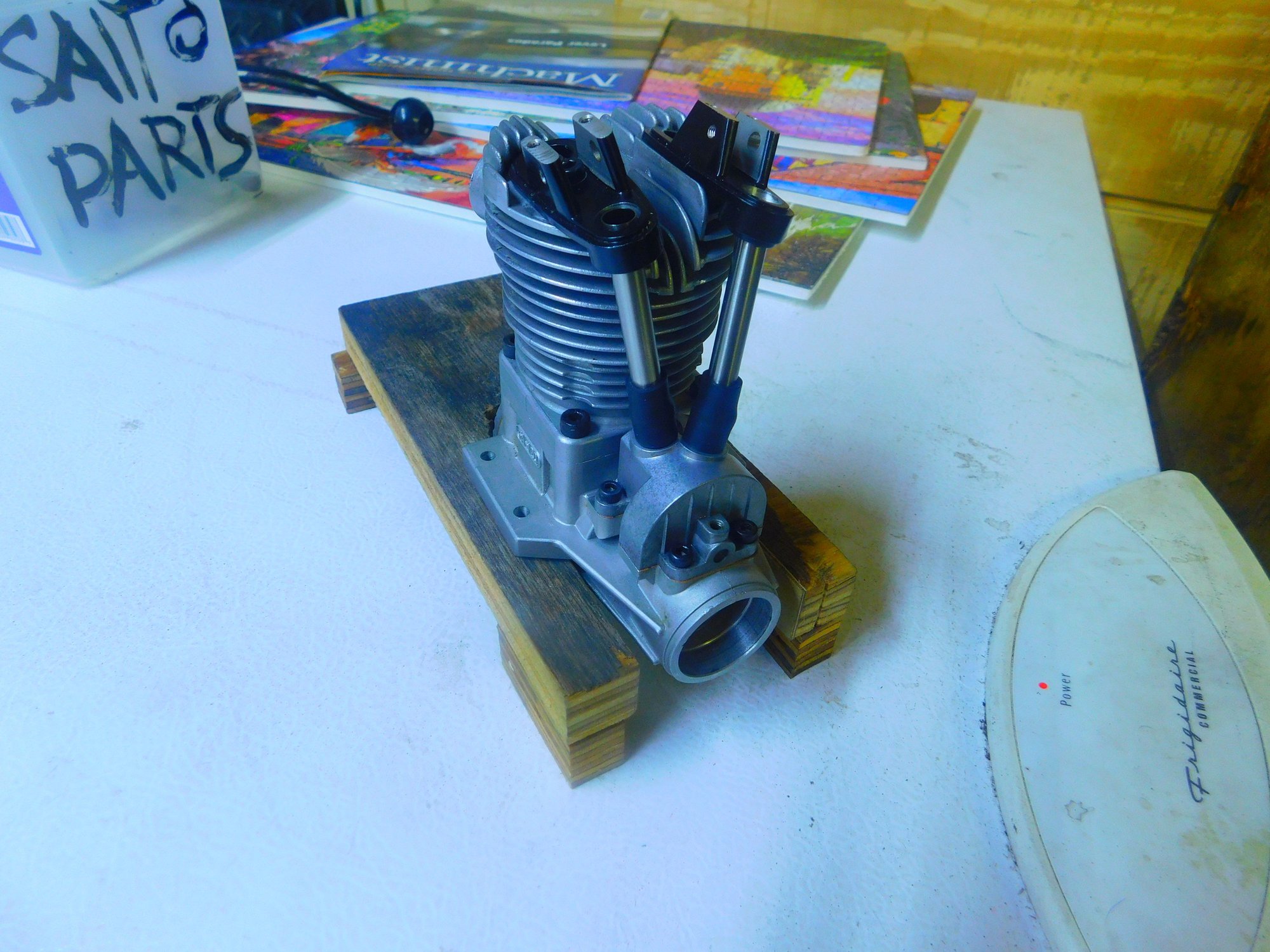

As some of you know I am building another 120-S, as I ordered some parts at MacGregors I ordered a screw set, two of the screws have a Loctite like substance on them. I discovered that they are the hold down screws for the rocker stands . I removed the screws I had initially installed and installed the Loctited screws.
In the words of Col. Klink, "Vellie Intallestink".
Those GK rocker stands add a nice touch of color.

Well I got a nice surprise over the weekend. I went out to the garage to look for some Velcro strips. Low and behold in the same drawer I have checked no less than a dozen times buried under a bunch of assorted stuff, including the Velcro, I found a gold and Black Saito box containing the missing Saito .80! Now I have to find the velocity stack I got for it. I suspect I put it on the wrong engine.
I do have a question for the group, is there a method for determining the correct length for a velocity stack for a specific Saito engine?
Wow, wish I had an 80GK hidden around my shop somewhere.lol Glad you found it!
Somewhere between 1/2" and 3/4" long should catch most of the carb spitback. More important is to make sure the inner diameter of the velocity stack is no smaller than the outer venturi opening of the carb. Trumpeting or flaring out the inlet end of the velocity stack will help to minimize turbulence caused by the Edy Effect and therefore allow air to enter with greater efficiency.
