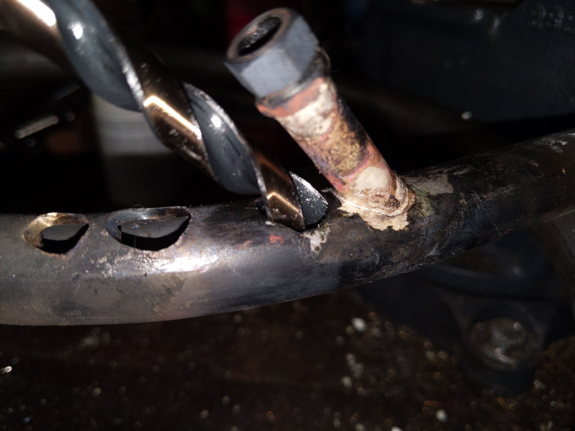

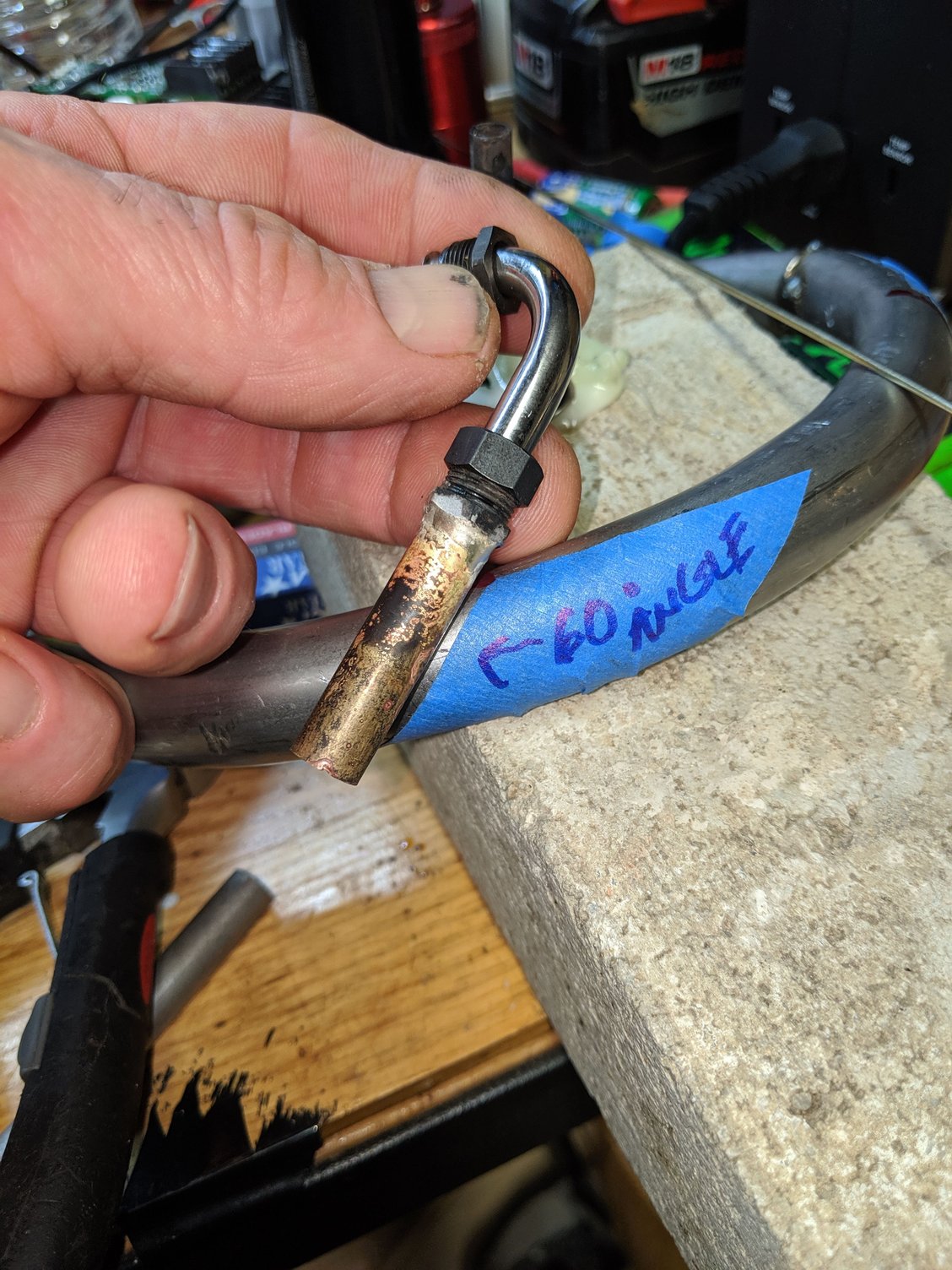

[QUOTE=Jesse Open;12664659]Hyjinx, What is the OD of that tube you are forming?
Hey Gary
First was .500 x .035 bent well and made the ring and it butt welded ( wire) easy. Wasn't happy with the blending of the spigot material with the 3/8 od.
Ran back over and got .750 and bent it cold by hand. Butt welded it and am fitting the first spigot. Ended up using brass tubing for the spigot tubes instead of the hdy tube. (lighter)
Planning a " collector" 1" thinwall oval covering the butt weld and an elongated slot out vert on the bottom of the ring.
This one will look similar to the Keleo, future will be a loop with dual outverts. More for cowled types.
Mitch is putting an R 90 three in a big Byron Zeke hull I picked up in toledo last show. I will make the exhaust.
Probably build the ring to exit the cowl like the full scale on each lower cowl skirt.
I built an exhaust for my ums 77. Individual copper pipes off the headers into collectors, exiting the cowl as in the Harvard or Texan. I wasn't happy with the engines performance. I felt the varing lengths caused unequal pressures.
It ran better with a true ring.
I am photo journaling the project. ( Bad at video lol)
Will post when finished to the OS group as this ring is for the Sirius FR 300. Just highlights on this Saito group.
Don't want to offend or bore this fine group with the " lesser" engine manufacturer.
HeHe
