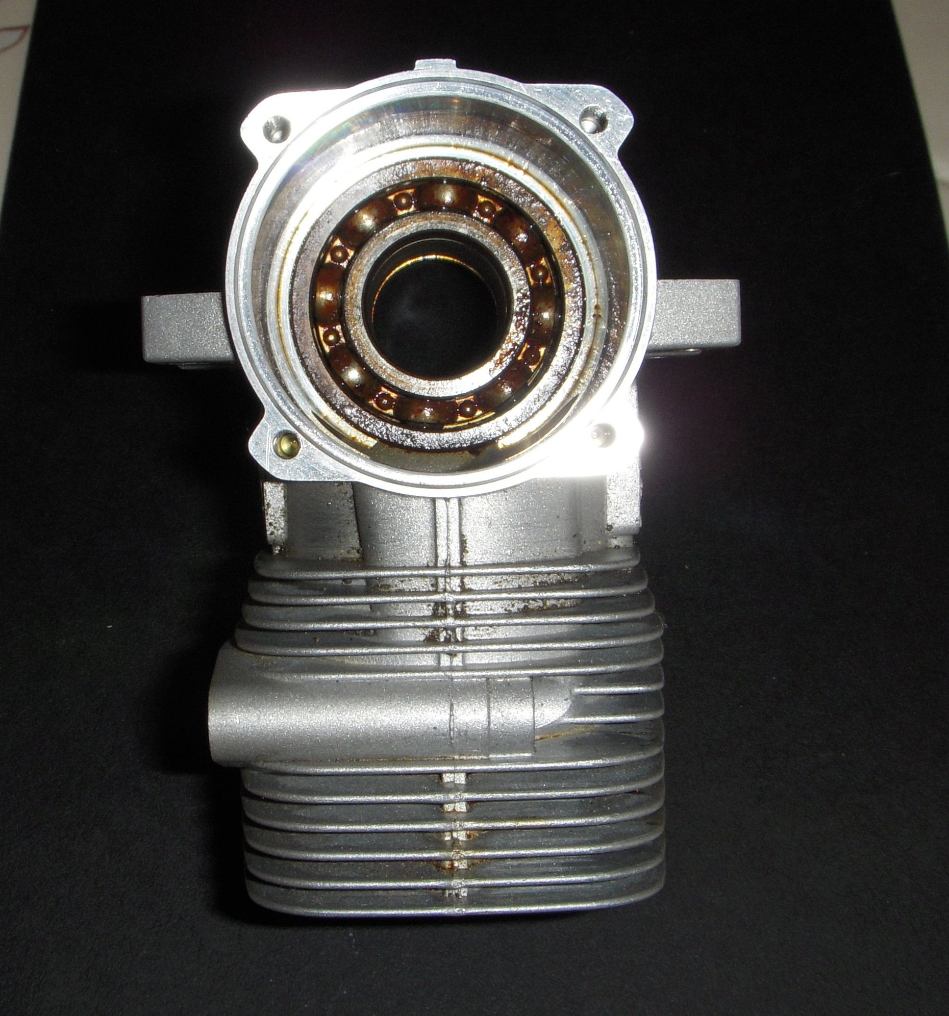

Photos of me rebuilding the O.S. 75 AX engine used on my 60 Sized Hangar 9 P-40 Warhawk I built in 2005
Hangar 9 P-40 Warhawk, modified
Top View...
Dissembled O.S. 75 AX
Rusted Rear Bearing needs to come out
New Bearings for the front and the rear are placed on the crankshaft and then put in the Freezer

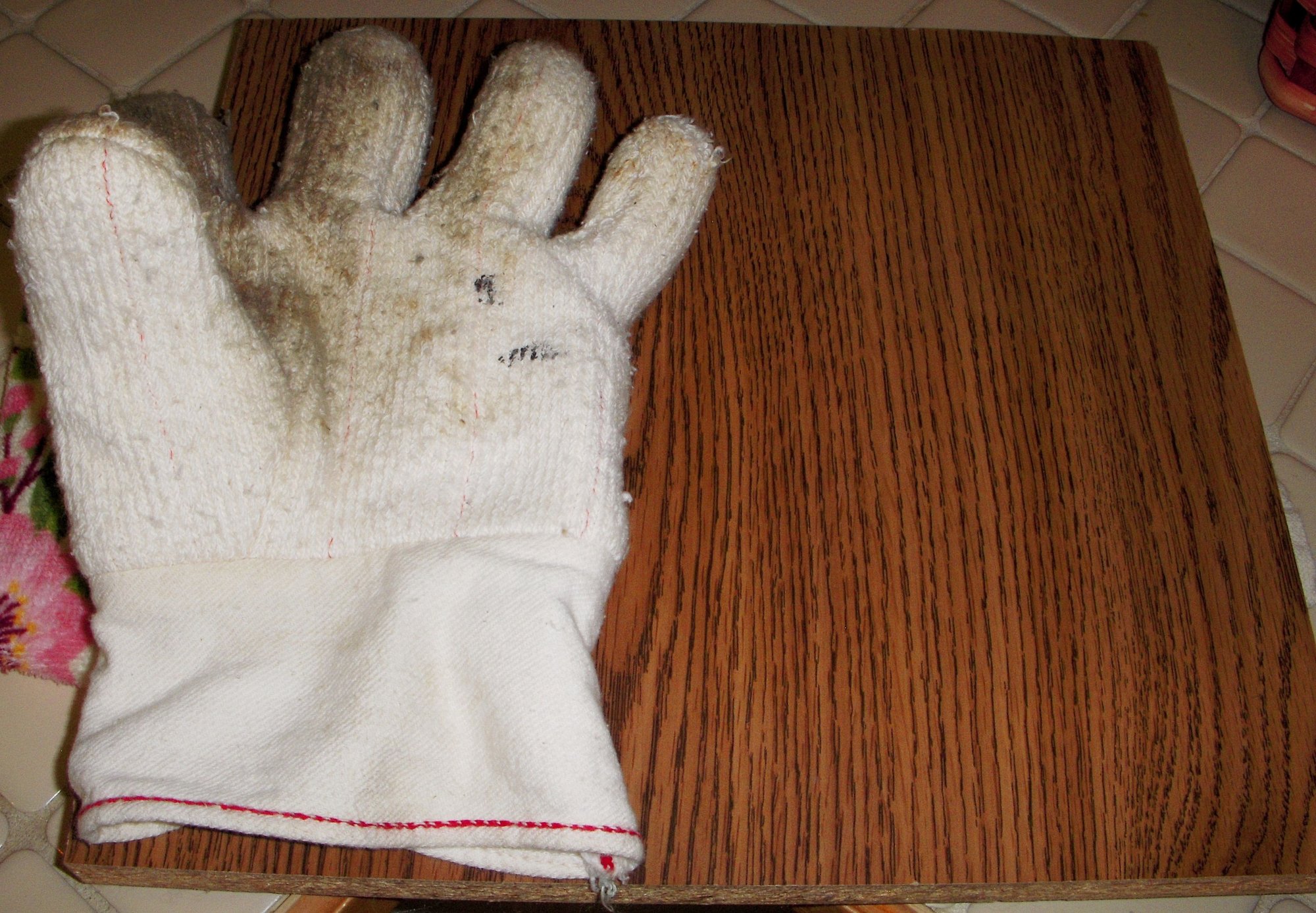

Engine with rusted bearing is placed on a cookie sheet after setting the temperature to 325 to 350 Degrees F for 10 minutes
I use an oven Glove after 10 minutes and wack the back of the engine flush on the edge of a piece of wood... I use an old book shelf... You do not want to hit the engine on the cooling fin section, just the rear bearing housing...
The bearing usually falls out most of the time.. This one was a little tougher... The engine had not been run in over 5 years...
Once the bearing is out, the engine is still really hot.. Carefully wipe out the castor build up where the bearing was, then take the front bearing attached to the crankshaft in the freezer and push it into place.. It goes in really easy, then immediately shove the rear bearing in place from the back...
Now take your back-plate from your aluminium spinner and add your prop and tighten down the nut snug, then start tapping the area around the bearings with the back side of a wooden hammer and keep tightening the nut... Leave everything alone and let it cool on it's own... If you don't have an aluminum back plate, large washers will do...

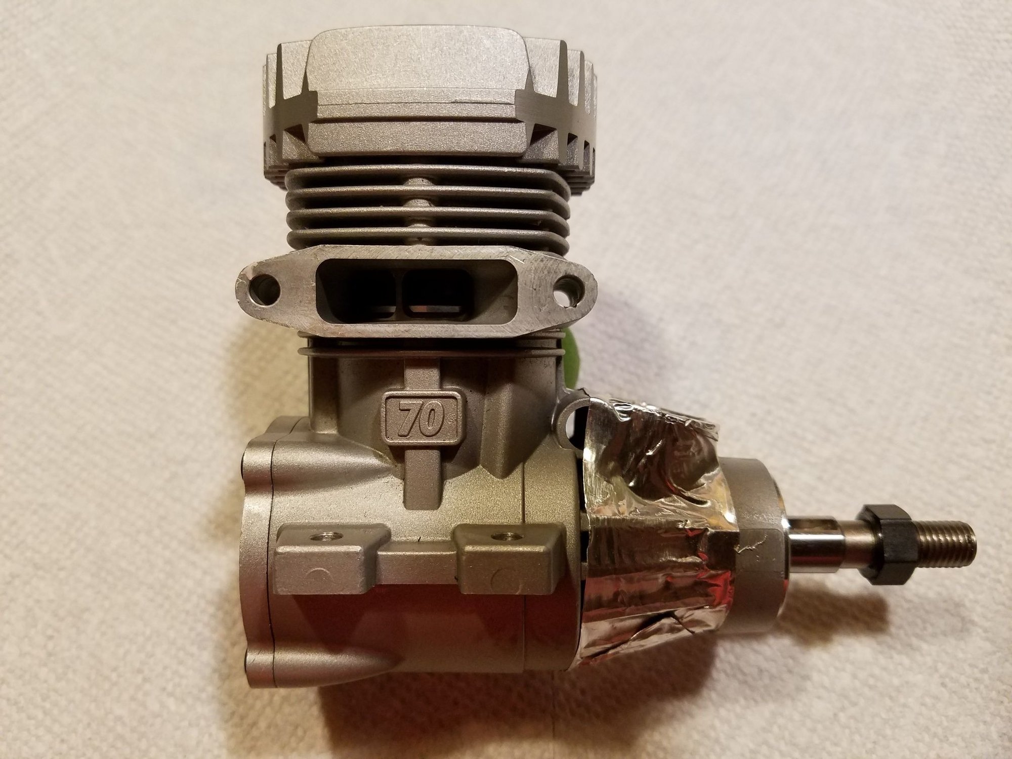

like my OS 50 Hyper Heli engine I have in my World Models P-40 all I need is a shoulder nut for a prop nut. you can see in my photo that I turned the 70's Heli heat-sink head down, and the 70 had 2 extra mounting tabs up by the front bearing, I milled them off too.
edit; BTW, the large Heli carb on the 50 for the P-40 works fantastic for a fast plane. the guys in the club guess it zips around about 100mph
