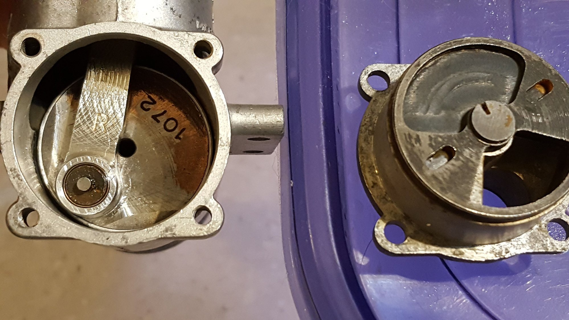

Default G21 29 RV manual & muffler
Does anyone have a manual for G21 29RV?
I have a disassembled engine. Backplate has disk plate.
I don't know which slot the crankshaft pin supposed go.
Also, is there a muffler or tuned pipe to fit on this engine?
2 sets of mounting. one set inside for bolt on (with threads) are 26mm apart. the other set for bold through is 40mm apart.
Any help is appreciated.

First, the engine is designed to run with a mini-pipe, so some sort of tuned exhaust system is mandatory. Mufflers will not work on the engine. Mount the back plate with the pin in the slot that is at the 2 o'clock position in the photo you displayed.
The engine is designed to run in a B Speed class control-line speed plane. I will not work successfully in an r/c plane with a muffler system, nor is it throttleable.
Unloaded, running on the correct style prop, the engine is capable of exceeding 32,000 rpm. If you know anyone that flies control-line speed in your area, contact them.

I think the Macs pipe 2380 is listed to fit from the Mecoa site. I doubt that it is in stock but you never know. http://www.mecoa.com/acc/pipes/mac/headerside.htm This looks like it may be pretty old, before the schnuerle days, so I doubt anything over 24,000 rpm would be possible or wise. It is doubtful that anyone would use it for any speed event now. That was the time when pipes were fairly new on the scene. A carb would have to be made up or an adaptor which is not a big deal. Eliminator Props may have a high pitch prop that could work for speed. Otherwise, an 8-7 might be a place to start. http://eliminatorprops.com/store/ind...dex&cPath=1_30

There's a test of a slightly earlier version of yours here. The difference mainly being no muffler/pipe ears on the exhaust and a plastic disc valve instead of what seems to be metal on yours with a much smaller pin driving the valve. The two slots in the valve is for having the inlet either on top or bottom when fitted to the crankcase. As shown in your pic the inlet would be at the bottom position so it would use the (shiny) slot at the 8 o'clock mark. Although it's not Schneurle ported it uses the ST patented TST porting which is just as effective as Schneurle.
