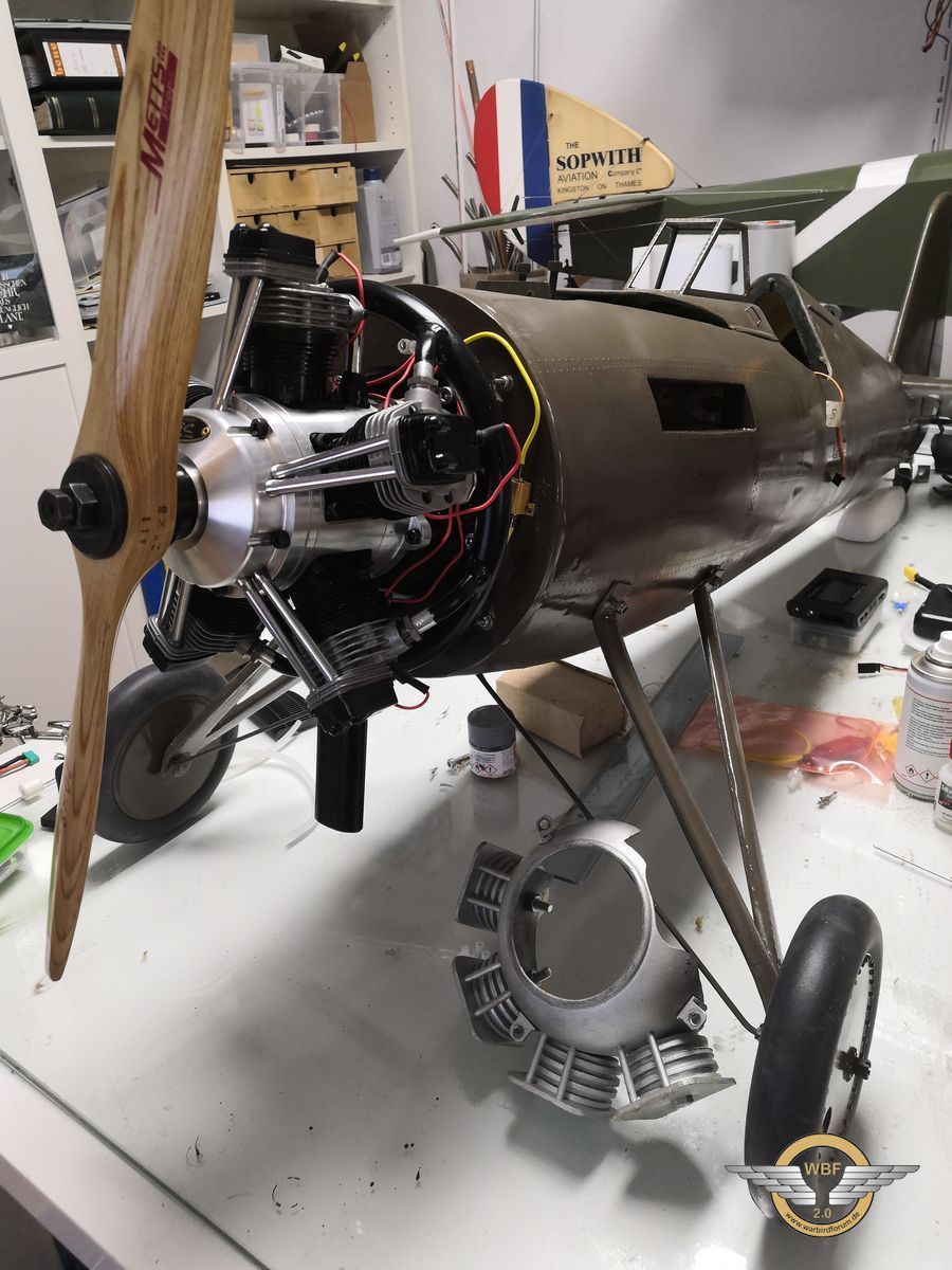

Hey Grassie,
greetings to my old home! Grew up in Pietersburg (now called Polokwane I am told) but been living in Austria for almost 30 years. This worldwide tragedy will soon pass, I am sure, and who would have thought that the social distancing, that is normal to most modellers, would come into fashion someday
I have continued build on my PZL, finished up the radials service and now its mounted. Can't wait to finally fly this thing.
Stay safe y'all,
Rev

Ok, I am back with a question or 2. 1 Which is the best glow plug for radials? I am using OS F. When I remove the igniter from the plugs, the engine starts to bog down.
2.Did you find the adjustment on the high end needle very sensitive? the range at which the engine runs fine is very small, 5 or so clicks.

@1: OS-F are perfekt. If it starts tumbling without glow its dialed in properly
@2: Yes, the sweet spot is very thin. The carb is a catastrophe to work with though. I am changing it for an OS 60P soon.
