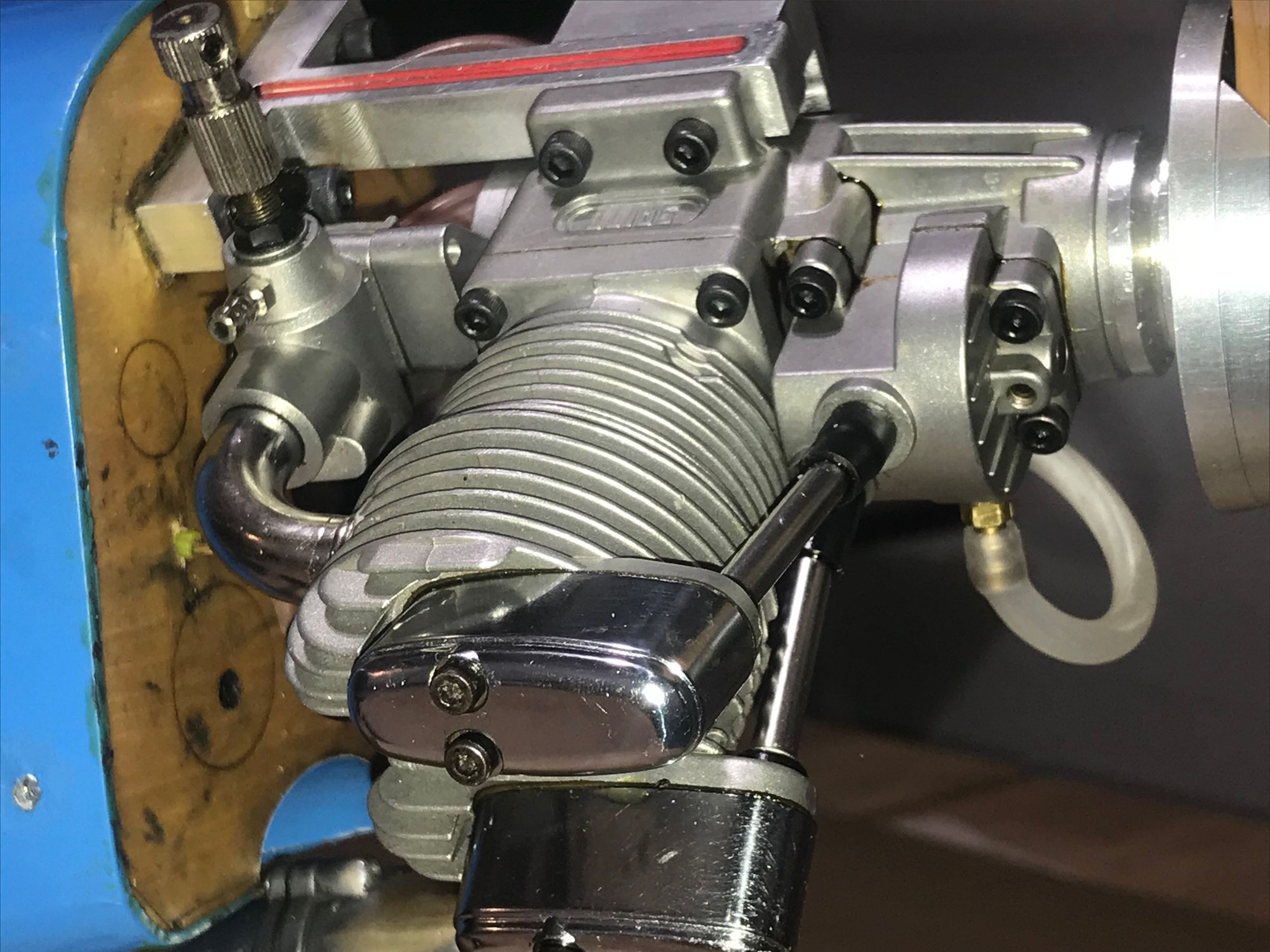

Many of us have found they work better where we put them...

Always room for improvement
FA-82 with vent upgrade
Original Open Rocker 30 with relocated vent.

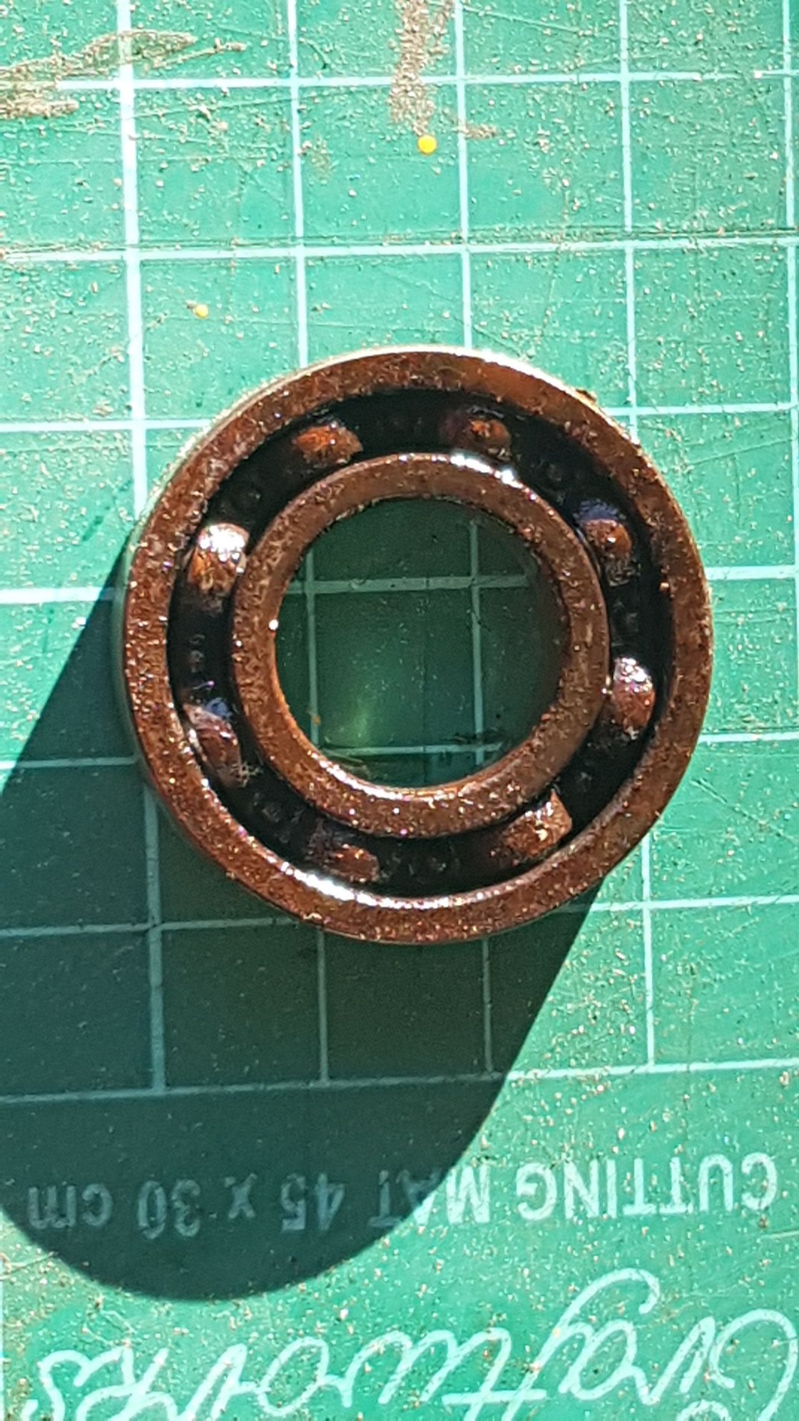

Old 06-29-2019, 03:25 PM
  #390
The Ghost
The Ghost's Avatar
Join Date: Mar 2004
Location: UlladullaNSW, AUSTRALIA
Posts: 1,868

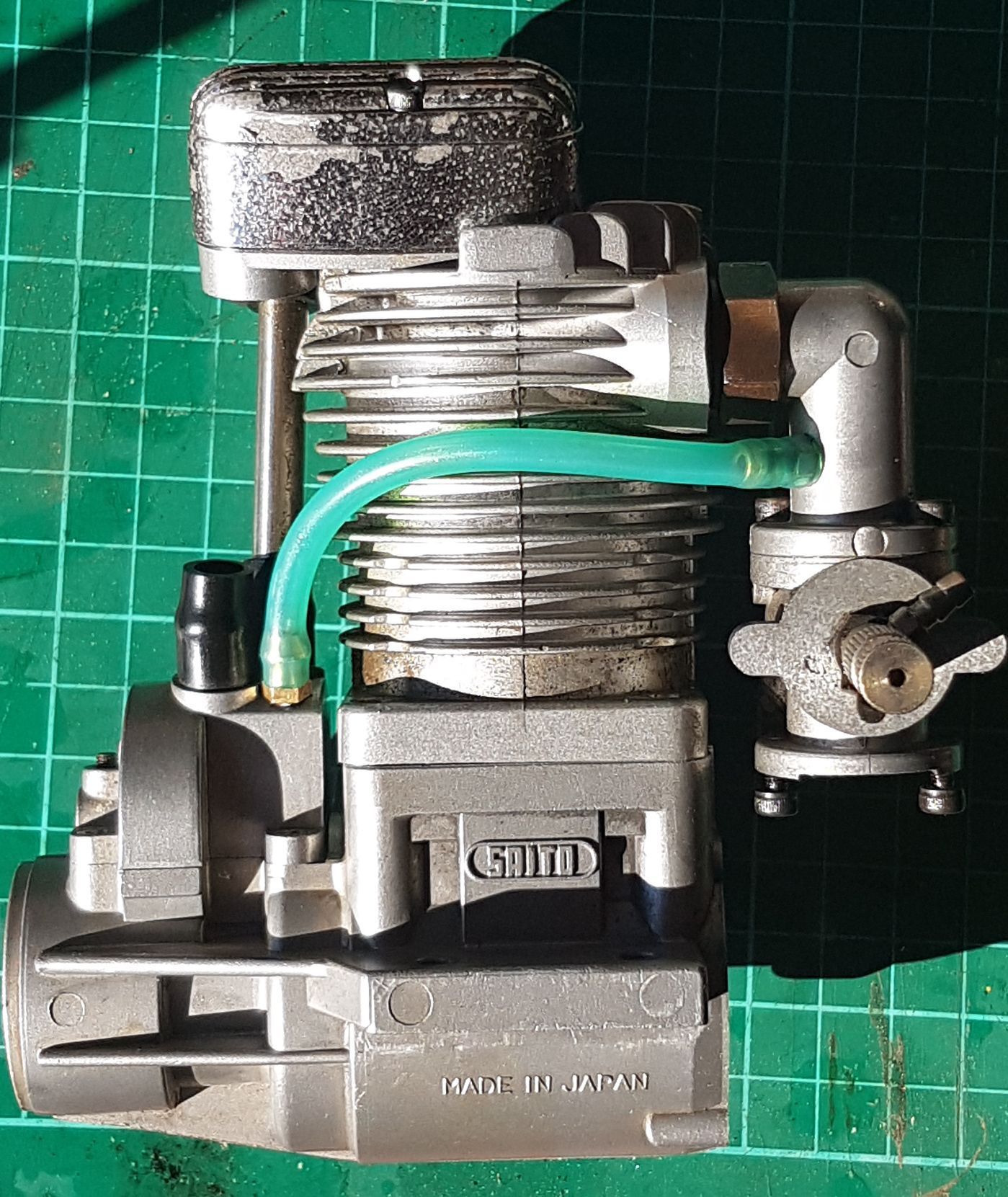

Hi All,
Picked up a 180 for $50 of flee bay, full of rust and work cam, and lifters, I knew that engine would be bad, just wanted it, it has very good compression, and spins a 17-8 at 8500rpm with more to go, Stripped and cleaned up the crank, cam and associated parts, ordered new bearings, cam and lifters, and them machined up new muffler, and modded the cam cover with a new vent nipple. Will cap the one in the back cover.
Cheers
Andrew
Old 06-29-2019, 05:07 PM
  #391
Jesse Open
Jesse Open's Avatar
Join Date: Mar 2018
Location: 30 Miles North of Canada Border
Posts: 3,758
Received 91 Likes on 83 Posts
Very nice Andrew. I really like that vent fitting location.
Should greatly improve overall oiling up front. Both running oiling and after the run oiling
Old 06-29-2019, 10:25 PM
  #392
The Ghost
The Ghost's Avatar
Join Date: Mar 2004
Posts: 1,868
Jesse, thank you, I done some more with it this arvo, as the 180 has a cast inlet manifold, so after checking dimensions, I fitted a nipple in the inlet manifold, will be able to use as a sort of PCV system.

Old 06-30-2019, 07:09 PM
  #394
The Ghost
The Ghost's Avatar
Join Date: Mar 2004
Posts: 1,868
Jesse, no problem, the center for the cam I drilled at 4mm(0.1575) from back of cam cover and 4mm(0.1575) from the side of the cam cover, and drilled in the same plane as the inlet lifter. Here is how it will look when assembled, still waiting on parts.
Cheers
Andrew
Posts: 1,868
Hi All,
Parts arrived from the USA, local agent did not have in stock, still waiting on local order of cam, shaft and spacers.
Cheers
Andrew

Old 07-15-2019, 05:36 PM
  #400
The Ghost
The Ghost's Avatar
Join Date: Mar 2004
Posts: 1,868
Hi All,
Got all the missing parts, assembled and have now run. Work well, you can now see the oil traveling in the tube to the inlet. Still running rich in the idle mid range, idle needle had be opened up 5 turns by the previous owner, don't know why. Could not run much with the old bearings, now will finish up the settings and then fit to aircraft.
Hobbsy, I all ready had the gaskets, ordered them with the bearings before disassembly, and that is when I found the bad cam. Can be seen running at https://www.youtube.com/watch?v=7z46...ature=youtu.be closeup of tube to see flow at 3:20
Cheers
Andrew
