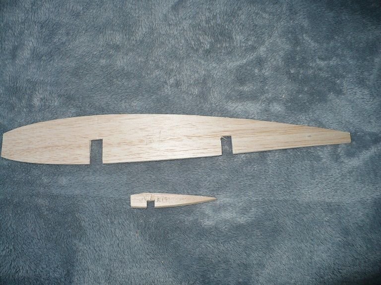

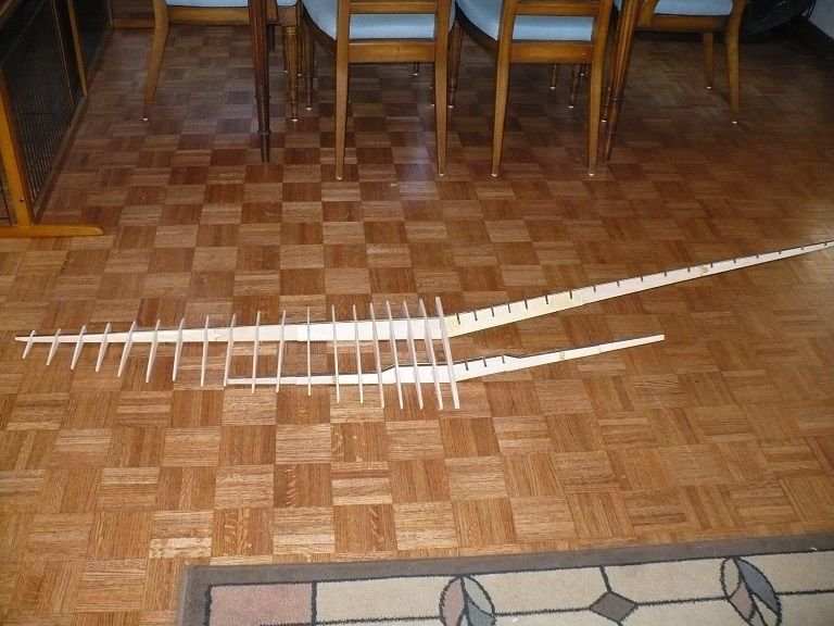

Thanks Ken! I am still tempted to build it. Do you have any additional photos of the finished aircraft? What retracts did you use? I would go with a built up wing with hand cut ribs or draw them up and have a laser cutter service cut them for me. As you can see from the two photos tapered wings don't bother me, this wing is for a Ryan SC-W. I hand cut two sets of ribs for the wing you see here. Good thing too, the wing had an accident, it fell from the overhead rack in the garage and smashed some of the ribs. The ribs you see hare are 3/16" balsa. I had a short cut for the Walt Muscano Navion (appeared in RCM 11/82 issue) the wing design is very similar to the SC wing but it has 1/8" ribs. I had fixed gear parts eliminated, I plan to modify it to take Robart gear probably the 510 RS main and 517 nose gear. I have a weakness for making design changes. If you want to see more on the SC-W project the build thread is here: https://www.rcgroups.com/forums/show...nce-post-build

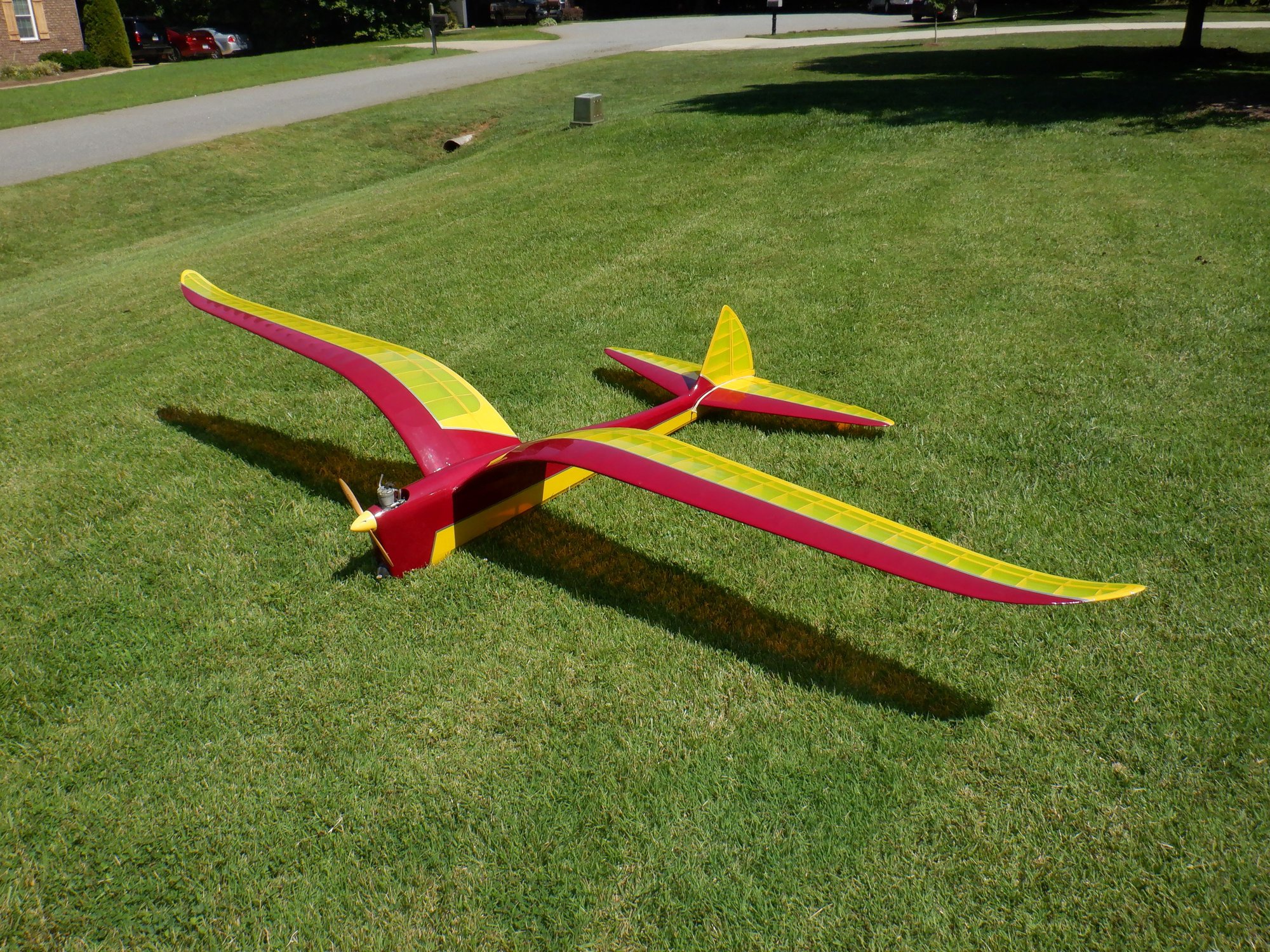

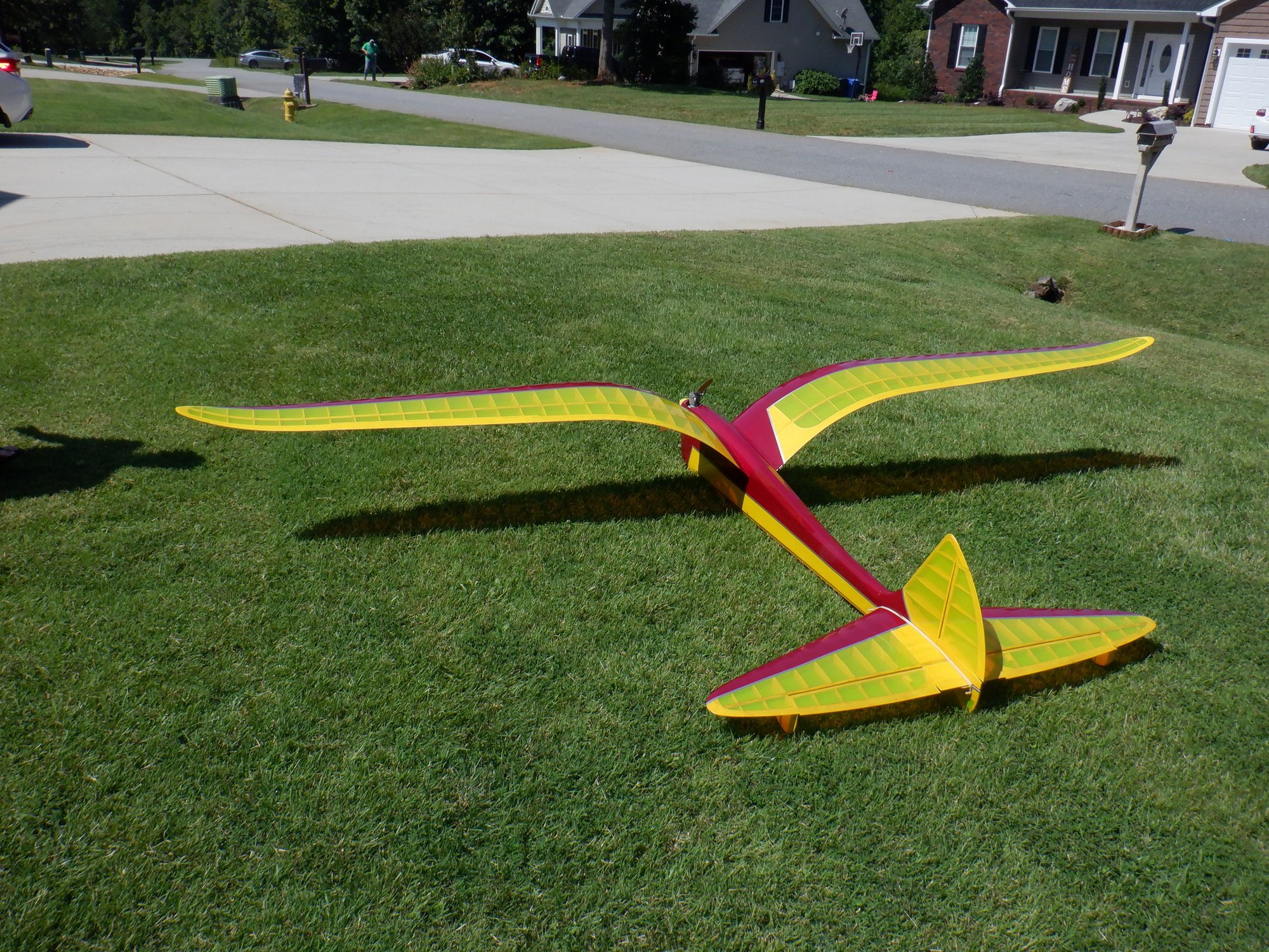

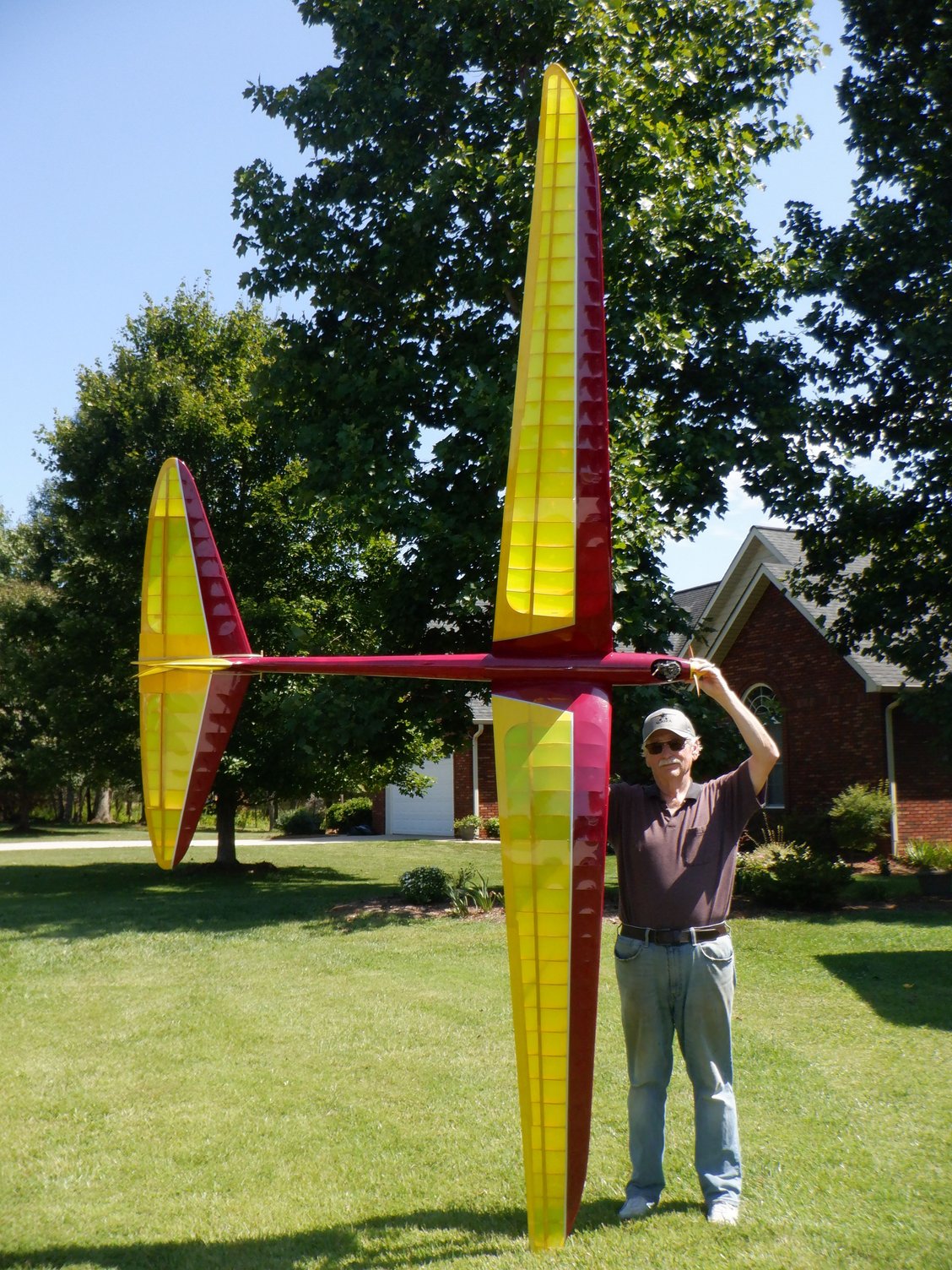

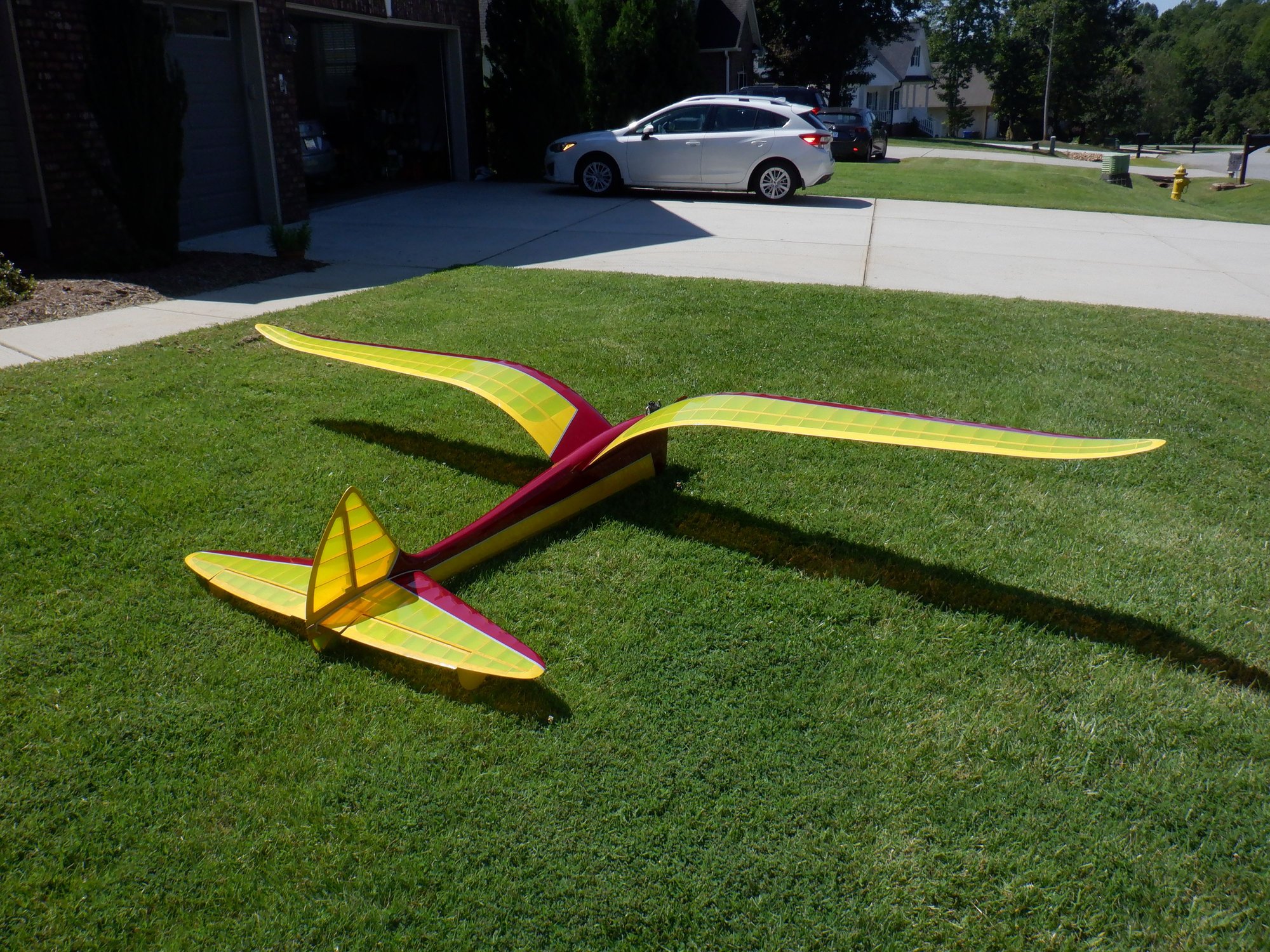

Default Finished (Mostly)
It is sunny and not windy today in NC, so here are some pix of the mostly finished "Gulliver's Traveler"
Thanks everyone for your interest. Now I'll have to see if can generate some interest at the AMA Museum.

Looks wonderful! It would be a shame if it would never fly, so couldn't it be flown at the AMA field in Muncie before putting it in storage? There should be expert pilots (with insurance) who would value it.
Woulda, coulda, shoulda, I know, but this is different. Or should I say "it must be flown..."?

She is one big beautiful bird! The curve of the wings are fantastic! I'll bet she would be amazing to see in flight! I hope the AMA museum accepts her she has a lot of WOW factor.

Beautiful. Should release plans of her!
Fingers crossed the airplane gets the audience it deserves.
