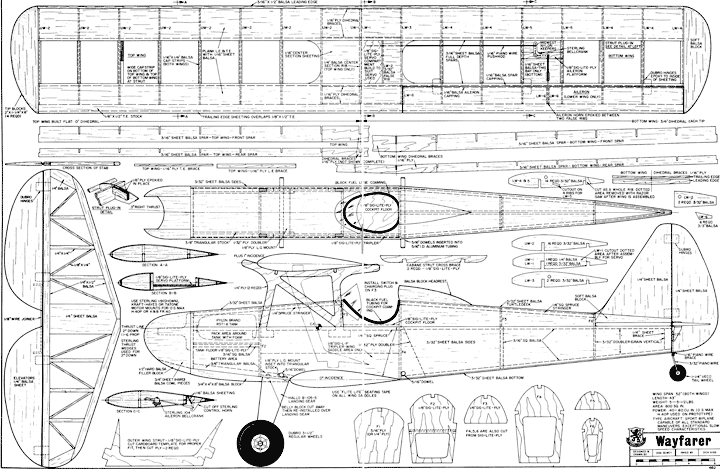

I've been keeping my eye out for a bipe project for a long time, and came across the Wayfarer by Don Dewey. It's from the 2/72 RCM and is based on an earlier bipe called the Hobo. The Wayfarer has 52" equal-span wings, 800 sq." of area, and a weight of 5 - 5 1/2lbs. With a K&B .61 it should be a lot of fun.
Has anyone here built or flown this design? I love the lines and the simplicity of the design (no soldered wire cabanes).

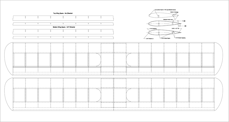

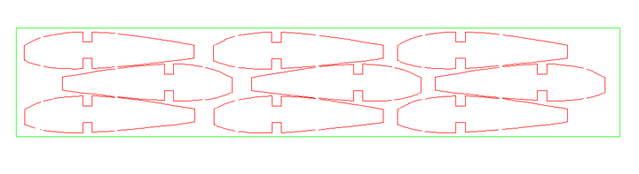

I know I said earlier that I enjoy cutting out ribs and I do. But, I thought maybe someone else here might like to build a Wayfarer, too, so I spent a little time drawing a laser cut file for the 36 ribs.
I'm changing the wing construction to suit my style of building. I'll use two 3/8 sq. spars, instead. I'll still sheet from the spars forward, sheet the TE and use cap strips like the plans show. I just don't care for the notched, full-depth spar method. It's hard to get eight full depth spars that are all perfectly straight. With the over-and-under spars you can jig the wing before gluing and make a straight wing much easier (at least I can).
Here's an image of the cut file. I got nine ribs on a 24" x 4" sheet to save on cost. Four sheets will give me all the ribs. If anyone else wants to build one I'll get a quote and we can order the ribs together to save on shipping. I might draw some of the other curved parts if anyone's interested. I'm thinking the plywood cabanes and struts would be nice to have laser cut.
David
I will check out the Comedian, too.

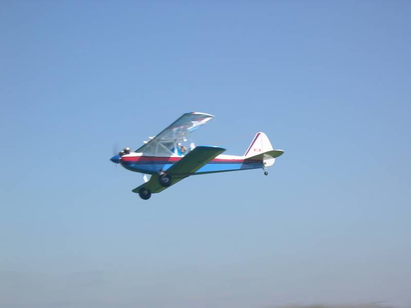

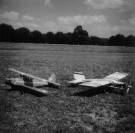

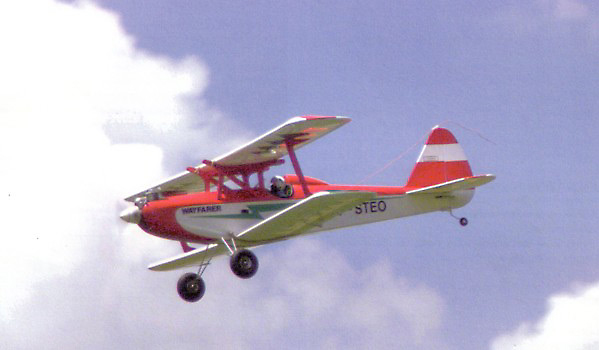

Hi David,
The Wayfarer was/is very popular here in Belgium because Svenson ( which was a Belgian kit manufacturer, before they moved to Spain and went under) had it in their line for years. Probably hundreds of them flew over here, and they can still be found all over the country. Great flier with a 40-45 engine, and still okay with the less powerful 60-61s.
See pics attached. At least 3 of them in our club ( on 40 members only!). Have a partially kit myself, and sold another one to somebody who absolutely wanted one - these are really hot over here, after all those years.
How did it work with the Aurora plan parts I sent you? Still working on that?
Kris
Kris

Ok, I traced the wing and drew a laser cut file for the ribs. I have ordered four sets of laser cut ribs. They are for the original size (not enlarged). I can let you know the cost when I get the invoice. One is mine and one is spoken for. That leaves two sets if anyone wants one. I went back to the original construction method with full-depth notched spars. I made all the ribs the same to keep it simple. The center ribs will need to have the spar notches enlarged 1/16" for the ply dihedral doublers and the ailerons cut away as described on the plans.
David
David

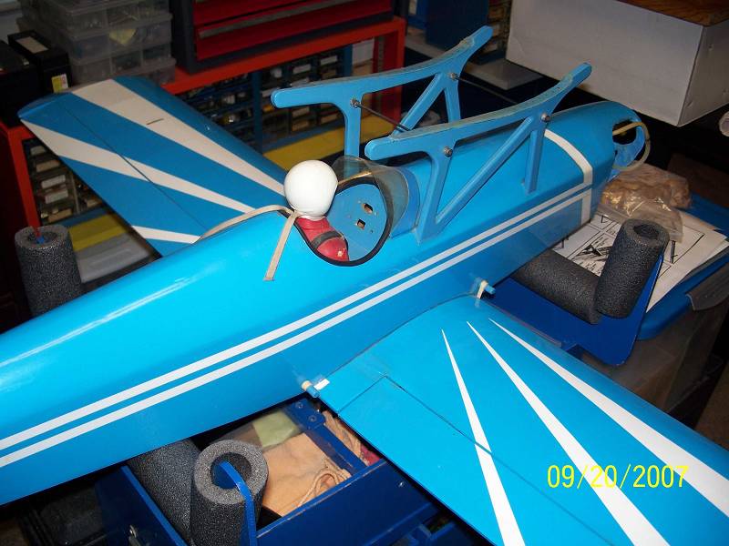

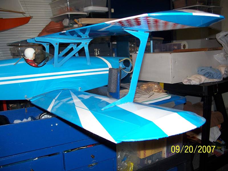

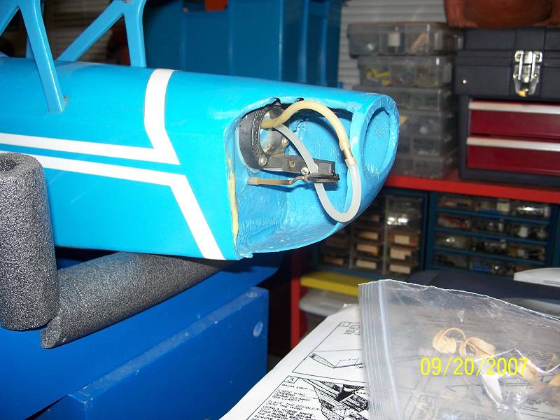

My Wayfarer first flew on June 10th, 1978. I didn’t have a computerized flight log then, so some day I will add up how many flights it has made. I flew it up to the late 80’s and then I hung it on the wall where it’s been since.
This was a scratch build from RC Modeler Magazine plans. I modified the strut area a bit as the photos show. I used yellow wood glue and epoxy in the construction. The covering is MonoKote. I glued a block of foam on the firewall and sanded it to shape. Then I used glass cloth and epoxy to protect it. One of the photos will show the glass cloth inside the cowl.
The empty weight of the plane with no engine (ST .46) and radio is 4.10 pounds. So I was probably flying at 5.5 to 6 pounds back then.
It was a lot of fun and a gentle flyer. When I get time, I will fly it again. It would be nice this time around with a four stroke engine.

Nice looking model, cjet! I'm getting more excited about building this plane. I got my plans printed out and notification from my laser cutter that the parts are in progress. As I said, I'll have two extra sets of ribs. I'll sell them to anyone who wants one for the actual cost plus shipping.
David

I got the Wayfarer ribs today. They look nice. I have two sets of 36 ribs (4 sheets each) left that I want to offer to anyone at cost plus shipping. PM me if you're interested.
I re-drew the wings in cad along with the spar patterns. Building the wings will be a lot easier now.
David
David
