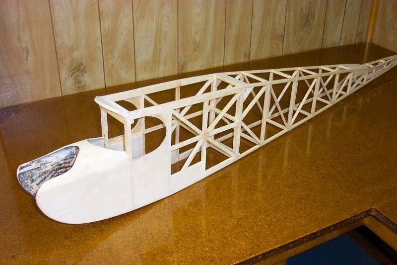

LOL.. I'm glad you noticed the workbench too Speak.
I started to feel bad about myself, his bench is cleaner (and shinnier) than my planes!
The fuse looks like new build. Great attention to detail rs670. Please keep the pictures comming!

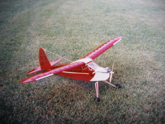

rs670, here's a couple of pics of a 72" ws plan built Pacific Ace I built for my wife, Joyce, to fly. It's covered in Transparent Red and Cream Monokote with 1/8" Gold pin striping that I cut from a roll of Gold Monokote. Thought you'd like to see how nice the transparent covering can look on an Old Timer like you have there.

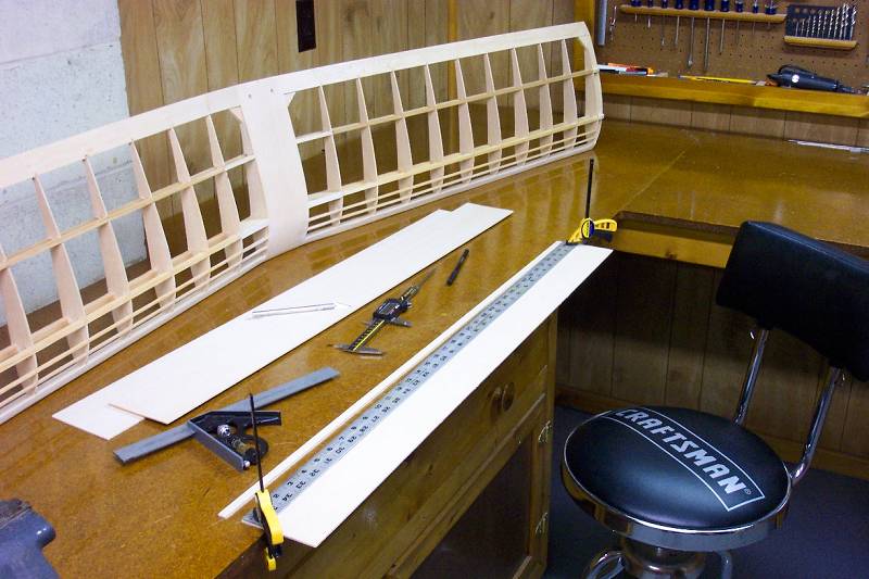

Here are a couple more pics.... I'm starting to sheet the center section of the wing. (lot of work here) I haven't decided yet about bolting on the wing or using rubber bands. I'm leaning toward the bolts if I can come up with a clean way to do it.

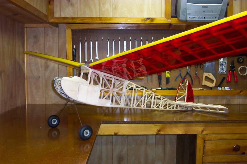

Here some pics of latest status of project....
Today was spent designing bolt-on wing, finish sheeting top and bottom center section and contouring wing saddle to perfectly fit airfoil of wing. Still lots of filling and sanding to do....

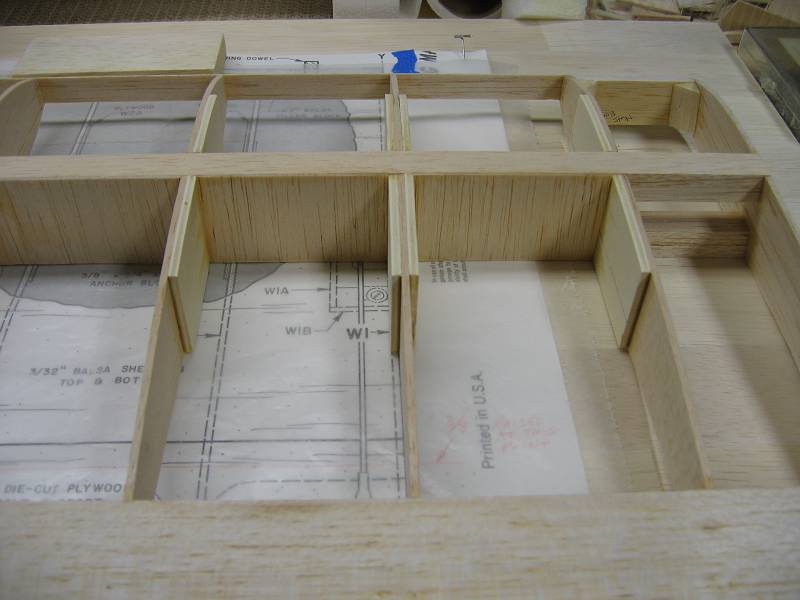

Another suggestion if I may: On your wing you might want to add some 1/16" sheet balsa shear webbing (vertical grain) to the back of the main spars and carry this outward to the wingtips. I know it can be a pain to do this but the strength factor on your wing will be greatly enhanced. I'd do this on the rear spars at least halfway out towards to tip, too.

OK... on the shear webbing, I don't understand (vertical grain). Is the grain going 90 degrees to the spar or parallel? One more question... how big are they? I have lots of time.... maybe I'll do that.

Hi, Rick. Here are a couple of pics from my Astro-Hog build that show the webbing I'm putting on the model.
Pic 1 shows the tools I use: in this case I am using 1/16" x 3" wide balsa sheeting of medium weight, hobby knife with #11 blade, pencil, metal straight edge, and sander.
Pic 2 shows the web in place: note the grain. I measure the distance between the top and bottom of the wing spars and add 1/16" to the dimension. Measure this dimension on the 3" sheet stock and mark. Cut via metal straight edge and #11 blade. Now, what I do is rest the wing panel on its leading edge so as to make it easier to add the web piece. I gently sand one edge flat on the web (an edge that will glue up against a rib) and lay the web in place over the two spars. You should have a little bit of wood overhanging the top and bottom spar. Now, the web will rarely ever fit exactly as cut so either sand a little bit off the "to long" end to match the mating rib or, in some cases you might have to add a bit of wood to make the web a bit longer in order to fit well in between the ribs. I generally will cut an extra web of the proper top to bottom dimension and set it aside; when I need to add a bit to lengthen a web I cut off about 1/4" of the extra web to make a shim and glue it to the web via thin CA. Then you can trim to fit when installing the web.
So, measure the distance from the top of the top spar to the bottom of the bottom spar and add 1/16". Make up and complete one web at a time and work your way out as far as you want to go.
Mark the measured distance on the 1/16" x 3" sheeting keeping the grain vertical (running 90 degrees to the spar). Cut this web from the sheet stock. Very lightly sand one short edge smooth to mate against a rib. Lay the shear rib against the spar and up tight against a rib with a bit of sheet hanging over each spar. Adjust the web to fit the space between the two ribs by either sanding or adding a piece. When satisfied with the dry fit, place glue on the two spars between the ribs ( I use medium CA) and carefully press the web to the spars and rub down. I use a metal straight edge up against a rib to ensure the webbing is tight against the rib and flat against the spars. Add a drop or two of thin CA to the web/rib joint and hold the web in place. Turn the wing over and apply thin CA all the way around the inside joint (spars and ribs) and gently rub the shear webbing against the spars. Wait a minute or so and take your sanding block up and knock off the protruding 1/16" sheet hanging over the spars. This just takes a minute to do both sides. Pick up the balsa dust with a vacuum and admire your work! Once you do a couple of these they go quite fast and you will notice the wing is much stronger. If you have any questions just ask and I'll try to help.
One other thing: before I do a shear rib I examine the space between the two ribs and note if the rib to spar joint is a good one and if I need to gently run my sanding block across both spar surfaces to flatten them out for better web contact. Just takes a second but is worth the look.

Thanks Joe,
I really feel stupid now.... As soon as I read your email and looked at your pictures, the lights came on. For some crazy reason, I thought you were talking about some sort of triangle shaped gussett. (which I've never seen used in that application)
Yep, I've used that type of webbing before and thanks for reminding me about the procedure. I will definately do it.
I'll follow your suggestion and do all the front spars and at least half the rear (maybe all)
What do you think of the conversion from rubber bands to bolt on? There's a lot of reinforcement that the pictures dont show. It will definately not break in that area.

WOW Sqeak, what have you got me into? (Hehe)
After measuring distances between ribs, I found they vary anywhere between 3.227 to 3.552. There are 38 bays to address if I do them all. (and I probably will) Fortunately, I have enough 4" stock here in the shop. I'll just trim close to 1/2" off each sheet prior to cutting individual pieces. Another thing to compensate for is the small fillet of glue at each joint. I'm sure you want the webs to fit flat against the spars and also tight against the ribs.
Oh well, here goes!
