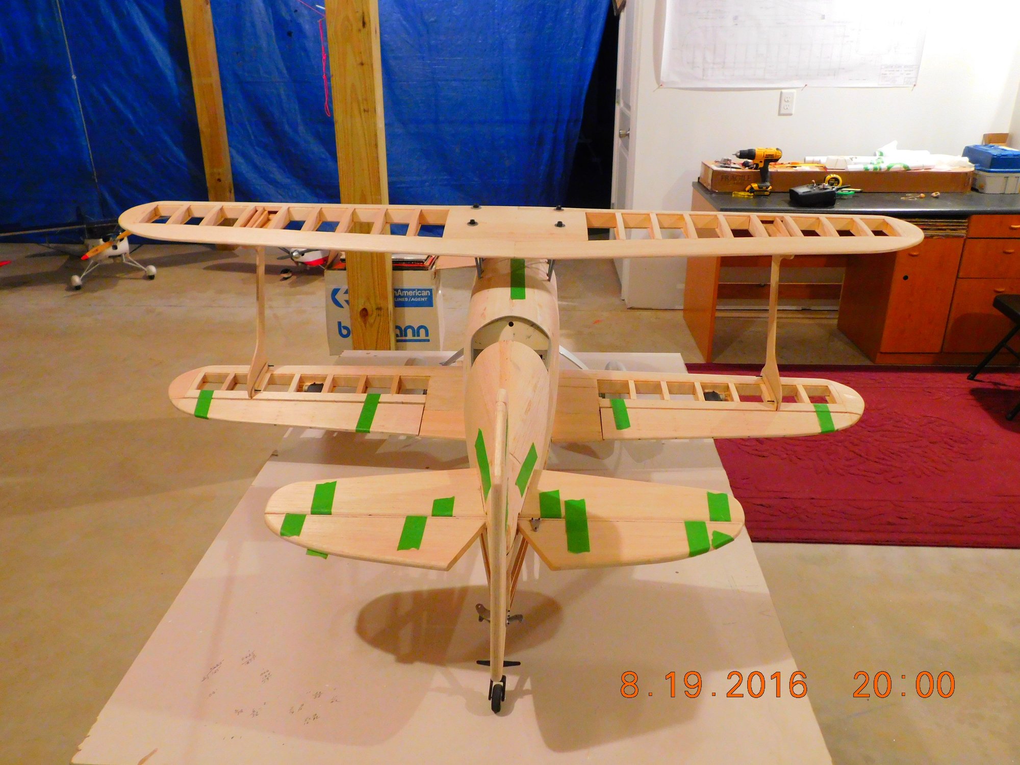

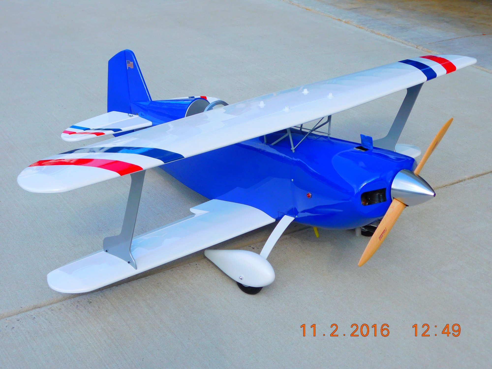

That aside I have included a couple pictures of my scaled down 54" Knight Twister. It is powered by a RCGF 26 cc gas/oil engine and
weighs 14 lbs. finished with UltraKote, Spektrum Dx7 for guidance.
Note: the green on the bare bones picture is not a new type of hinge . It is green tape holding the movable surfaces in place prior
to hinging. Ha.
UltraKote finish
Twister finished but prior to hinging ailerons/rudder and elev.
Originally a 20 cc RCGF but changed to a 26 cc RCGF due to finished weight of the Twister.
Scratch fabricated cowl with hinged access door for adjusting carb needles.

Thanks for your prior comment: Nice model, love sport biplane scale models.
