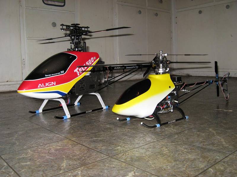

Gee-wiz Ed, your not talking about my "Little-Booger" are ya? Just cause it has been modified beyond what a normal person considers as reasonable.
Poor "LB" has been sat aside[&o], so I can finish setting-up his BIG brother (T-rex 500)
, something more than twice the AXE's size!
There's NOTHING left to modify on the MX300, it has ALL been done. 3700kv BL main, BDT, CF main/tail blades, full aluminum rotorhead & swashplate, Align landing gear & 3D struts, boom braces, F/G canopy & lighting system on canopy, boom & blades. The only thing left would be a full body kit, but after looking into them I opted not too.
Here's a few pics of the MX300 "LB"
Shadow
Shadow
