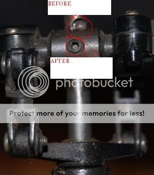

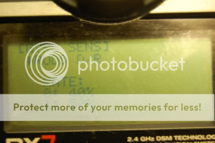

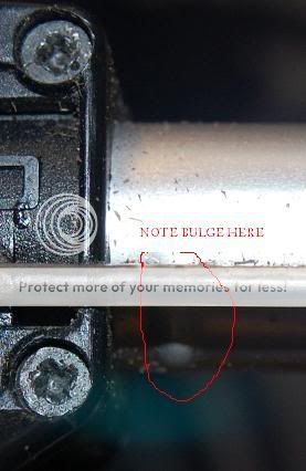

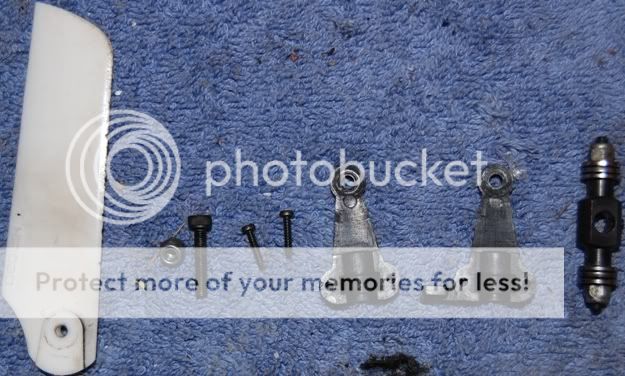

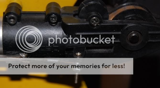

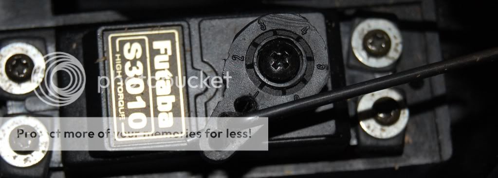

This week I upgraded my tail servo from the Futaba FP-S148 to the Futaba S3010 (about 20-30oz. more torque and about .05 sec more speed). I had to reverse the servo setting in my TX to get it to correct the right way, but didn't think to change the gyro pot (it seemed to be correcting the right way when wagging the tail by hand). I also moved the link to the center hole on the tail servo arm (I tried the farthest hole in, but didn't get hardly any travel out of it). On the first test flight of the day, the tail wanted to pirouette wildly in the last manually inputted direction. I caught this quick and never got it more than about 6-12 inches off of the ground until I figured out the problem. As I mentioned at the beginning of this post, the gyro reverse pot was switched the wrong way, so I reversed it and proceeded to set my gain. I managed to get the gain pot to about halfway, then found that setting the gain to about 30-40% in the TX gave me a smooth tail lock that required minimal trim.
After getting the tail worked out (or so I thought, but more on that in a minute), I noticed that the heli was vibrating. Not so bad that I couldn't control it, but bad enough to keep me chasing the cyclic all over the place and watching the heli "toilet bowl" to an extent. The first thought that came to my mind was a bent flybar, but I'm uncertain of this. It looks seemingly straight by eyeballing it while still mounted to the heli. Another thought that has crossed my mind is that the flybar carrier does slide from one side to the other. Thinking of the centrifugal (or centripetal) force, I'm not so sure. However, thinking of the difference in lift (ie flapping on a flybarless head/retreating blade (paddle) stall), it may be possible that this is the culprit. I don't feel that it's the feathering shaft or the main shaft, since if either one was the culprit, the heli shouldn't even be flyable/controllable (from what I would think). Could this be a bent part issue, or another byproduct of low headspeed?
On the second flight of the day, I managed to get about 20-30 seconds of a good, solid, "locked-in", tail-in hover, but couldn't repeat it the rest of the flight. The vibration seemed to worsen, but not to the point of being completely uncontrollable. After running about 1/4-1/2 tank through her on this flight, the tail suddenly quit turning to the right. I had enough right rudder to keep the heli straight, but not enough to initiate a right hand yaw. I had turned to a right side-in hover, drifted forward (to my right), managed to get her stopped, she started yawing left, I tried to correct and couldn't, so I let it yaw left back to tail-in, and brought her back to where I wanted to set her down at. After shut down, I brought her back to the table, leaving the TX/RX powered on, and checked the tail control throw. She had plenty of travel left, but movement to the right could barely be seen. Before the flight, she had an equal amount of travel in both directions. When the tail blades are at the current max right hand throw, the pitch slider is nearly touching the tail gearbox, allowing no more right hand travel. It seems that something in the tail is being inconsistent. I've had to slide the tail rotor from the inner divot (for the tail rotor set screw) to the outer, and back again (where she was at for today's flights).
I like this heli, but all of it's little "bugs" that keep rearing their ugly heads are making me think semi-seriously about buying the next .30 size ARF heli to come into stock at the LHS and transferring the gear over. However, that's the lazy way out. After 2 years of attempting hovers on squirrelly little electrics, crashing them, and repairing them, I've taken enough punishment to both my pride and my wallet to make this look like child's play. When I get this thing right, I'll have learned something from it (what it is, I don't yet know), and take pride in what I've done (with your great amount of help). I'll also be able to take these lessons with me on to my 50 size next year. Maybe it's time for some more close up snaps of the parts in question.
I'll try to get those snaps posted before I hit the hay tonight.

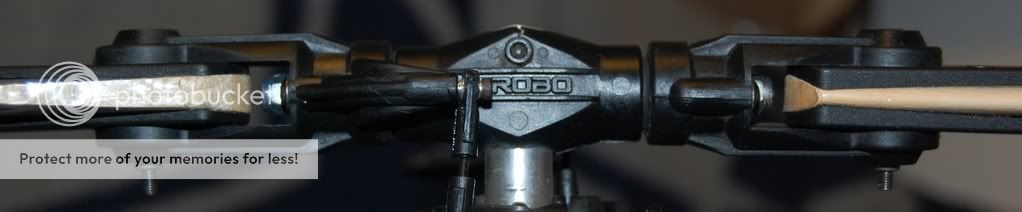

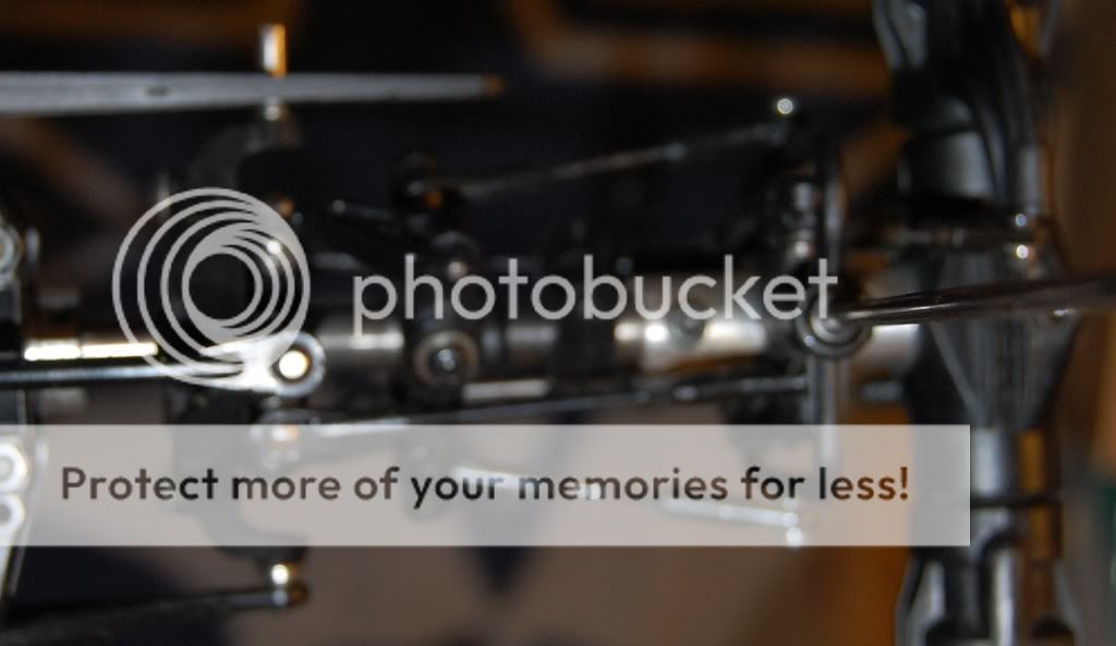

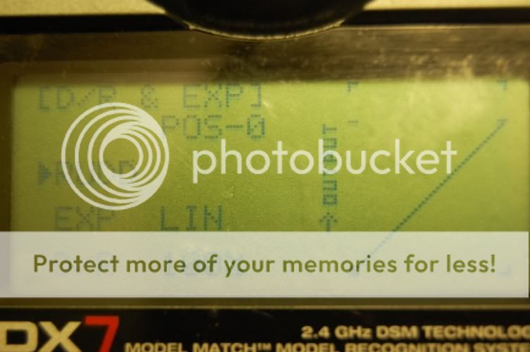

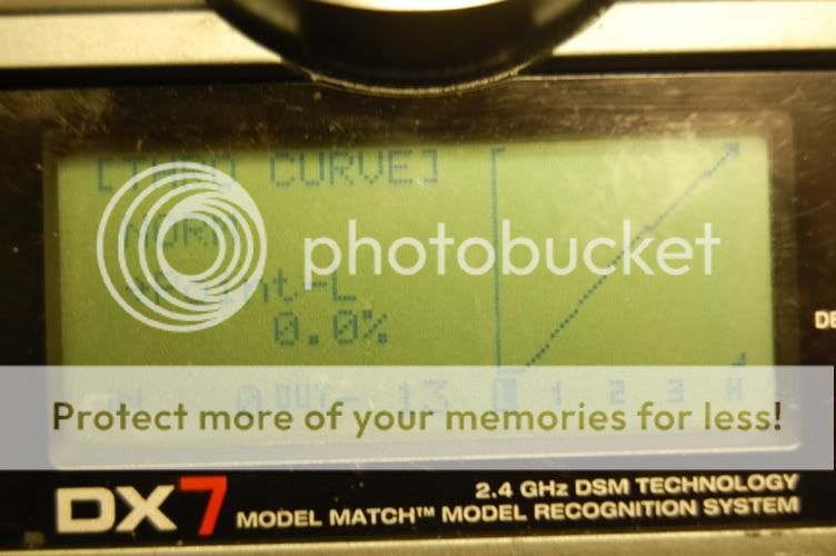

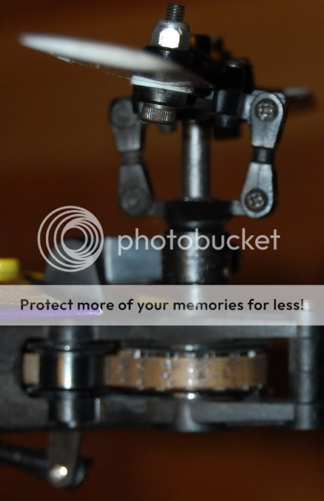

As promised, I've got the pics. Some are of what I've mentioned before, others are areas of concern. All TX screens are from my Spektrum DX7 as it was flown today. No changes have been made since before engine shut down on the last flight.
Tail at max left travel.
Tail at center stick.
Tail at max right travel.

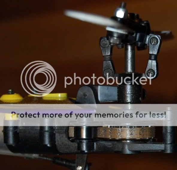

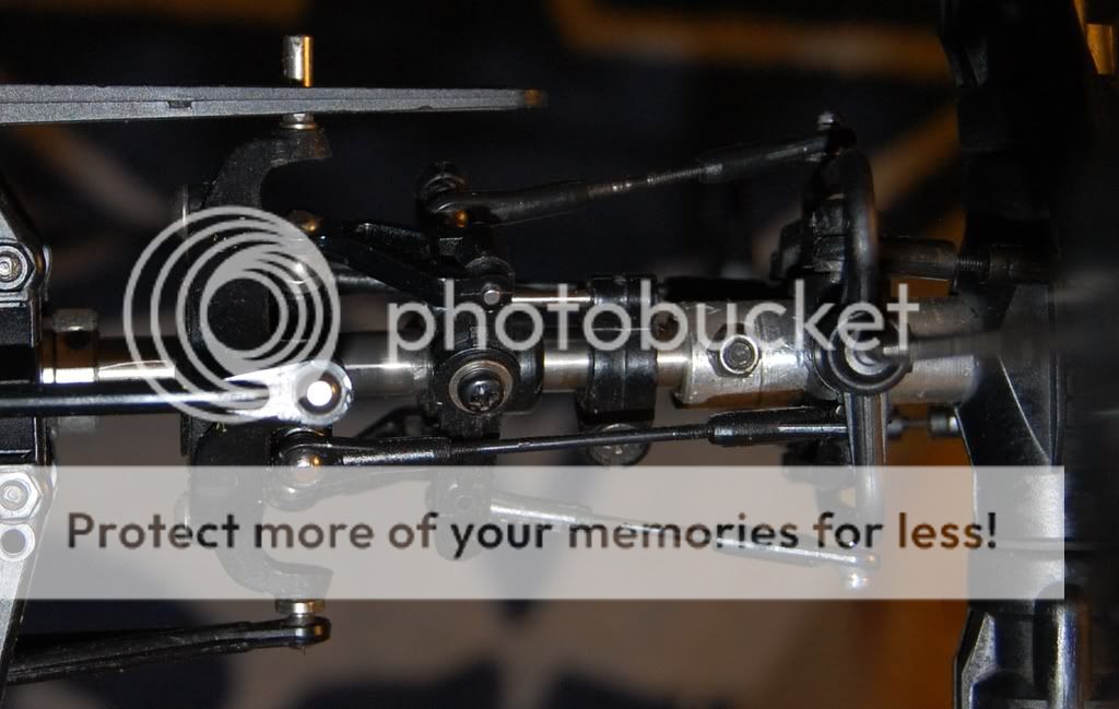

Flybar.
Flybar carrier side 1 pulled left.
Flybar carrier side 1 pushed right.
Flybar carrier side 2 pulled left.
Flybar carrier side 2 pushed right.
Rotor head detail.

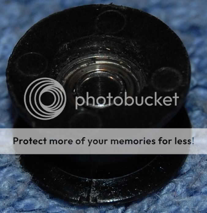

Main shaft.
Main shaft 180° out from above shot.
Tail servo and arm.

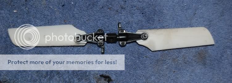

Tail rotor housing.
Tail rotor housing shot 2.
Slight bulge under tail boom at the base of mount. (area of concern)

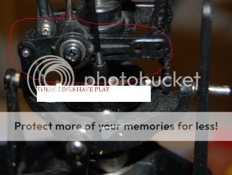

Links above swashplate that have play. Screws on both sides are tight.

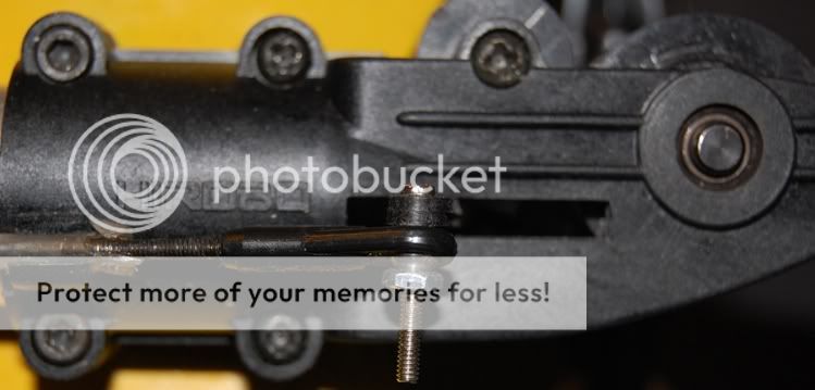

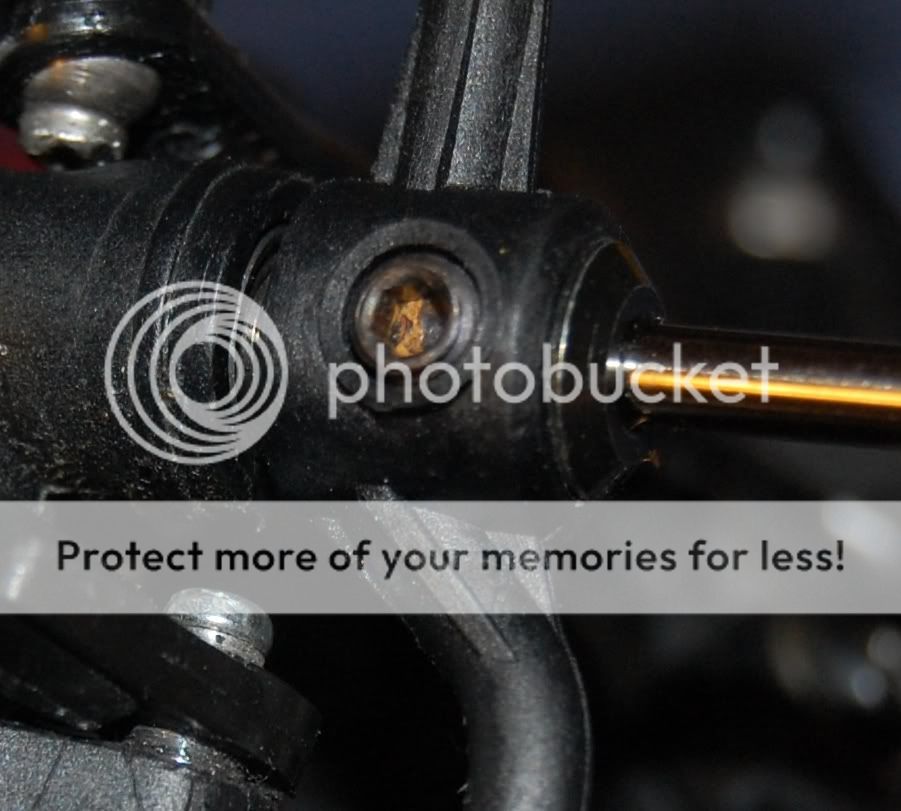

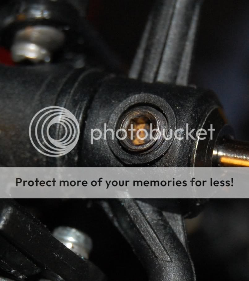

Tail rotor set screw position. Before shows where it was at before today. After shows where I put it before today's flights.

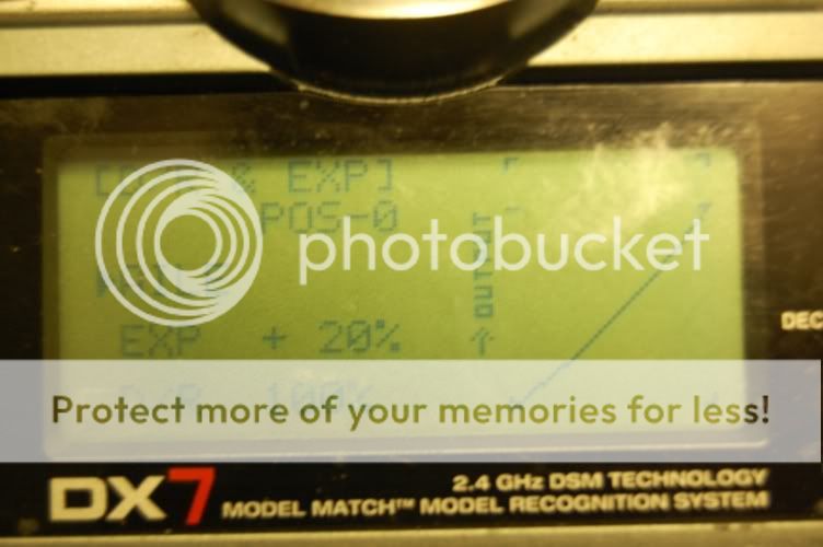

Aileron Expo screen on DX7.
Rudder Expo screen on DX7.
Elevator Expo screen on DX7.
Gyro screen on DX7.
Normal mode throttle curve screen on DX7.

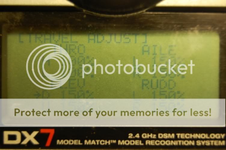

Travel adjustment (servo end point adjustment) screen on DX7.
Sub-Trim screen on DX7.
Servo reversing screen on DX7.
Shuttle model memory main screen on DX7.
If there's any other parts that may need some attention that you might need pics of, please let me know and I'll get them.
Thanks again and happy flying.

Sounds like your catching up with it. My brain is a bit fried this evening so I'll do my best to give you thoughts.
First the tail rotor drive shaft has those drilled detents (holes) you see to lock the tail hub in place. Something slipped or the allen came loose or worse yet the tip of it sheard off in the hole. Older Shuttles had one detent hole in the shaft, newer Shuttle plus has Two dentent holes. If you look at the manual it will tell you to use the inner hole for the shuttle plus. Actually if the tail rotor hub was slipping on the shaft your lack ot tail rotor control may be from an actual loss of rpm when the blade tried to bite the air. Something is very wrong back there. I'd pull the whole mess apart and check every part. The pulley, bearings, pitch slider clearance, check the lock allen screw in the tail rotor hub , checke the tail drive shaft for scoring and the blade grips and all the bearings. They probably could use some lube anyway. Make sure you put the allen screw into one of those detent holes when you put it back together or it will just slip again. I use blue loctite on the specific screw and have had no problems.
The tail rotor push rod should have a slight bend to the left as it exits the plastic guide at the tail rotor housing. This keeps it from binding up at its full forward travel in the slot. Look at the manual for the Shuttle Plus set up and you well see what I mean.
As for the the paddle bar and cage on the rotor head. I set that up with my trusty MM ruler, you should not have that gap where it can slop back and forth. The best way to set it up is to remove the paddles and measure so you have equal lentghts of bar sticking out of each side with the cage pressed frimly against the bearings in the seesaw. Then lock the allen screws down. I then measure in from the end of each bar exactly 25mm like the book says and put a peace of tape on the paddle bar at exactly 25mm on both ends. Now screw the paddles on until they just touch the tape and then measure from the cage to the paddle on both sides it should be the exact same distance. It works perfectly for me every time.
I think its time to take the individual head parts and remove the links so that you can feel each component for bad bearings. Check everything including the blade grip bearings. Check each component by itself. There are tiny shim washers that sit between the bearings in the washout arms and when they crush sometimes it allows the innerbearings to bind up, so check everything.
Dont give up on this helicopter, youve learned tons so far. What is causing you problems now is that your seeing the results of not completely dismantling a heli when you buy it used. You really have to take them apart and build them just like it was a new bird..................which is exactly what you are doing now!
I am quite thrilled that you have made it this far and am sure others reading this post feel the same.
If you buy an ARF its just going to need the same things sooner or later.

After answering your post above I couldnt resist a second look but a few things caught my eye.
That allen screw in the tail hub doesnt look like its engaged in the detent, the two holes should be in line with eachother and your hub lock screw is not lined up with either one of the holes.
Be very careful on the outer hole of the shaft. if you go to far towards the tail housing with the pitch slider the pitch links can go over center and the blade will flip flat in flight causing untold havoc. The older shuttles had a piece of silicon tubing slipped over the tail rotor shaft and pushed against the bearing to stop the pitch slider from moving to far inboard. You should use the inner hole on the shaft, just make sure its engaged properly, loctited blue, good and snug.
I'm seeing you have tons of subtrim in your rudder and throttle servos. What is the reason for that? The subtrim on the rudder might cause alot of gyro issues. I know my JR410 gyro only wanted a few points of sub trim to keep it from creeping at neutral. 125%seems like an aweful lot.

Thanks for the great advice as usual. I'll be diving into a detailed teardown and recheck of everything after a little while to check for the items that you mentioned and then some.
I know I should've done a complete teardown and rebuild when I first got it (other than just repairing the obvious). I've done it on the electrics that I've bought used (my e-Flite Blade CX2 and CP Pro, which BTW is experiencing some electrical difficulties that I'm having a difficult time tracking down, as I seem to be the only one experiencing this issue]) However, my excitement got the better of me, and I couldn't control it.
For the massive amounts of rudder sub trim, that's what it's taken to keep the tail locked in at neutral stick. The primary rudder trim is nearly maxed to the right as well. I've tried neutralizing the trims and sub trims, but it still seems to want that much trim to stay straight.
BTW, if you come back to this thread and see that some of the pictures are gone, I'm re-arranging them on Photobucket. I'll have them back up soon.
I understand how you feel. I feel that way quite often in my line of work. Get some rest and don't worry about my problem until you feel like coming back to it. You've been a huge help so far and deserve a break.

Okay, you found some great stuff on your tail rebuild..........actually awesome stuff.
You have found the standard issues for the tail.
The blade grip pitch screws need to be loose enough so they dont bind. It goes back to breaking things down to individual components making sure each part is working perfectly. The slightest thing matters here.
The tail shaft and bearing is a high wear area. That is why I went with the quick UK aluminum pulley and stainless saft. (needed to drill the second detent in that shaft but it was easy to do). They dont wear and trap the bearing in the wear groove like your seeing. Bearing is toast, you can use Hirobo which are quality but pricey or just go to Boca or RC bearings. Your left tail rotor housing has a piece of plastic broken off where the tail push rod outer tube is supposed to go. Noticed that in your photo from yesterday.
The tail blade holders are normally kinda loose on the Shuttles. At high rpm they stay where they should and track nicely. The thrust bearings in the blade grips are interesting in that they have different size holes in the upper and lower race. They go on a special way but you need to see the manual as to the direction that the race with the larger hole goes. I found that pressing the bearing between your fingers and turning is a good way to feel the bearings for wear and notches. The hold up quite well, just give them a good lubing and install in the correct orientation.

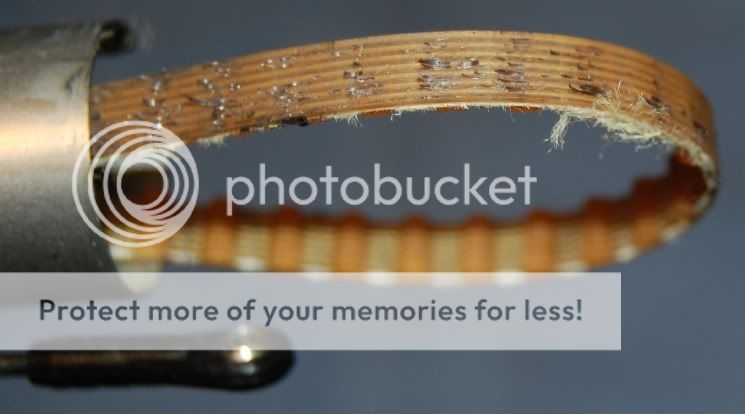

Your tail belt is WAY WAY WAY WAY WAY too tight if you can play a couple of cords from Van Halens Eruptoin on it!!!!!!! You want it snug enough so you cant press the belt from one side and make it touch the other at the forward pulley with gentle pressure. Loosen it up and again, check the manual for the proper tension, there is a picture to guide you.
sounds like you do need a few parts to get a good fix. Good time to check if the tail pulley and shaft are bent. I found putting one end GENTLY in a cordless drill and spinning it slowly will show any wobble or bends quite nicely. I have about 4 bad ones already before going to the Quick UK.
That bulge in the tail boom looks like it may be from a hard landing, or due to the tail belt being too tight or both!
Okay, I'm going to leave you with that info for now. You'll get her flying, I've been here many times before...........and so have alot of others!
I'm going to sent along a photo of my tail set up if its not already posted above somewhere.

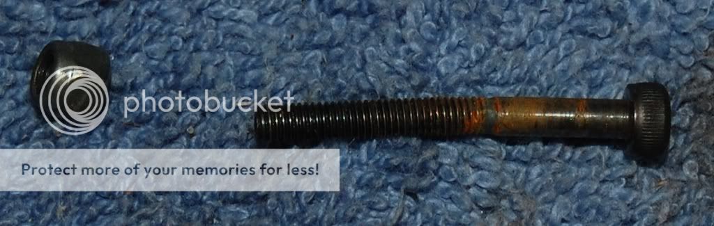

As promised, here are some detailed pics of last night's teardown.
Bent main blade mounting bolt.
Assembled Tail Rotor
Tail Belt
One tail rotor blade/grip.
Other Tail rotor blade/grip.
Outside of the tail rotor housing.

Tail Belt Tensioner Pulley.

Good find on that bent bolt. That would tell me to check the blade grip bearings next. Do the spindle check by turning one blade grip inner not and watch for wobble on the other side. You might want to look into replacing rubber dampers that the spindle slides through. They come in a pack of 4 and tend to go south over time.
Start checking all your washout linkage bearings and pivots in the head, including the elevator pitch linkage and the aileron bell cranks. If they seem tight it may be that the thin washers between the inner and outer bearings of each link have crushed down and cause the inner bearings to bind. The fix is to buy a few backs of shim washers from Hirobo and start putting new ones in. if the bell cranks are right you can spin them like a propellor and the stop with the heavy side down. Free swinging is what I shoot for on the se
I think you should take a look at the tail boom where it enters the frame and make sure that alignment pin is there. its just like the one inside of the tail housing.
The tail belt idler pulley in the picture goes on with that open bearing face in a set direction, look at the manual to see which side it faces.
