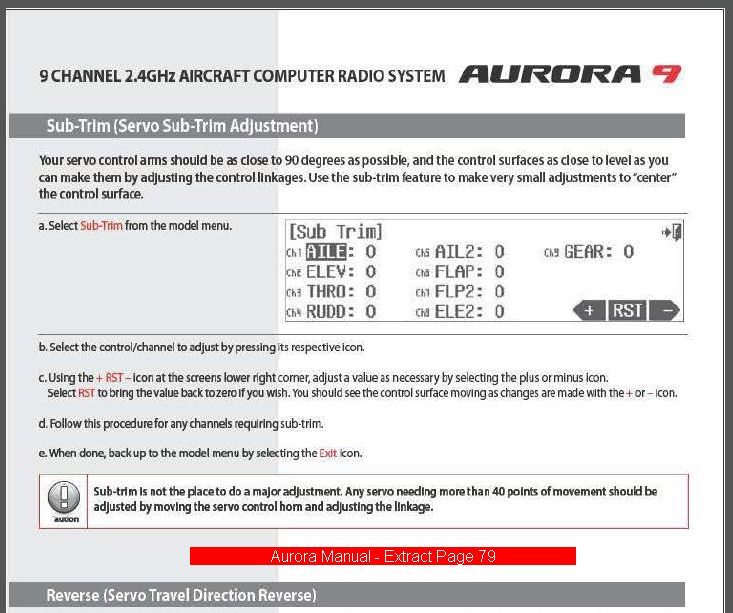

Further to above and answeringquestion on another thread:
Sub trims are only used whilst model is being set up -
should never re-adjust sub trims at a later time without a re-set of that model program and start over.
(ex manual page 77)
• There are two screens to the EPA menu. Note the 1/2 Icon.
• The EPA range is O% to 140%.
• Sub-Trim and Dual Rate functions can Impact the programmed EPA values.
Aurora 9 - Programming Chart and attached extracts from Aurora manual may assist.
Whilst written at time of Futaba FF7, 8UAP, Eclipse, Optic 6 etc., believe following is still relevant:
EPA & ATV - Dual Rates differences & Cautions
Service Bulletin TX-20100520 Aurora 9 Transmitter - Using EPA and D/R Functions Create Dead Zone in Stick Travel
We have confirmed customer reports of a software bug involving the End Point Adjustment and Dual Rate functions.
When both functions are at their highest settings, there is a significant dead zone at the stick endpoints.
Until this issue is resolved in a future software update, it is advisable for customers to keep either
the D/R or EPA setting at 125% or less and the other at 120% or less.
Alan T.
