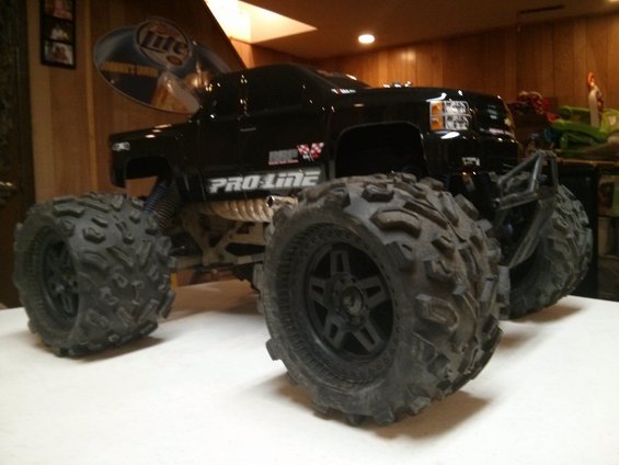

Hey guys new to the site I've got a savage x ss originally 4.6 but upgraded to 5.9, even before the upgrade I had issues witb rear diff so I upgraded to 4 bevel gear set and still blew it up, I havent pulled it apart yet to see if it was the spider gears or the ring and pinion yet but I was wondering if there's is a complete replacement unit or chromoly parts available? I've been searching for awhile outside of the forums and now im here searching for help

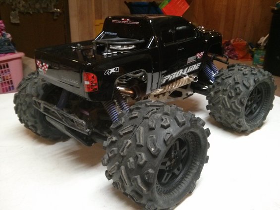

I haven't "jumped" it, it does however catch some air due to the variations of the ground I'm running on. So yes there has been moments where it has had time to get some hard shocks sent through the drive train from wheel spin. Heck I haven't even kept it together long enough to get it tuned for the weather of the day
Here's some pics of the truck for the heck of it

I'm sure the oversized tires don't help

I'm guessing its the slight air you are catching compounded with the tires.
Basically the more rotational mass the more stress on the diff when landing.

I know those tires look big but they are surprisingly light. I like mine.
If you have 2 bevel gear diffs and by the look of that pipe you have a truck from 2005, allot has changed since then. A 5.9 in a truck that originally had a .21 or .25 engine wont hold up for long. That pipe is the worst ever, get anything else and it will be an improvement. That pipe is for low end power only, does not have anything for proper top end power.
So to sum it up; you have a truck with the drivetrain for a .21 engine with a 5.9, low end pipe and slightly heavier tires than stock, driving around on bumpy ground. No wonder you're having problems.
