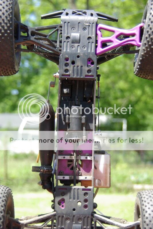

Today I hit my Savage X very hard and I break many things. What replacement parts do you recomend for an upgrade? Here are some pics of my destruction
I know that the first thing that I need to replace is the driver , but for now do you recomend me to replace the TVP with the XL's?
What do you guys thing about this?

Looks like to me your main problem is that you are using the aluminum arms. I know the look "bling" on there but there is no give in them. So when you landed wrong there was no area for it to flex except at the hinge pin. So I would go back to the stock arms first.

I'm not a fan of alum either.
If you don't have the stock arms and need to buy some I would just go with RPM.

yeah i gotta say it looks like 90% of the cost could've been avoided with a little flex from the arms the stock ones are really flexy you can bend um by hand pretty easy and while its nice to get the shinyness of AL and the stiffness i must say i'd rater blow a $10 part then my tvps pin, pin braces, bulks and other things...

Innovative-RC 7075-T6 hinge pin braces will keep your bulkhead together, though I would still recommend ditching the aluminum arms.
Innovative-RC TVPs are the strongest replacements you can buy.

Here's some beefy Ti pins.
http://www.lunsfordracing.com/mm5/me...gory_Code=HPIN
I noticed the link you gave was for really long TVP's, way longer than the XL.
If you are going to lengthen it might as well widen it too.
Here's a dicussion that has some info on that.
http://www.rcuniverse.com/forum/m_8931720/tm.htm
I might also be wary of that kit you posted, it does not come with a beefier engine plate, but comes with a skid plate.
Says "lifetime warranty" on bones but how long are they going to be around?
Just thought the link you posted might be questionable.
I myself would just go with some XL length tvp's and widen it.
http://www.hpiracing.com/products/en/100413/

Thanks for your advised. For now I will go with the RPM purple control arms, the Innovative TVP looks great and very durable, but I think that I will go with the HPI XL conversion kit and save some money, but what about the front differential case?

I would just get a replacement HPI diff case, and buy the 7075-T6 braces I linked to. The hinge pin braces must fail in order for the differential case to be torn apart, and the HPI units are not made from a very good aluminum alloy. The Innovative-RC braces would have likely prevented most of the damage cause by your crash.
My stock XL arms handled some insane abuse before I put an (1) RPM arm on the L/F lower after 6 gallons.
So I guess they still use some decent material.
It was cracked at the hinge pin for a gallon or so before it broke.
And I screwed it back together for another few runs.
The material is still quality, but it is somewhat more brittle and prone to failure. The new HPI arms will take quite a bit of abuse, just not as much as the original ones. RPM didn't even make Savage arms when the original pre-X platform was out, because the stock arms were so strong. If you e-mailed RPM inquiring about Savage arms, they would tell you that they have no plans to manufacture them, as the stock arms don't break enough to warrant producing replacements. They only began selling them about 6 months after the X came out. I have never damaged an original arm to the point of being unusable, and I tend to break a lot more parts than most people.
