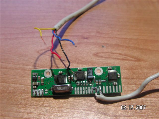

on my areo fly pro delux cable on the usb side, two of the wires came out! i removed the hard plastic cover to inspect, they simply came unsolder, all 4 wires blue,red,black and yellow are solder in a row on the little curciut board, dose any one know the color order so i may solder them back into the correct place? thanks

Should be red, green, white, black? Email me a photo of your circuit board.

here is some pics of the board

The correct wiring sequence for the usb interface cable is
red - blue - yellow - black
starting at the outside / corner of the board.
