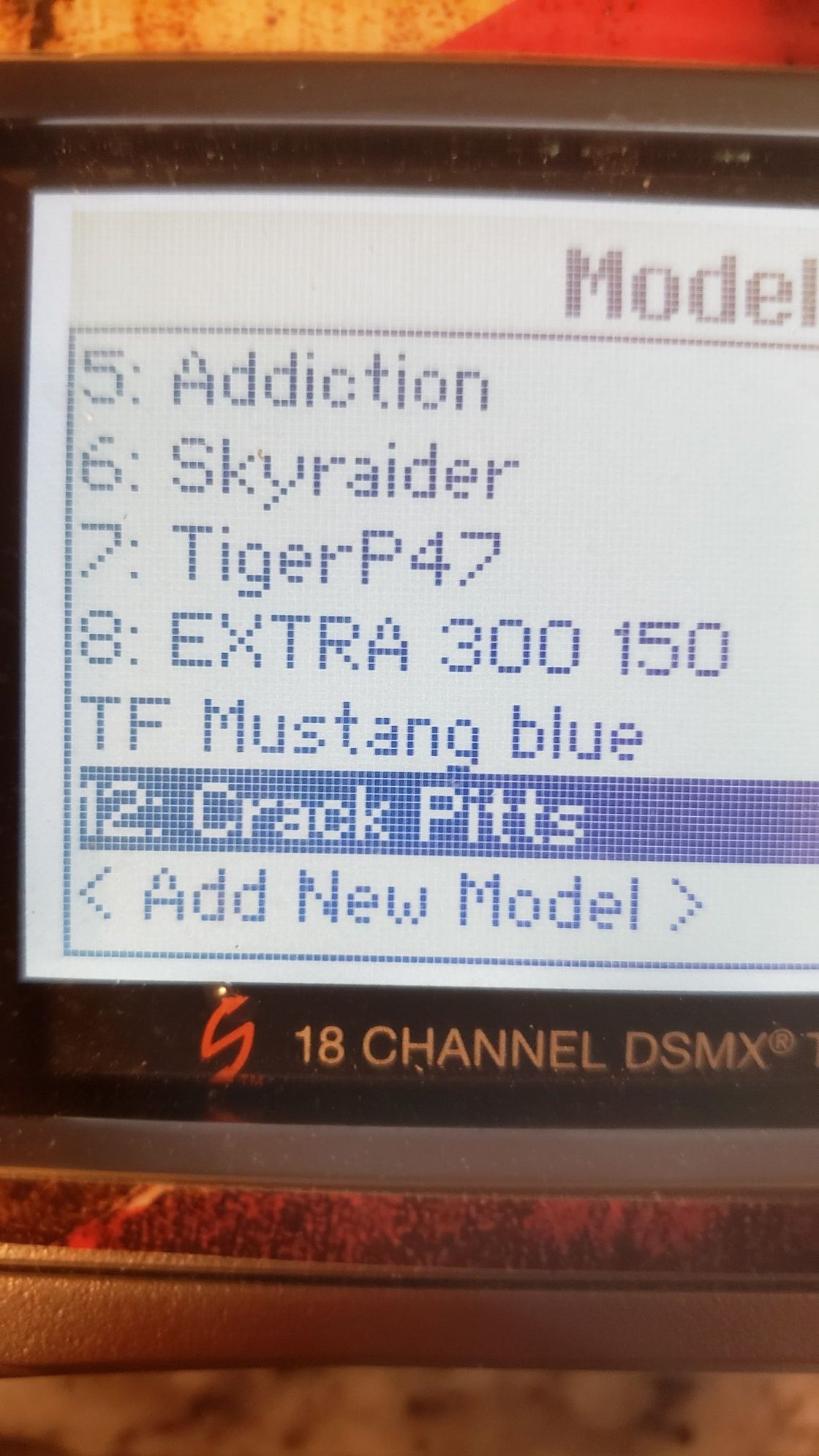

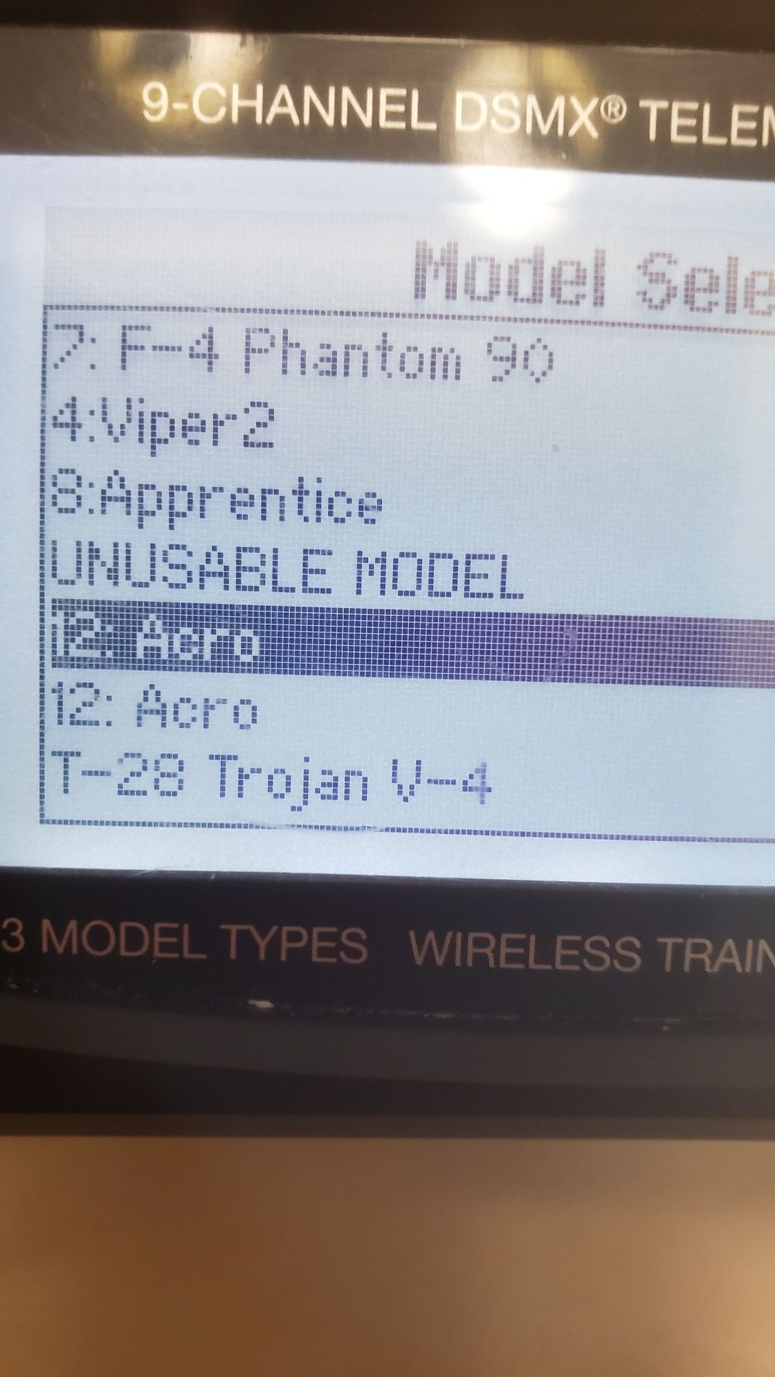

I just recently updated my DX-18 to the latest firmware so I could add a model that I purchased. The upgrade went well as did the model add. but lately my models are all jumbled up. I now show and unusable model? I show two different models with the same number? I also have the newest model I added from the sim card shows no number. It has never done this before.

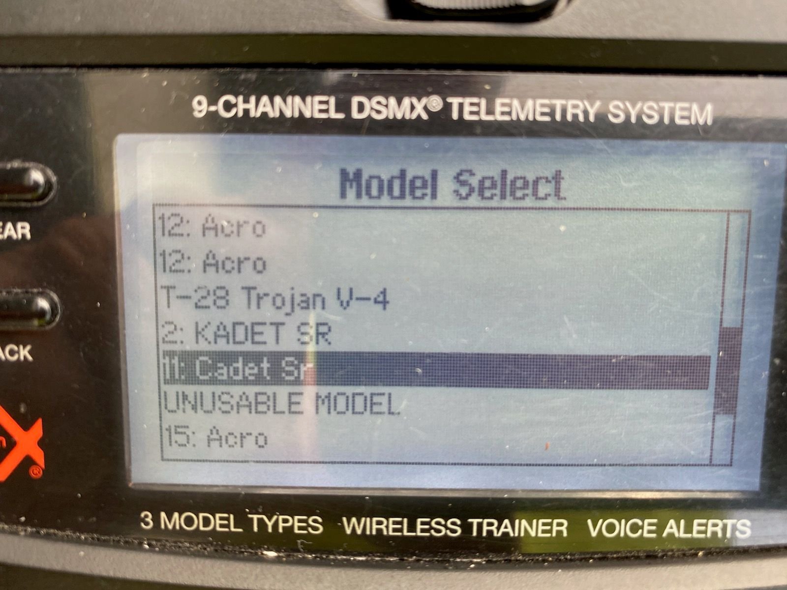

In addition a friend of mine who has a 2 year old DX 9 (not upgraded ) is having a similar issue. His models are all out of order.

Go to Model Utilities.
Select "Validate All Models."
Give it a few seconds, and the problem models will be resolved.
If you have duplicates now, that's because they were made as copies. You can rename them.

I did this and it cleaned it up but the TF mustang still has no number and should be # 9 in the order it is in. It even says that when I select it and it prompts me to except with yes / no. my next model in the menu is 12. No 10 or 11? My OCD is driving me crazy with this...lol

The number is JUST A NAME! There is no number there, unless you forgot to edit it out when naming the model. You can insert it using the Model Name function (details on inserting a character should be in the manual - basically you insert with a < _ > and delete with > < .
You can sort them into ANY ORDER YOU WANT - it's on the Model Utilities list to do that.
