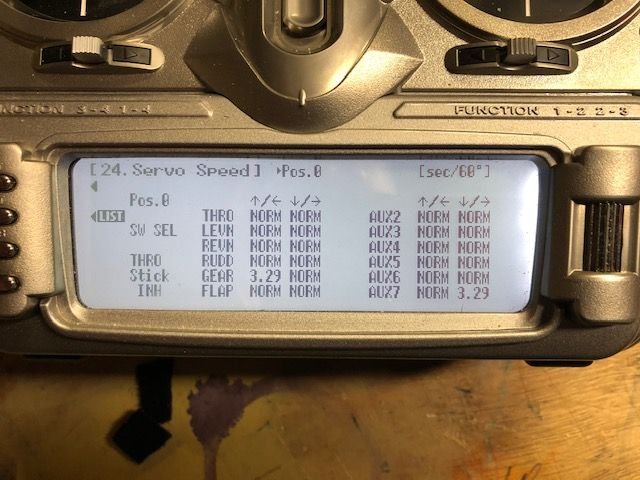

Hello, looking for guidance with a program glitch with my JR 12X and Spektrum 12310T receiver.
Flight mode is on flap switch to allow independent trim setting of ailerons and elevator for normal flight, and separate trims for mid and landing flaps.
I am using a normal mix for sequencing the gear with the gear switch as the master and Aux 7 slaved for the gear doors.
Flight mode works as it should with trims independent of each other in normal, mid and full flaps position.
Mix of the gear switch and aux 7 works as it should for sequencing the gear and doors.
Gear and door sequence works as it should with flap switch in normal position. With gear down and mid flaps and or full flaps selected the mix does not work and gear hits the doors when I try to retract the gear, basically both gear and doors lose the sequencing and actuate at the same time.
moving the flight mode to another 3 position switch does not correct the problem and I lose the trim function.
So, how do I keep the mix active with the flight mode/flap switch activated?

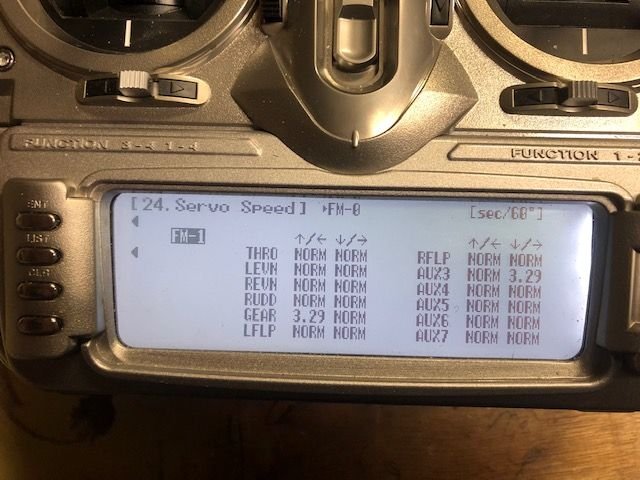

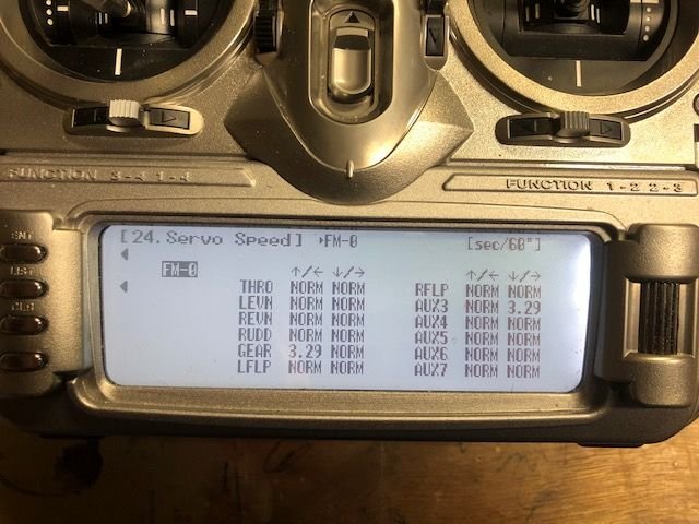

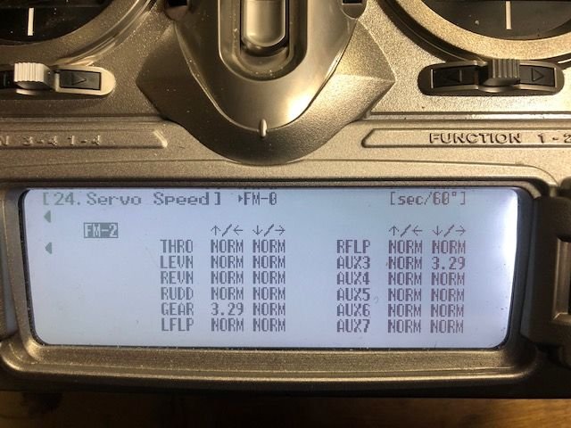

Success!!!!!!!!! It was something very simple!! When I was setting up the sequencing for the gear and doors, using the servo speed function I did that before I applied the flight modes There was no option on the servo speed screen for the flight modes then. I went back to the servo speed screen after setting up the flight mode and Viola! there were options for servo speeds for EACH flight modes 0, 1, and 2! Just what I needed!!! activated the sequencing for Mode 0 which is flaps up for normal flight, Mode 1 for takeoff or mid flaps and Mode 2 for full flaps. Wish I would have seen that yesterday
Anyway thanks for the help and keep them flying!
