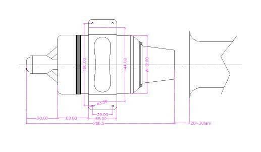

I my Skymaster T-33 I have a fairly loud high pitch whistle at high throttle settings. I've been told this could be very dangerous.
Here is a video that you can sort of hear the whistle on take off (at 1:10 min) and when I accelerate to do a roll (at 2:30 min). For some reason the whistle is a bit muted in the video. As I remember it was a lot louder in person.
I've been told that it could be due to the exhaust tube bell-mouth being too far from the back of the turbine and that hot exhaust was recirculating back to the intake.
I opened it back up to see what I could do. Please see the attached photo. The exhaust tube bell-mouth is actually slightly overlapping the rear of the turbine by about 1/8 inch. I am now wondering if the bi-pass is too tight a fit on the turbine. At the front of the bi-pass where it necks down it is 1/4" clearance. At the widest point it is 1/2" clearance. Should I remove the bi-pass and give it a try?
The settings are all set to the default for diesel fuel except I reduced the max rpm to 114,000 rpm so as not to overpower the plane.
Please let me know what you think,

you should be able to find the exact recommended distance from the exhaust tube to the pipe. It is generally in the 3/4 to 1 inch range. But this distance is measured to where the straight part of the pipe starts. The bell does not matter. It appears in the picture your turbine is too far from the pipe.

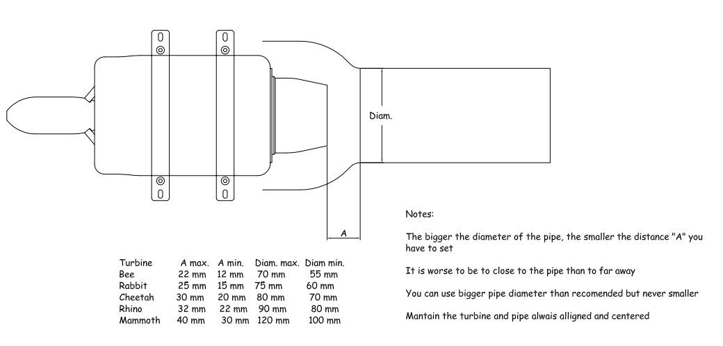

Thanks for your reply. I can move the pipe up 1/2" with no issues. It make sense now but looking at the KT manual it shows what I thought the small flair out was the bell-mouth. After checking with other turbine manuals they clearly show the distance to the end of the straight pipe as you say.
Here is Kingtech for the 210.
This is from Jet Central

That is the pipe distance NOT the bell mouth. Pretend the bell isn't there.
Old 04-07-2018, 11:42 AM
rcflyguy_26
My Feedback: (8)
rcflyguy_26's Avatar
Join Date: Mar 2002
Location: Findlay, OH
Posts: 524
The kingtech drawing shows the pipe entrance.
You used the bell mouth entrance.

Your engine is way to far forward from the pipe. Move it back one inch from the pipe. Don't include the bell mouth

I ended up moving the engine back. It was a lot more work then moving the pipe forward but it will give more clearance between the front of the turbine and the bypass. I also keep the rear end of the exhaust tube in the scale location. Actually I needed to move it back only 16 mm (5/8") to be at 30 mm from the forward end of the tube. This is the max recommended in the manual.
