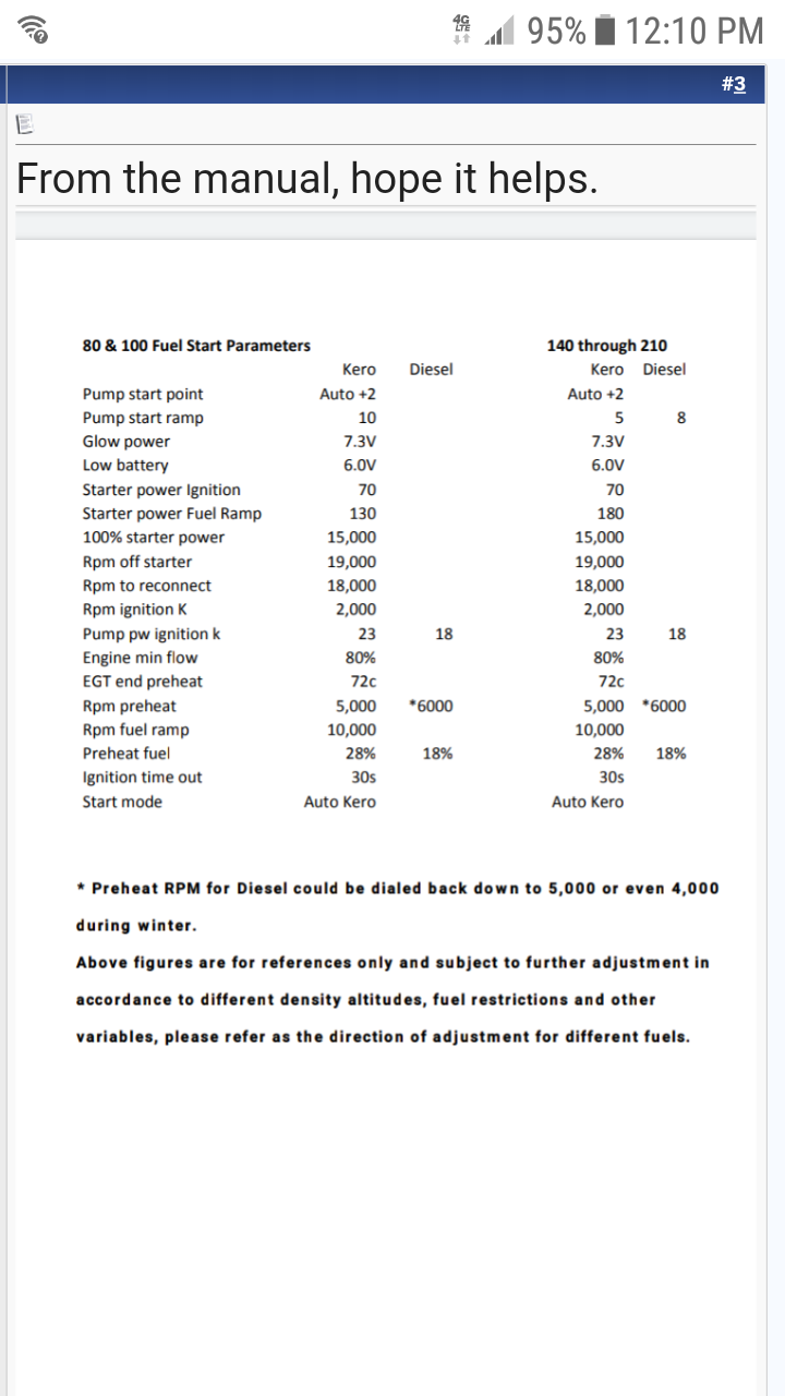

Here is part of the G manual, there you can see what needs to be adjusted when runing kero or Diesel, the adjustments are minimal and just needed to get the engine from zero rpms to idle, after that it's all the same.
I believe your E model replaced parts are the same as when new, to be able to run an old engine with diesel physically nothing has to be done, as mentioned before, I have a 18 to 29 years old engine that I got new, I used Kero from HD till 3 years ago when I switched to Kero from the pump then about 1 1/2 years ago it run it with Diesel, no adjustments needed, zero adjustments then I didn't like the smell or smoke and switched back to Kero, no adjustments needed, two numbers change when runing Diesel, the PW on idle and max rpms went up by 3 points and the temp on idle and max rpms went up by a few degrees, nothing to be concerned at all, this is a result of the thicker viscosity of the Diesel, when I switched back to Kero those numbers when back down to where they were before.
