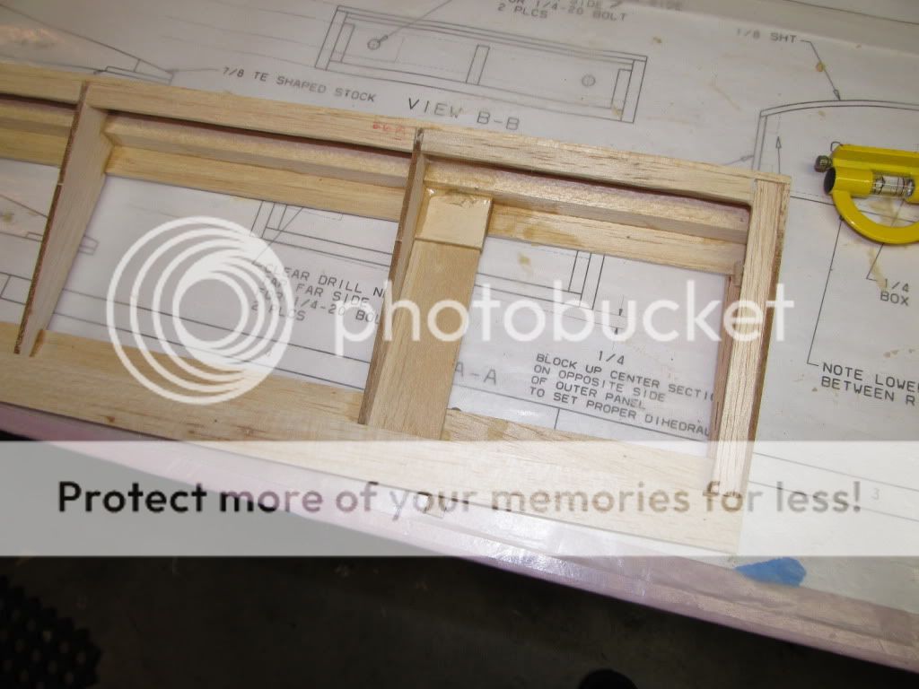

As a scratch-builder I was wondering what thickness of wood do they use for the ribs, and what's the rib spacing?

Good luck on your build. Sounds like you are off to a good start in getting the kit a Month sooner than I did!
Just a point to mention:
I found many threads that stated lost birds due to wing strut failure. I took the brass ends that are in the kit and tossed them away. I made full length aluminum struts by laminating 1/8" aluminum to 1/4" spruce with a top of balsa. sanded to airfoil shape.. Very strong. I also created a primary strut and a thinner smaller secondary strut (same construction smaller materials) and moved the strutmounting point from the center of the wing rib to just in front of the main and secondary wing spars. 1/4" ply laying flat along the wing rib holds 1/4" blind nuts for strut mounts. very strong. I use 1/4" aluminum screws in place of any nylon screws too!
Another point to ponder... I sheeted wings and tail to the main spar top and bottom... really add to strength. As you can see by photos I felt I needed it!

#54
These are a couple views of the strut mounts on the wing and Fuse.
On the maiden flight of this plane the engine cut out and the plane glided nicely down to about 10 feet off the water when it dropped.. the wings, struts and landing gear took all the stress and the only thing that I found damaged at all was the mounting eyebolts that hold the floats on, (I bent it back out and it was fine). We had a cub do about the same thing and it broke both wings off.

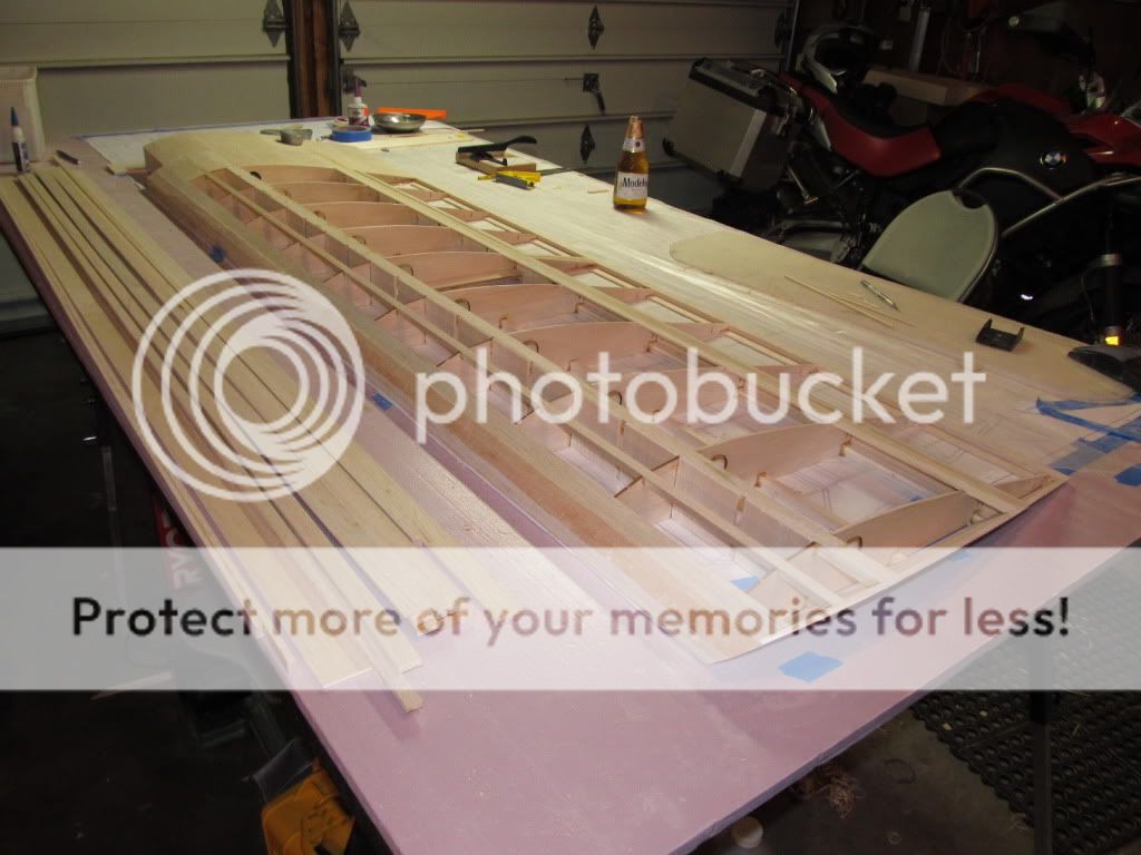

I'll figure something out. Got stiffeners on flap and aile yesterday, plus have ribs in other half of wing. This am wind was lower than predicted so I might not get much more done.

Anyway, here's how the flap looks with stiffeners added. Flexing it, I think it should be plenty strong. I don't plan on using the flaps except at low speed anyway.
Here is a shot of the wing, with the flap and aileron sitting in place. I think I will wait on hinges, servo mounts, and shaping leading edge until I have the other side built.
