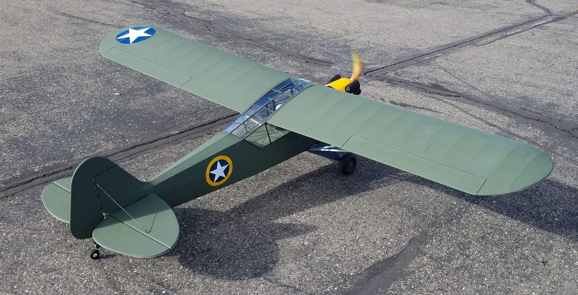

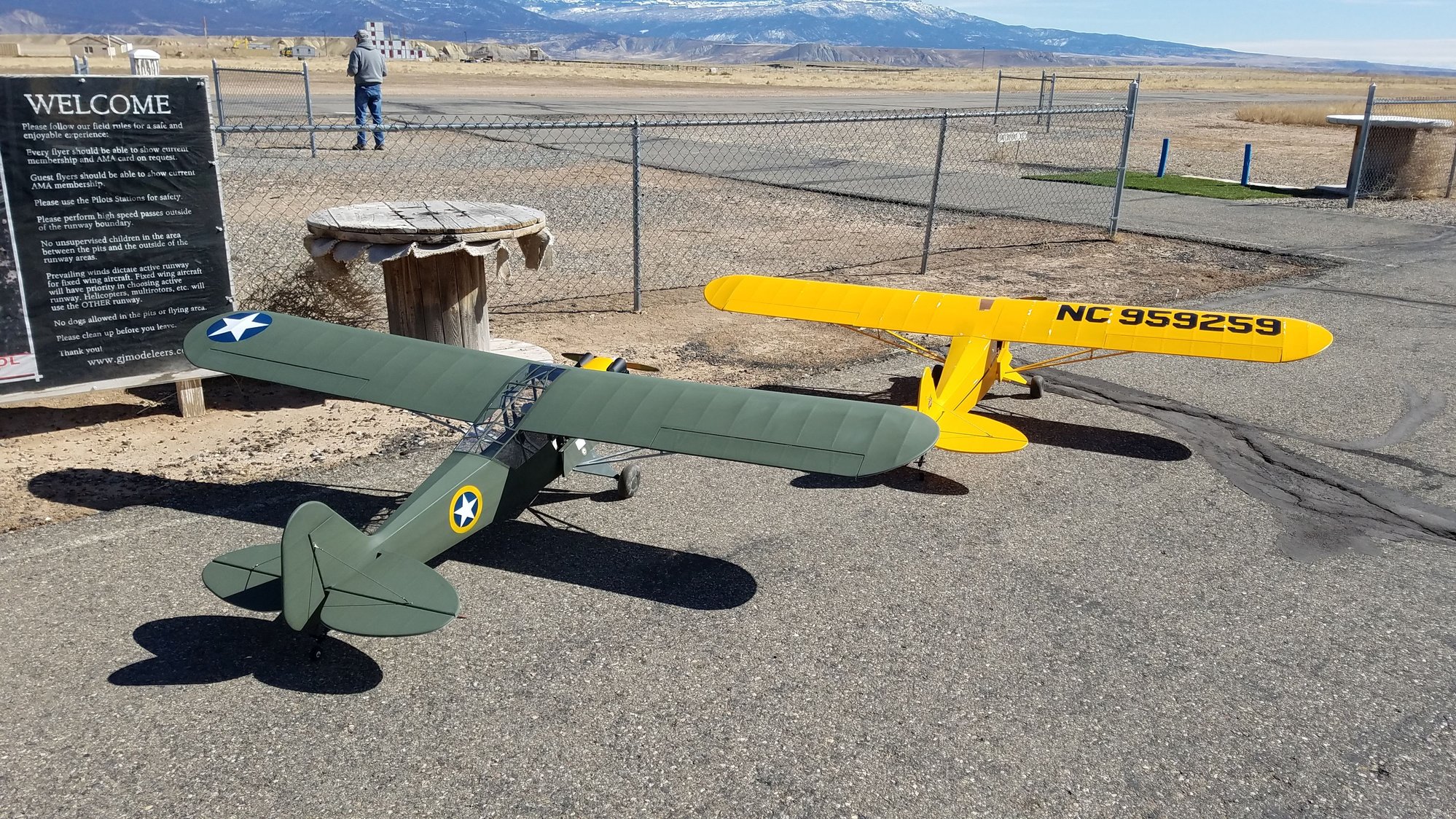

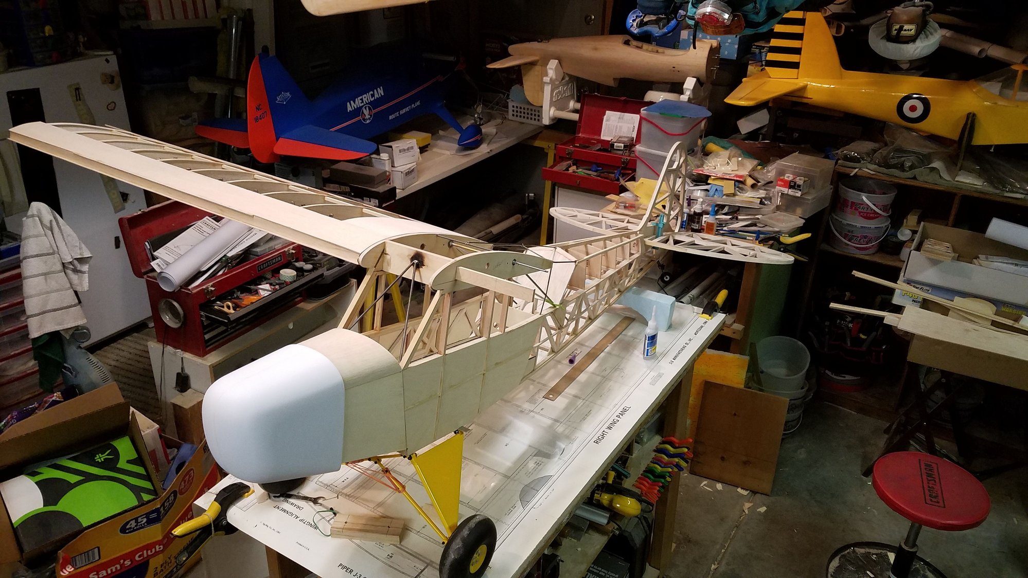

I recently did an l-4 from a sig 1/4 scale kit.
both sig 1/4 scale modified kits, j-3 has 420 flights, l-4 has 15 flights. both have opening doors from cub den ideas. l-4 is 1.5 lbs heavier
windows are 3/16 brass strips soldered together to cover music wire frame. stuck on with silicone
wings are built like the original plan but with both removeable from center section
this is the basic idea, music wire supports the center section to allow the wings to plug into the fusalage.

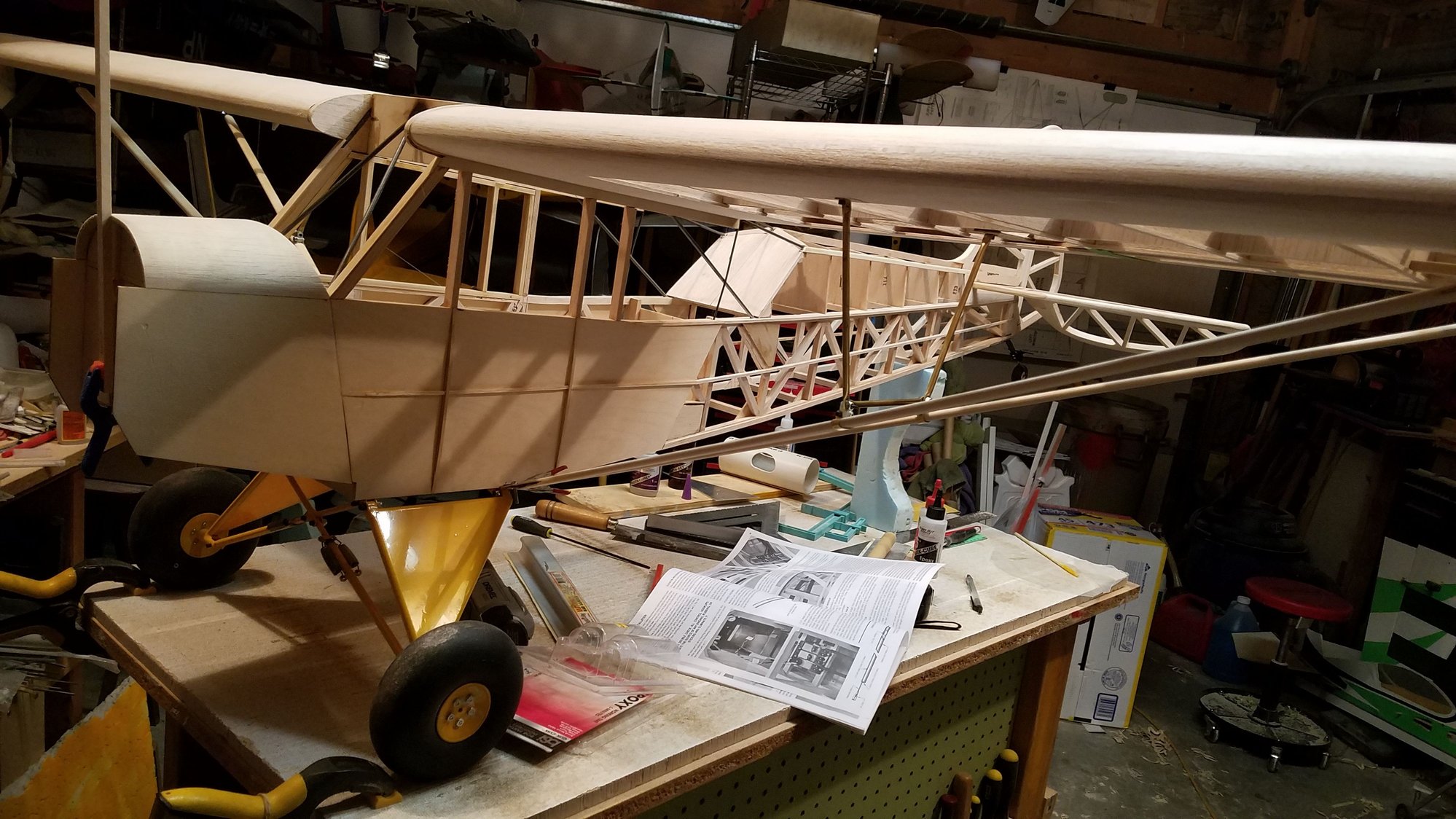

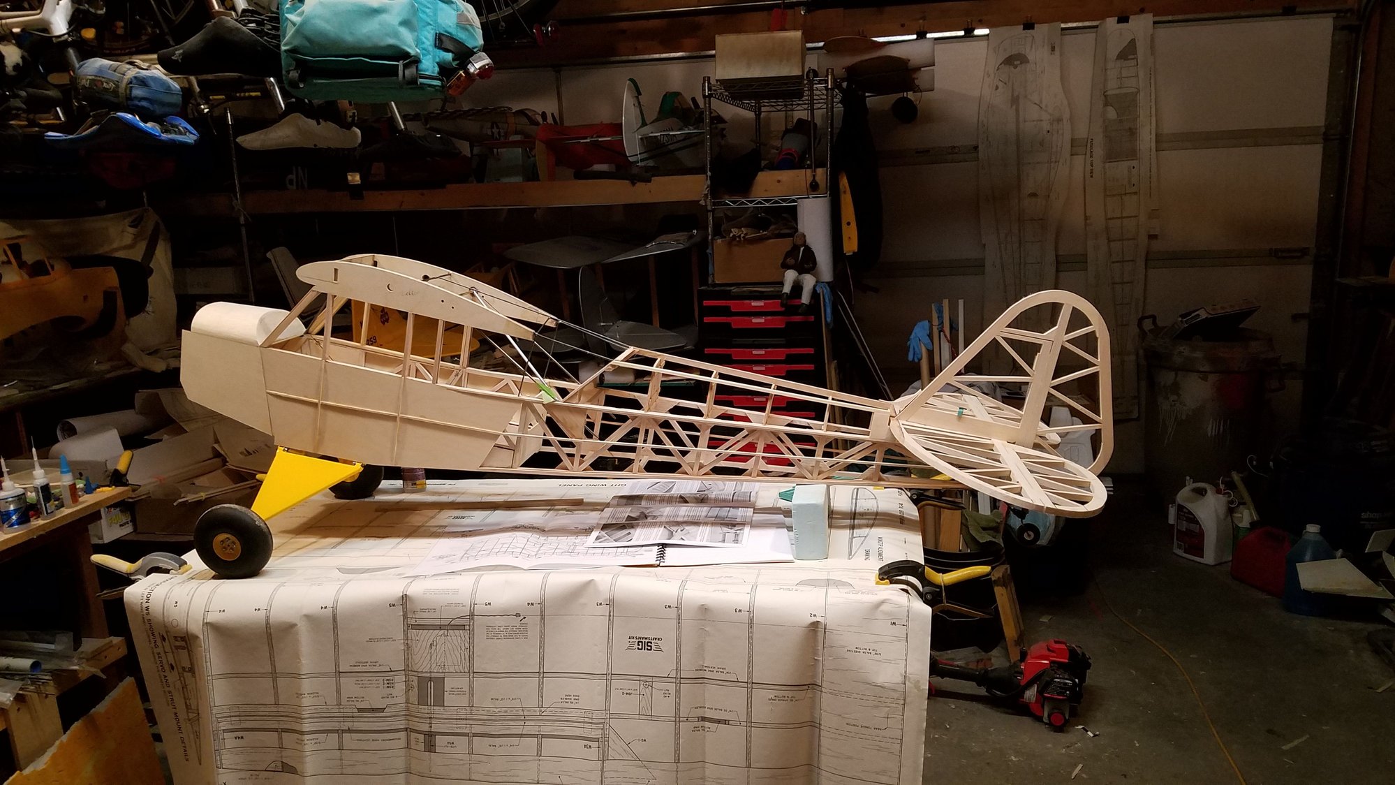

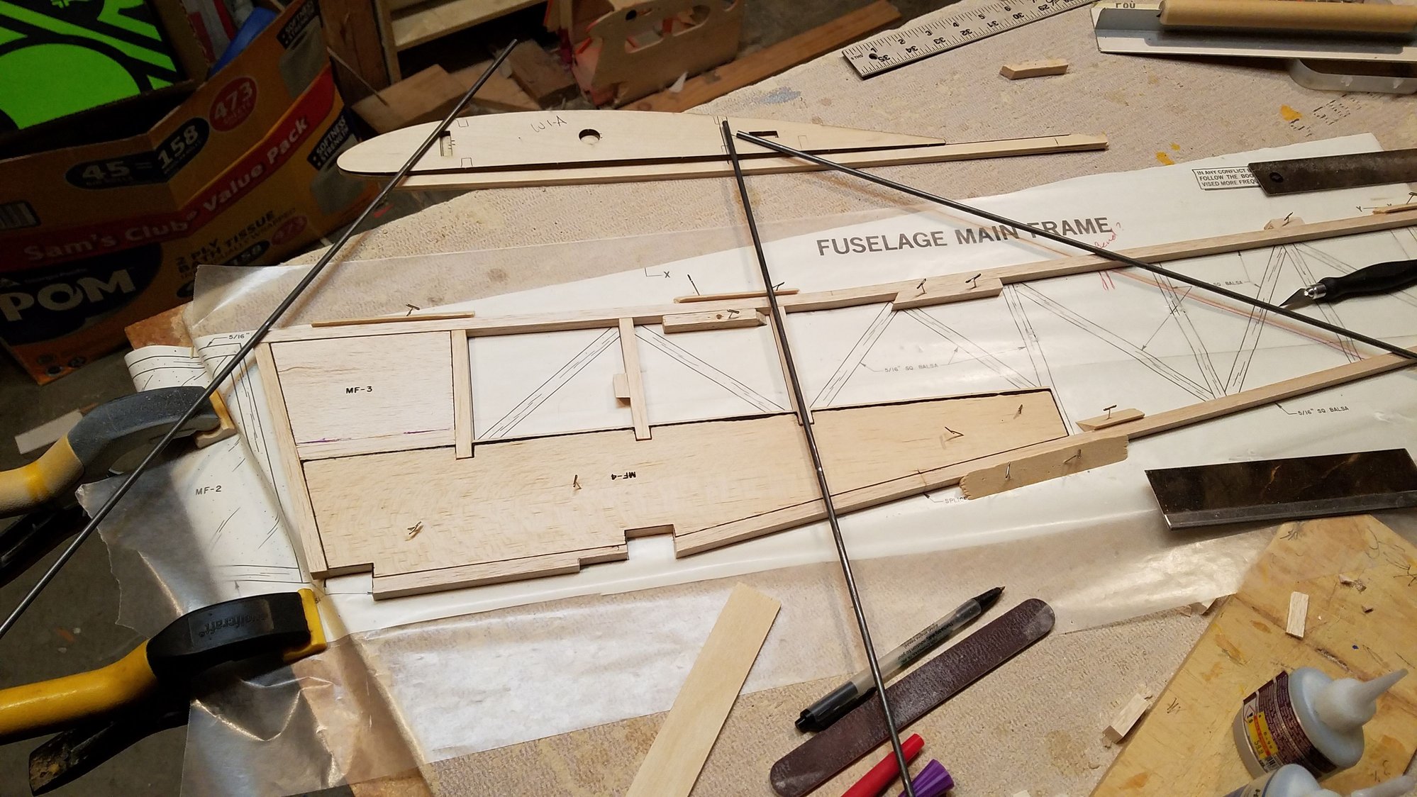

Bob feel free to copy me. the cabin top ribs got sandwiched between aircraft ply and lite ply
the formers will get removed after the fuselage is together. this shows the wires sandwiched between plywood
this shows a piece of brass tube with washers soldered on both sides between the ribs to space the rear of t3he cabin top. this tube will get a piece of all thread with blind nuts on the outside to clamp the rear of the cabin together when the wings are pulling on it.
the cabin front structure. the side wires will get sandwiched to top ribs like the rest of the wires, then they will get fitted inside wood framing.
rear cabin framing, wires are epoxied and soldered in place. aluminum diagonal tube is cosmetic and will get glued in before windows are installed
this shows the all thread and reversed blind nut that provides the rear wing support, I am using 2 wing bolts on each side and the struts to hold the wings on.
