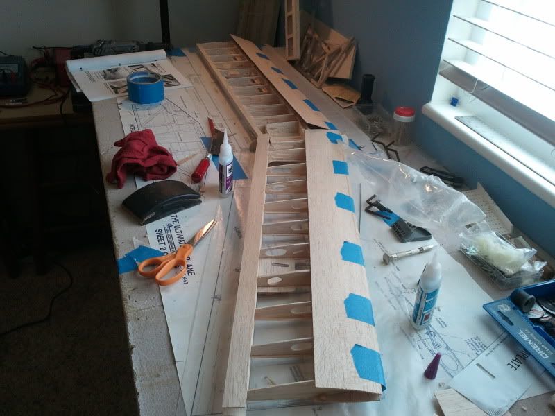

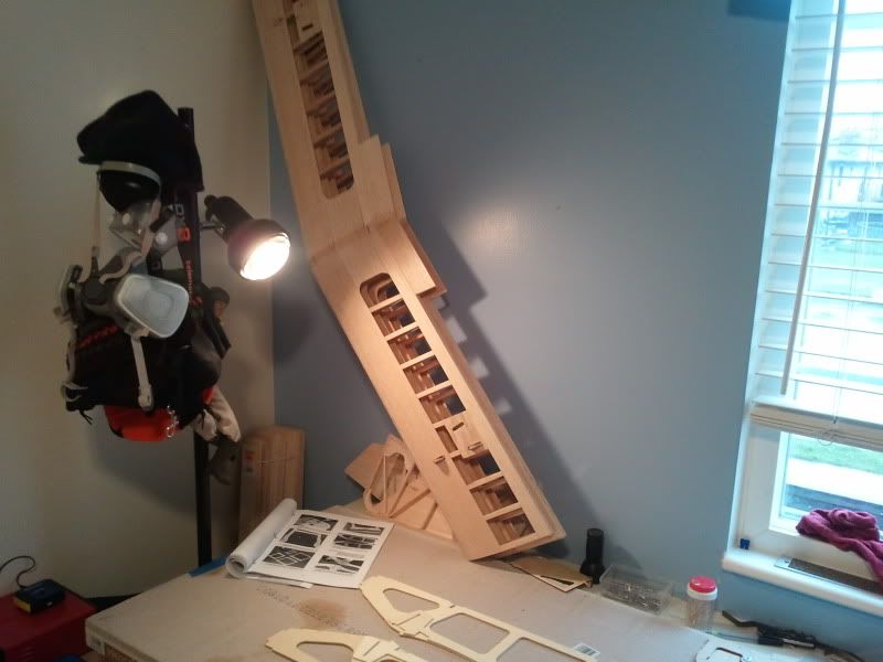

Working on shear webs and sheeting the bottom wing.
Extended webbing through the last four bays on each side.

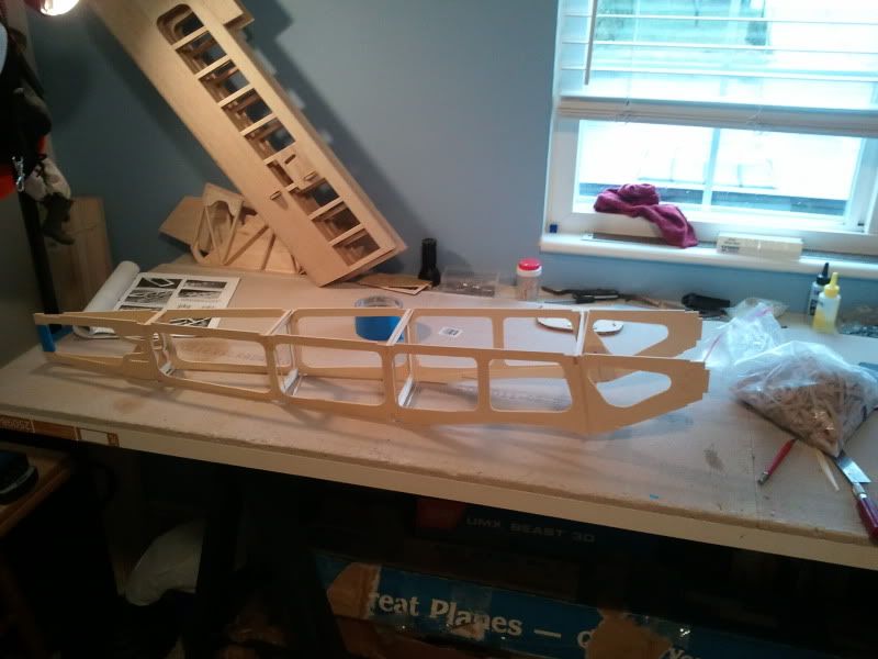

Finally got a chance to work on her again.  Sorry for the lack of updates.  I've been busy working and spending most of my free time trying to get my first big gasser running right (talk about a learning curve!).
Anyway, here's my progress:
Got started on the servo bays for the wing...I like the flush mount setup.  The servo will be mounted to the hatch, so it drops out when you unscrew the hatch.  This is the reason for 6 screws and the extra solid hatch mounting/hatch (made of plywood).
Also got the center section sheeted and some cap strips done.  Almost ready to flip it over and finish it up!

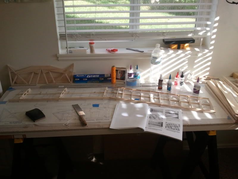

Wow.  It's been a while since I've updated this.
I HAVE made progress...just slow-going with other projects and other aspects of R/C (cars, helis).

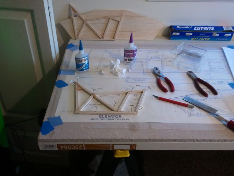

Here are some pics:
I've finished the rough frame up of the wings, but will wait for hinging, filling, and sanding until everything else is framed up.
I've also started the fuselage.  I built my first CG Ultimate when I was 15, now almost 20 years later, I find myself wondering just how shoddy my workmanship was as it seems I am making a lot of errors even now...when taking MORE time.  Nothing major, just flaws in sheeting fitment and stuff like that.

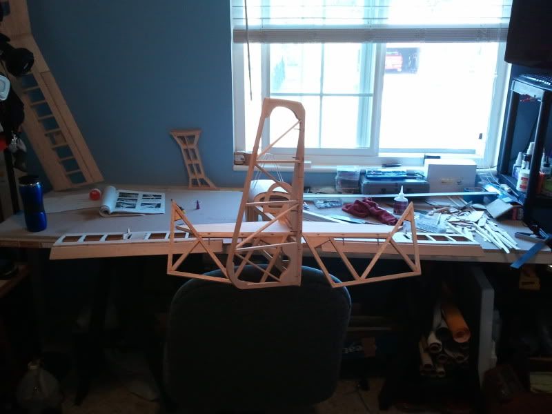

Pics are slightly out of order...sorry.

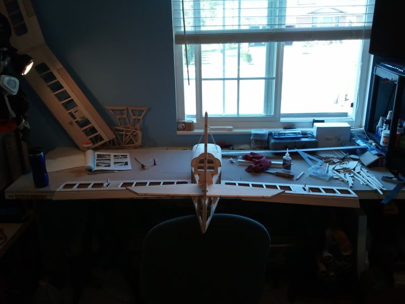

Got some work done on the fuse tonight. It's coming out really nice.

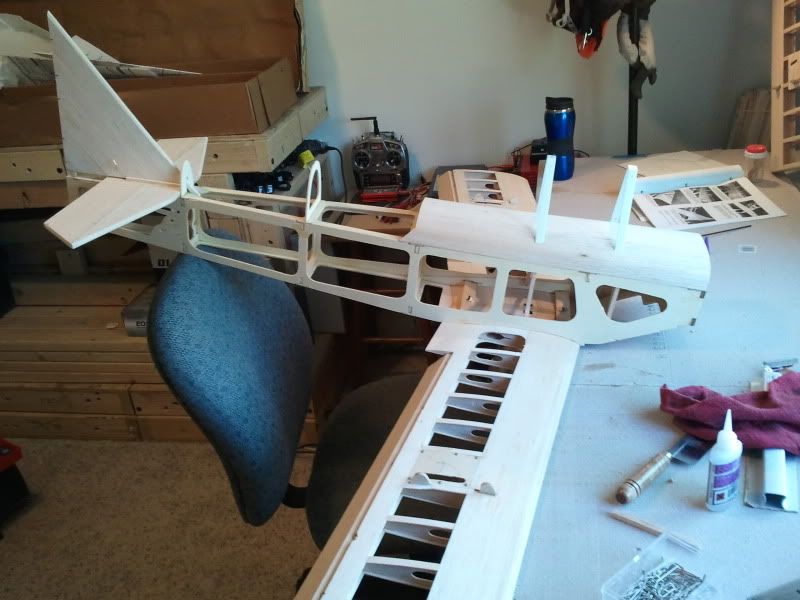

Yup, had the turtle deck all rolled up...it's ready to go...which is good because I'm almost to that step!
Installed the tail feathers. I had a warp in the tail of the fuselage (despite checking it over before gluing per the instructions) so I installed the bottom wing to assure proper alignment. The tail is nice and square with itself and with the bottom wing.
I also hinged all the surfaces. I think the tail will have plenty of authority. I double beveled the elevator, and made sure to give the rudder a high angle bevel. I'll also run a bit of a gap (properly sealed of course) on the rudder as well as inset the hinges to assure nearly 80 degrees of throw...I want to make sure clearance with the elevator is the limiting factor and NOT hinge binding.
I couldn't resist setting the top wing in place for a pic.
