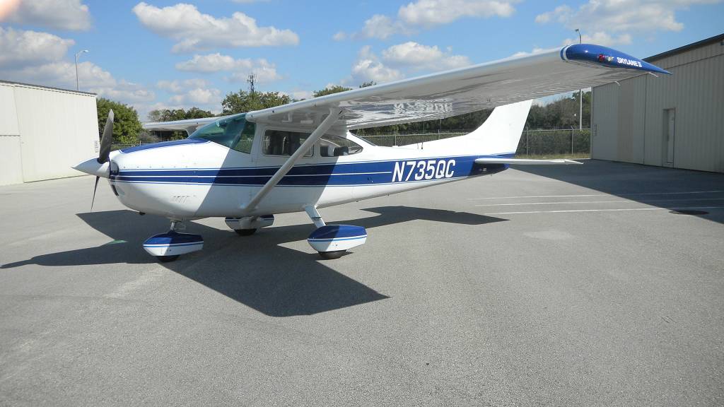

I have been following with interest the various threads concerning this kit for some time now. This is the TopFliteCessna 182 kit that I bought second hand from someone a while ago. It wasat 80%complete when he had to move and couldn't finnish it. It has been sitting in my hanger,untouchedfor some time now due to other projects.I finaly came around to start work on it and finishing it.

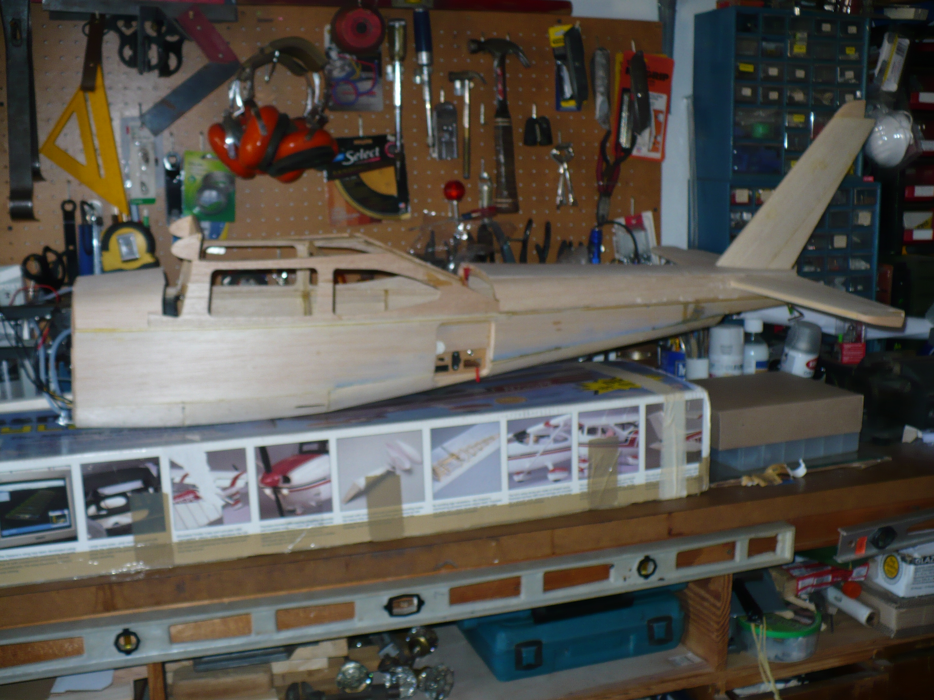

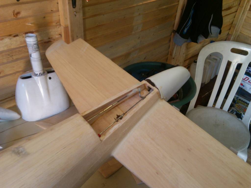

So here is the Cessna building. I want to change the location of the servo bay to make for easy access due to the scaleinterierthat I will be installing since I got it with the plane. I cut I opening in the bottom of the front part of fusalage wich will become a opening hatch.Next is to cut out the existing servo tray (wich was installed according to plans and instructions) and reglue it in where I want it. I will reinforce the place where it was cut out with a thinstrip of strongplywood that will sit justunderneeth the dashboard.This way I can make the interier more scale lookingwith the rudder peddal location. I also cut open the back part of tail sectionto make a hatch for access to the control linkages for adjustments if needed. The instructionssaid for it to be glued closed, which is what the previous owner did.This way,if I need to change a servo or adjust a linkage, I can do it at anytime and atthe airfield, if needed,withouttakingout the entire interier and risk it getting damaged. I will post more pics and information as Igo along...

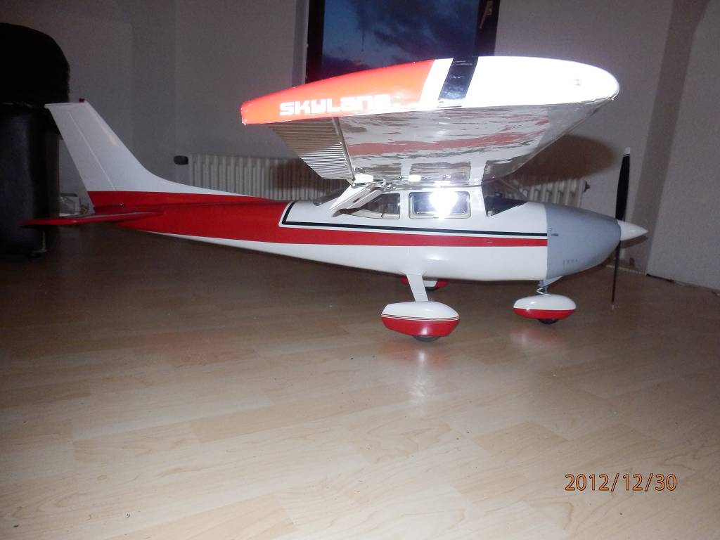

Hey Etienne 1,
how about your building progress ?
My Cessna has turned into a scratch-build rivet-patchwork with 70's style..

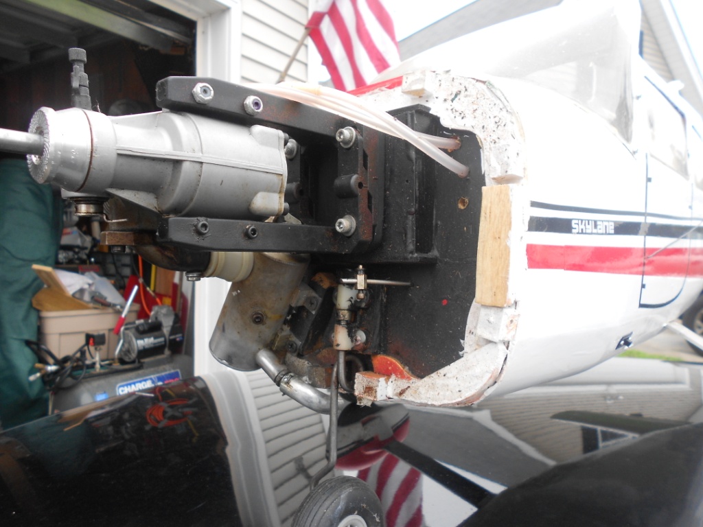

How is your building progress ? I have my 182 under way and have been modifying the fuel tank area I don't like the tank in a side saddle position we do a ;lot of slow left banks due to prevailing winds at the local field. I am using four 4 oz. tanks in series facing forward to hold my glow fuel. 2 slat and 2 square style flex tanks. I will post a picture when I get the plumbing done. Power is a Super Tigre .75 with the TF in cowl muffler and adapter. It took some time but I found aguy in Korea who had the TOPQ7925 ST header and the TOPQ7916 Muffler mentioned in the plans. He also had the Top Flite TOPQ5405 Red Cessna spinner the exact same spinner in White made for the Great Planes LearJet. Sometimes it's better to be lucky than smart!
Here a re a couple of photos of the paint scheme I am planning to use. I had 2 sons in CAP.

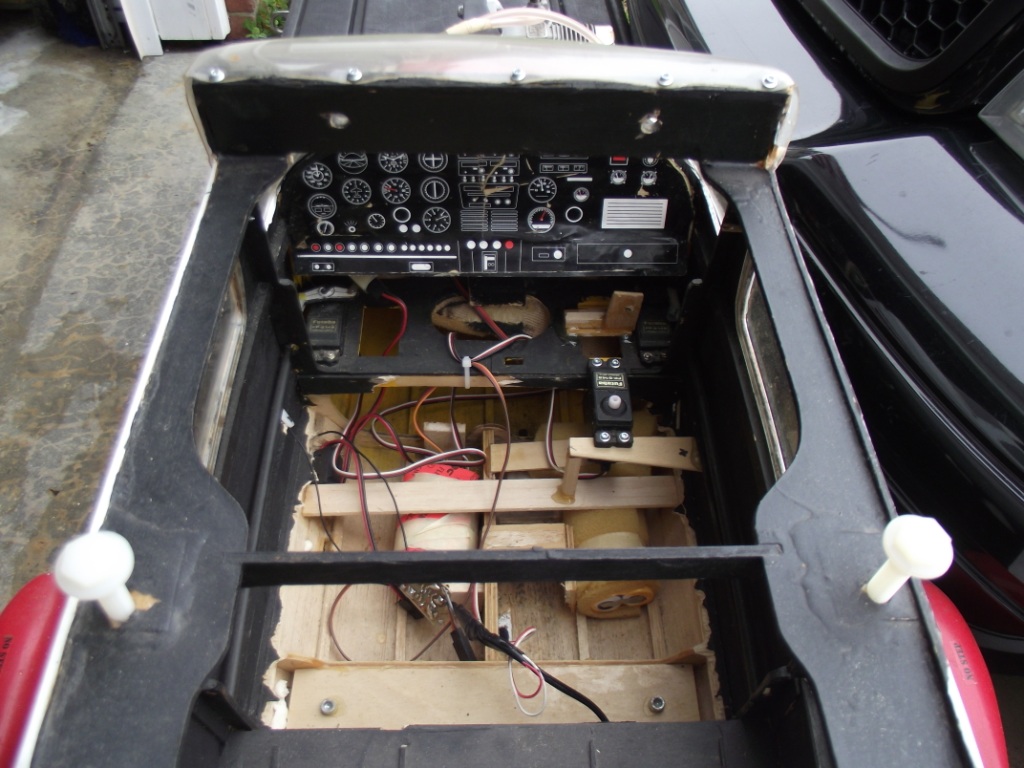

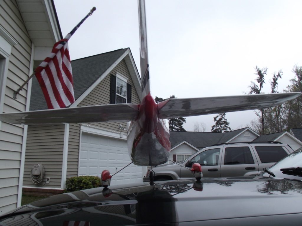

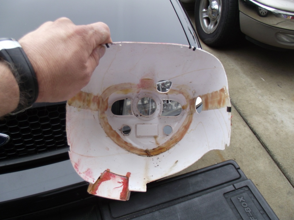

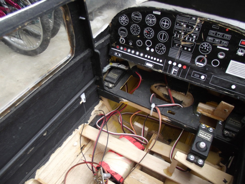

Here are a few pics of the plane. As you can tell it appears to have once had a cockpit kit in it but it was ripped out. Also one of the previous owners made some servo mount mods. Thanks again for any info!

If its not a Top Flite Cessna 182 it is the finest knock off of one I have ever seen. Everything I am looking at matches the one TF 182 I am working on. Too bad he didn't buy the correct muffler so he could hide it under the cowling completely like it is suppose to be. What size engine does she have? I'm using a Super Tigre .75 myself. I also have a full set of lights and a Robart strut.
You can download the manual from Top Flite's website for free and determine if you want to convert it to having flaps. Top Flite will sell you the plans part # CES6P01R ROLLED FUSELAGE & WING PLAN $33.81.

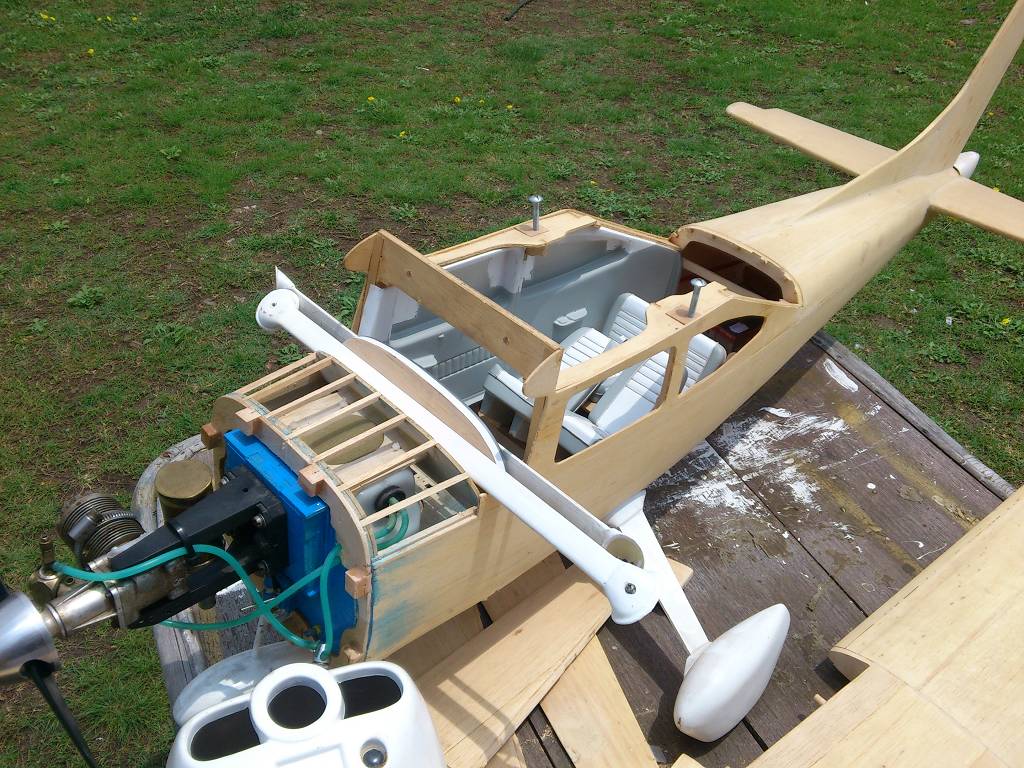

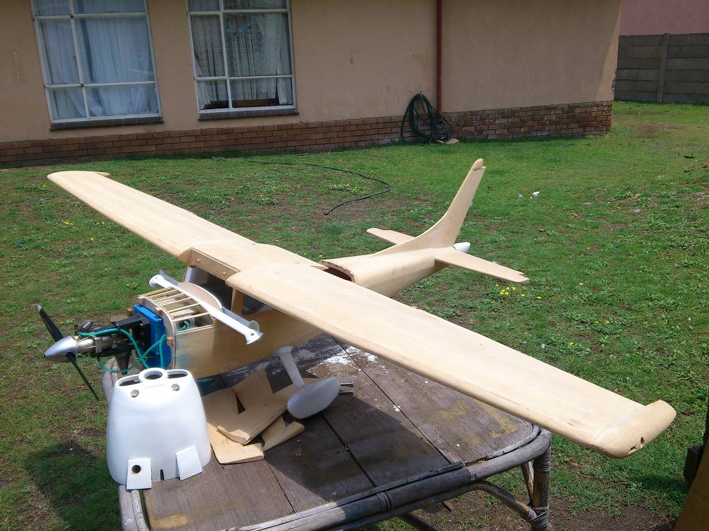

I havn't posted in such a long time... And I havn't been working on the cessna. but, Lately I have been working alot on the cessna and done a couple of things...

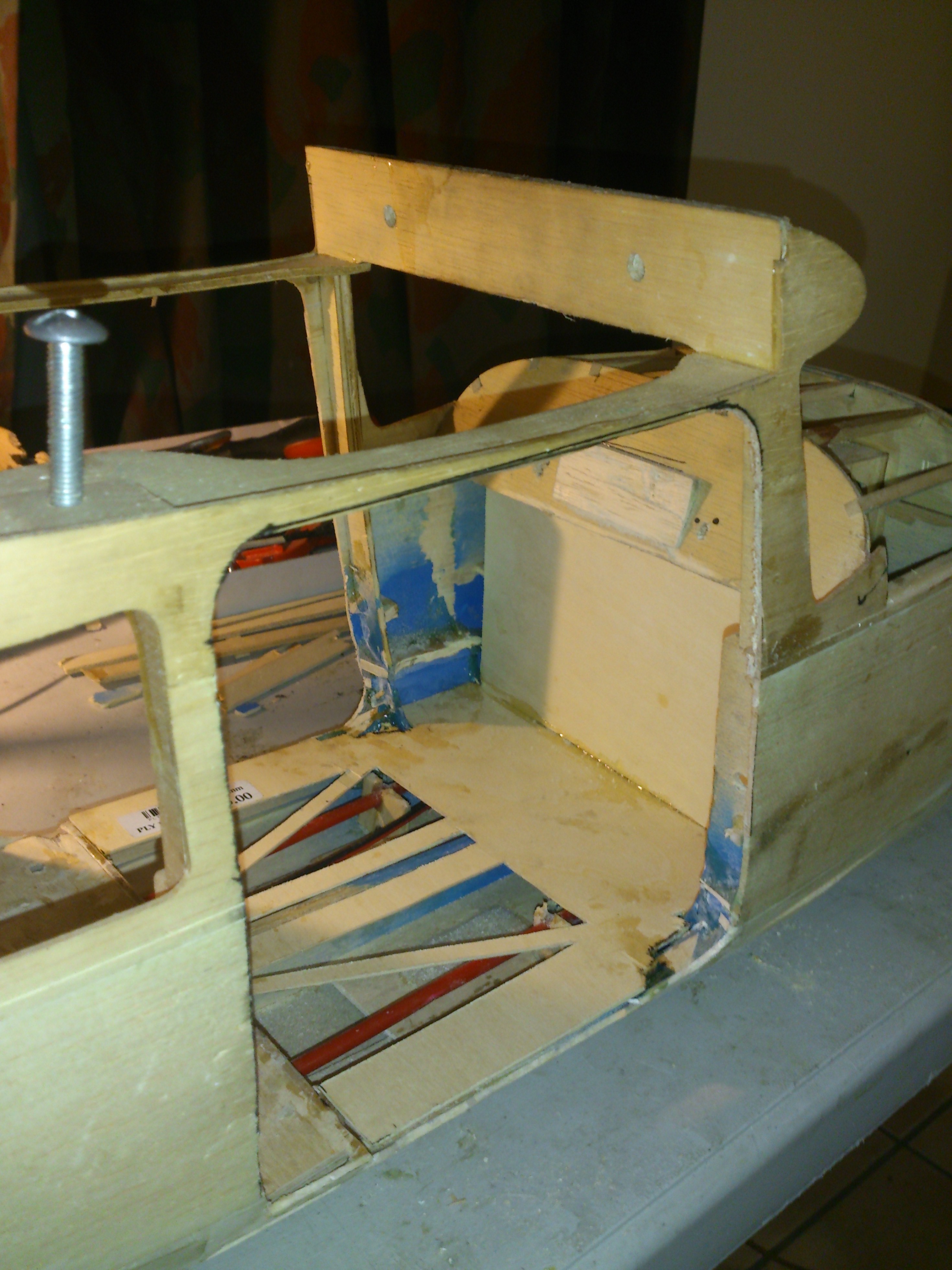

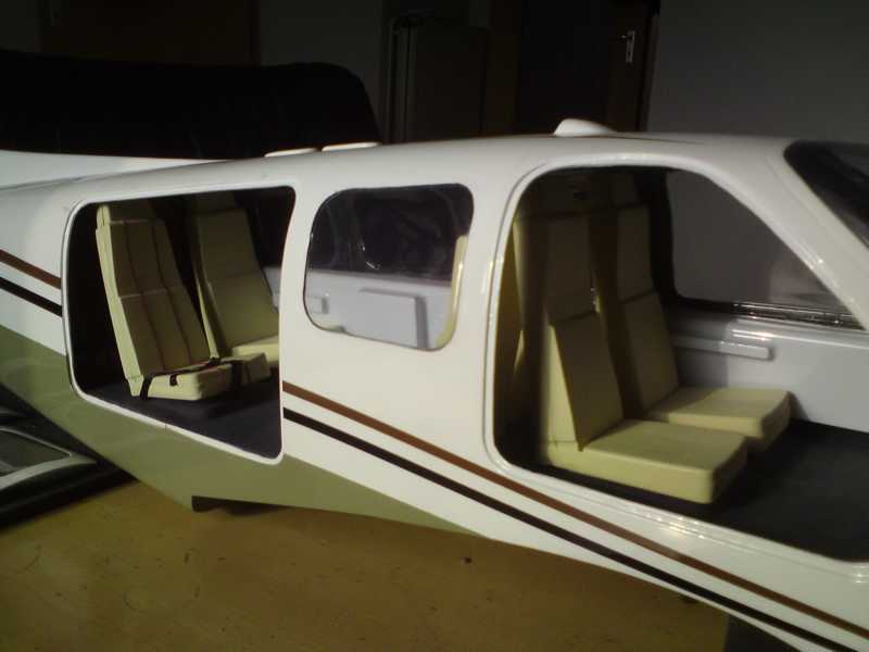

First : I decidedd to make it a clipped wing, to make trasport easier...
Seccondly : I have decided to make doors that can open....
Third : I have modyfied the interior a little at the front, to make it more realistic...
I will post pics for what I have done so far...

Ok, So there is the doors, and the bagage door...

Yes, those are big doors, but they are correct size for scale... I had to drop the floor alot, but worth it in the end... The bagage door is a little smaller than scale though.
Having functional doors and / or bagage door is just adding to the detail and makes the model just a little better and makes it stand out...
I am struggling to upload the foto's for the clipped wing modification, but I will try again next week...

I know it's been a Looooooong time. 5 years. I know. But building on the Cessna was SLOW, very very slow.
I had troubles back in 2014 to upload photo's as I said in my last post back then. And then my phone got damaged, I lost a lot of my photo's of the build process. Specifically the Fibre-Glassing parts.
But, as my previous post stated. I somehow managed to do my glassing wrong ? I think ? It came out very uneven, Especially the main wings.
Felt like corrugated roof surface or something. I don't know....
And because of this. I struggled to get it correct. Flling - Sanding, Filling - Sanding, stop for a year. Try again. Filling - sanding, Filling - sanding, Stop for more than a year. And so on it went.
Every time I work on it, I am very enthusiastic to complete my model. But, struggle for a few weeks, Then Give up out of frustration.
I got very de motivated every time I struggle for a few weeks and don't seem to get anywhere, to a point that I stopped for 2 years, didn't even fly anything.
But, Starting up again in July 2019, working on the Cessna almost every day. I am getting somewhere. I still feel like giving up again a few times now, But, I must finish it,
And perseverance pays off.
And, after a few weeks, I got the Fuse finally completely filled and sanded down to a Silky smooth as a baby's bottom finish,
Perfectly smooth Ready for Detailing.
But, the Main wings are still a headache. Struggling still. Working on it everyday, even if it's just an hour or so. And the wings are almost there.
Maybe by weekends time the wings will be finished. I hope. But, from watching "Draco" on Youtube, something Mike said while he was doing the Wing tip tank mod.
Put filler on one part, and while that part is drying, work on the next part, while that one is drying, work on the next part, And then when last part starts to dry, Go back and start sanding the first part.
That way, you never have to wait for something to dry and do nothing. So I'm working on the landing gear, the cowling, the control surfaces, almost every part same time.
Anyway, My plans are to be finished with the entire model mid September. as I am planning to attend a scale meetup 3rd week of September.
I'm going to try to upload pics, so hopefully this works. I'll up load some pics from back in 2014 building process, Pics I promised in my previous post, the few that I had saved.
Basically, You'll see that I have cut the wings again. Back into 3 pieces. For easy transport. And The center section was Glued into place on the Fuse.
But now, as my building started up again, I haven't taken any new pics from my building progress, I'm just working non stop on the airplane.
But, I'll remember to take some pics of the Fuse and stuff tomorrow and upload them.
The Last pic is where I stopped working on it in 2014,
Fibre-Glassed and painted Primer.
So, That was back in 2014.
Now this is 2019.
The Fuse, when it was Almost done, And the Cowl adding scale vents.
From now on, I'll definitely give regular updates as I progress and I'll upload more pics as the build continues.
