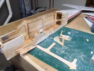

Here are the before and after pics:
Silly instructor let the beginner get too low! Consensus at the field was that it was destined for the trash can.
12 hrs on the bench, and ready to go again, with time to spare, for the very next scheduled beginner training day.
Kept the cowl. Not visible in the pic, but it still has evident crash damaged. Added CA to all the fiberglass that needed it. Some body filler and paint over the winter will make it like new. No need to duplicate the balsa nose found in the kit.
Interior fuse sides were ply, which was poorly glued to the outer skins (easy to seperate them!). Ply pieces all jigsawed right back together, then easy to add new balsa sides. Needed a new nose gear steering arm.
A couple of holes in the wing, which just needed patching - nothing structural. One wing bolt area had to be repaired.
Maybe I'll buy a new decal set to add the windows back in....
Running a NIB old HB .40 with an 11x5 prop. Time got away, and the first flight after repair lasted 38 min. on an 8 oz tank (1/2 throttle). That beginner was tired after we landed!

True that. I've had a few planes over the decades that went into trash bags right away. After letting them age for a prolonged time in a corner of the workshop, I'd open the bag and say "Hmmm....maybe I can do something...."
The only bad part about the rebuild - I glued it back together with good glue practices....so it won't separate into its components near as well as it did this time.....

My rebuilds had a tendency to put a little weight on from the original build too.

My LT-40 met similar fate on it's third flight. Snapped the fuse in half and damaged the LE of the wing. That was 8 years ago, still flying.

"We vow to never trash an LT40carcase". they are always rebuildable. When I was learning to fly my Trainer was a bit rough on the sticks and ditched the LT-40 that I was learning with. Broke the Fuse at the TE of the wing saddle and broke the wing on the rt side of the dihedral splice. The next Saturday we resumed flying with the same LT-40.. Great trainer!
