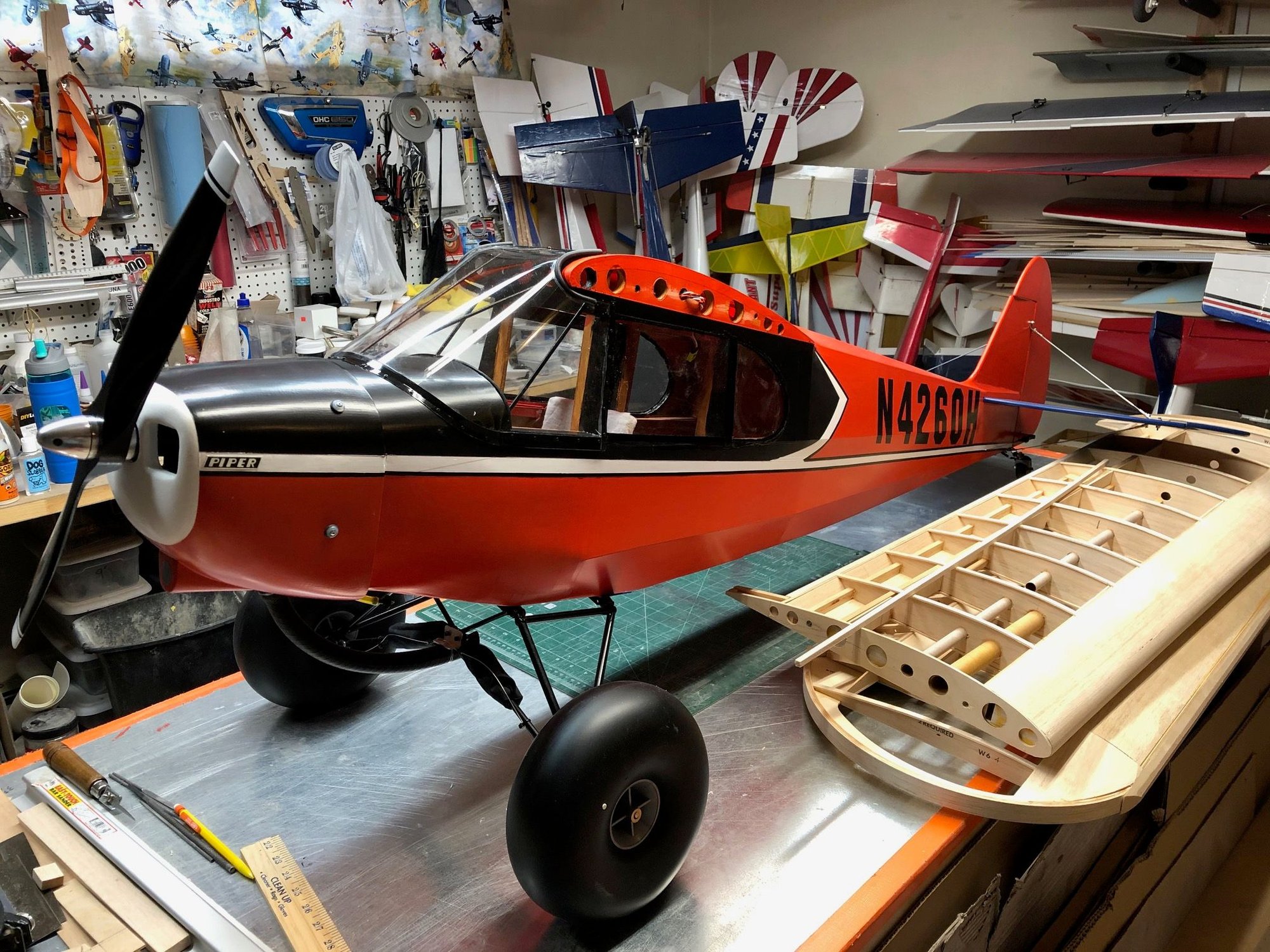

I can't believe the time has gotten away from me, or maybe I can. I'm back on this project at last. The fuselage is all done, just finishing up the windshield installation. Next up is finalizing the aileron and lfap hinging and final shaping. Pictures to follow...

The windshield turned out to be the trickiest bit of the whole build, but it'll have to do. The fuselage is now completely done. Now I just need to finish up the wings and build the struts.

I agree. The hardest part to any cub or cub-like build is the windscreen. Looks good!
