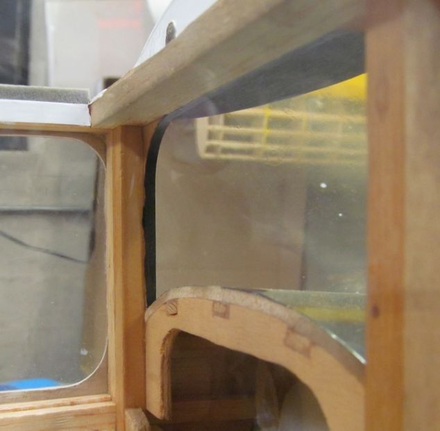

Originally Posted by Carlos G View Post
Here are the last two Pics of the fuselage...
Top of cabin where wing plugs in
Side view looking into cabin showing 1/8 th" birch ply wing leading edge hold down, it is the black painted vertical bit in front of the spruce and balsa vertical front cabin brace. It goes up and over across the top of the fuselage and down to the other cabin brace. The wing leading edge butts up against it where the wing leading edge hold down dowels plug into. The actual ply piece looks a bit like an inverted " U".
Hope this helps out
Carlos G
I like this, nice and clean. Did you use the stock leading edge?

Hi Bodybuildr,
Yes I did use the stock leading edge. I also added an 1/8 th inch ply doubler behind the wing leading edge and another to the center section spar area to help take the flight stresses imposed on the dowels that hold the wing into place. Please realize that I built this model almost twenty years ago now and my memory of its construction is a little hazy now. I still have the plane and fly it occasionally just to smell the Nitro fumes, LOL.
